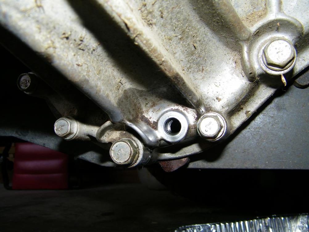

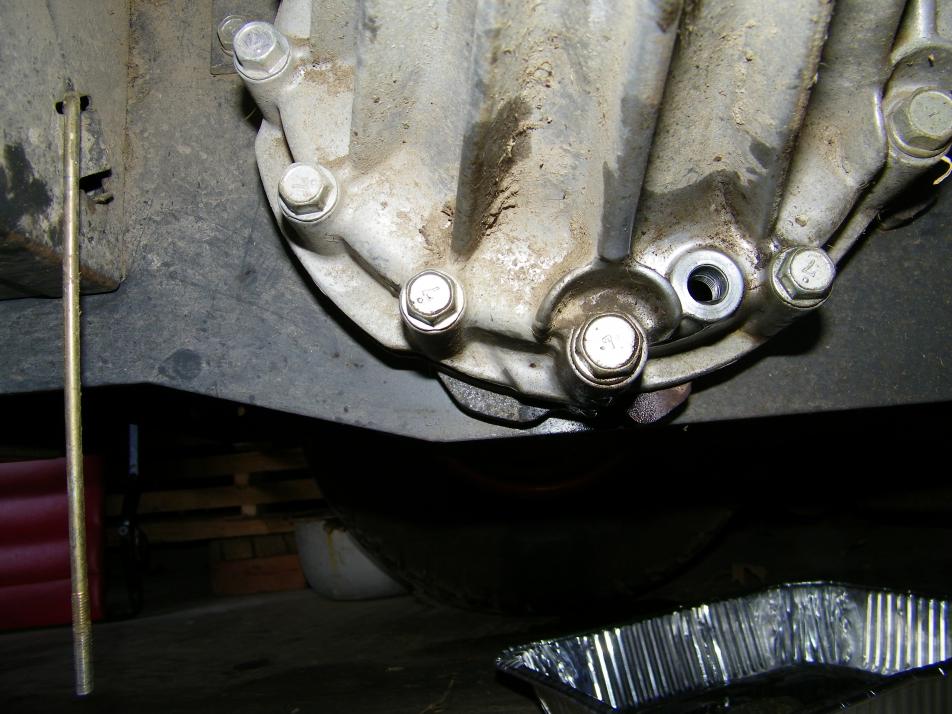

I have stripped the threads on the rear axle housing transmission drain plug and hole on my ZD326. I can see in the hole that there appear to be good threads beyond the stripped portion in the hole. My plan is to install a longer bolt in place of the stripped plug, but the bolt I tried to install will not screw beyond the damaged portion of the hole. The bolt I am trying to install has 12mm x 1.25 threads. I am not positive that they are the correct threads. Before I try to clear the threads with a tap, I need to confirm what the existing threads are.
Can anyone tell me what those threads are?

Pictures of the hole are in my first post.
When I said I found the flange bolt and seal washer, I meant I found them in the parts diagrams at the site provided by NIW, but I could not find the thread information that he said was listed. I don't know how he found the BSPP info.
The threads are stripped nearly clean in the outer portion of the hole where the bolt was engaged, but beyond that there are good threads remaining.
If I can get a positive ID on the threads, I can buy a tap to chase what is remaining and then install a seal washer and bolt longer than the original to reach the good threads.

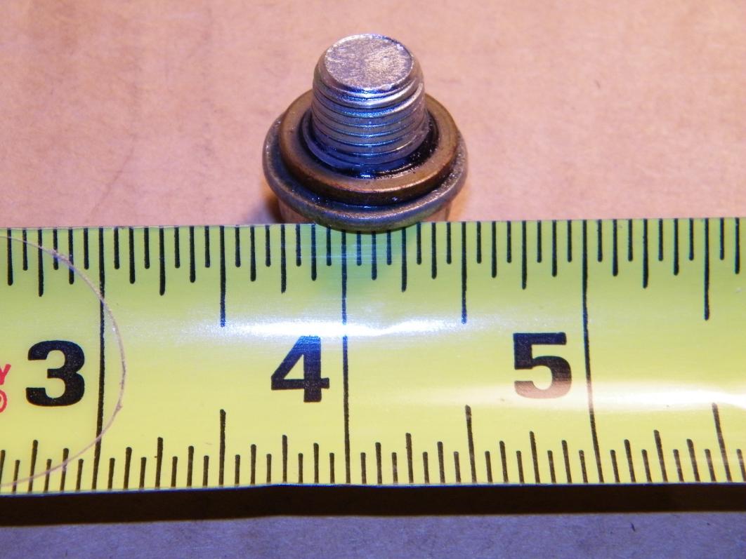

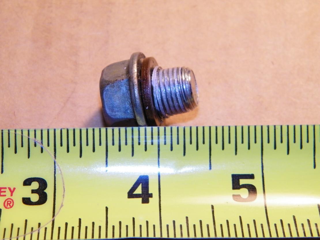

Thanks again for all the replies and suggestions.
I have attached a couple pictures of the plug as requested. The threaded portion of the bolt beyond the washer is only about 3/8".
From what I'm hearing from you, finding out what the original threads were won't lead to the best solution because of the minimal good threads left in the hole.
Drilling the hole larger seems to be the best option. Since a helicoil requires drilling and tapping, it seems to me the best option is to drill and tap for a new bolt or fitting.
I like the idea of the NPT option, but right now the hole is larger than 7/16". It measures about .455 - .461" now where the threads are gone so I would have to go to a 3/8" NPT which requires a 37/64" hole (.578125"), not much larger than what I have.
Keeping chips out of the transmission will be a challenge, but I can flush it with hydraulic fluid before I seal it up. I might consider putting a piece of cloth in the hole prior to drilling. With a hole this large, I should be able to fish it out after the tapping.
