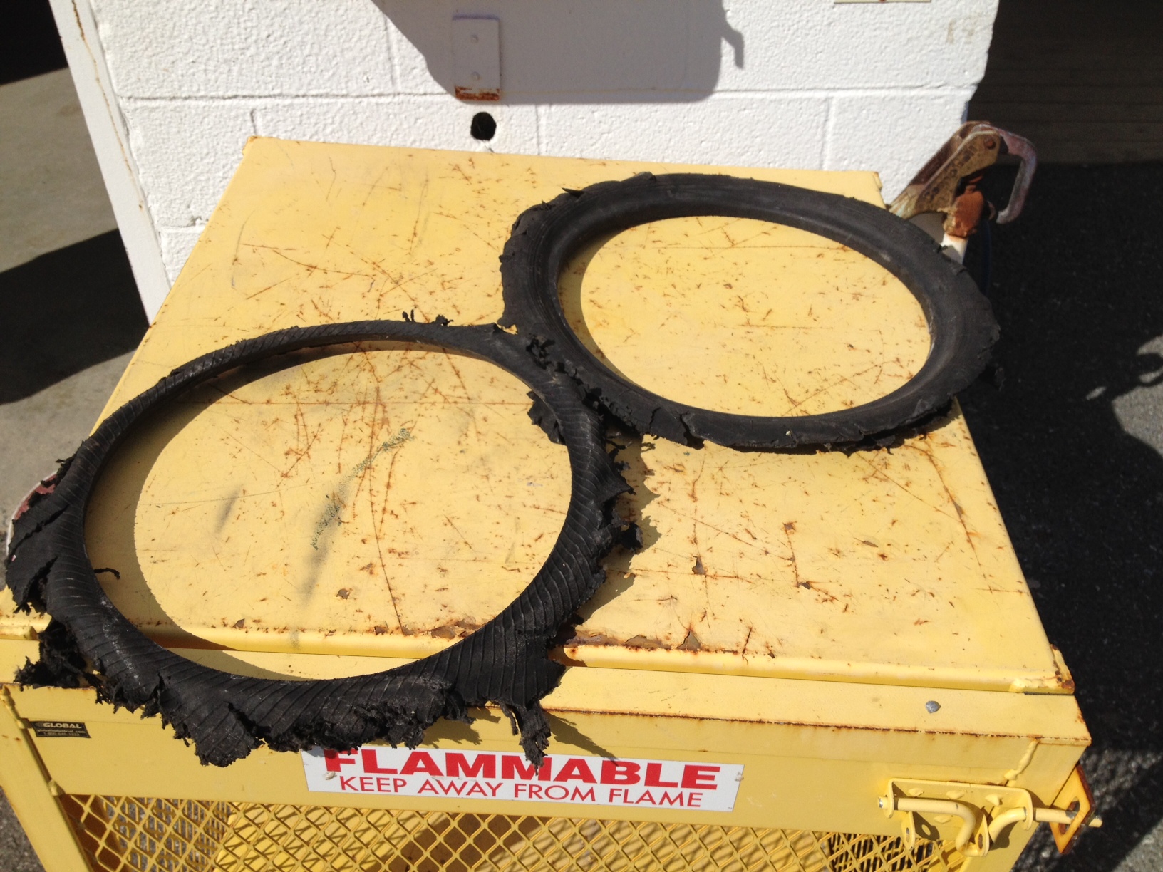

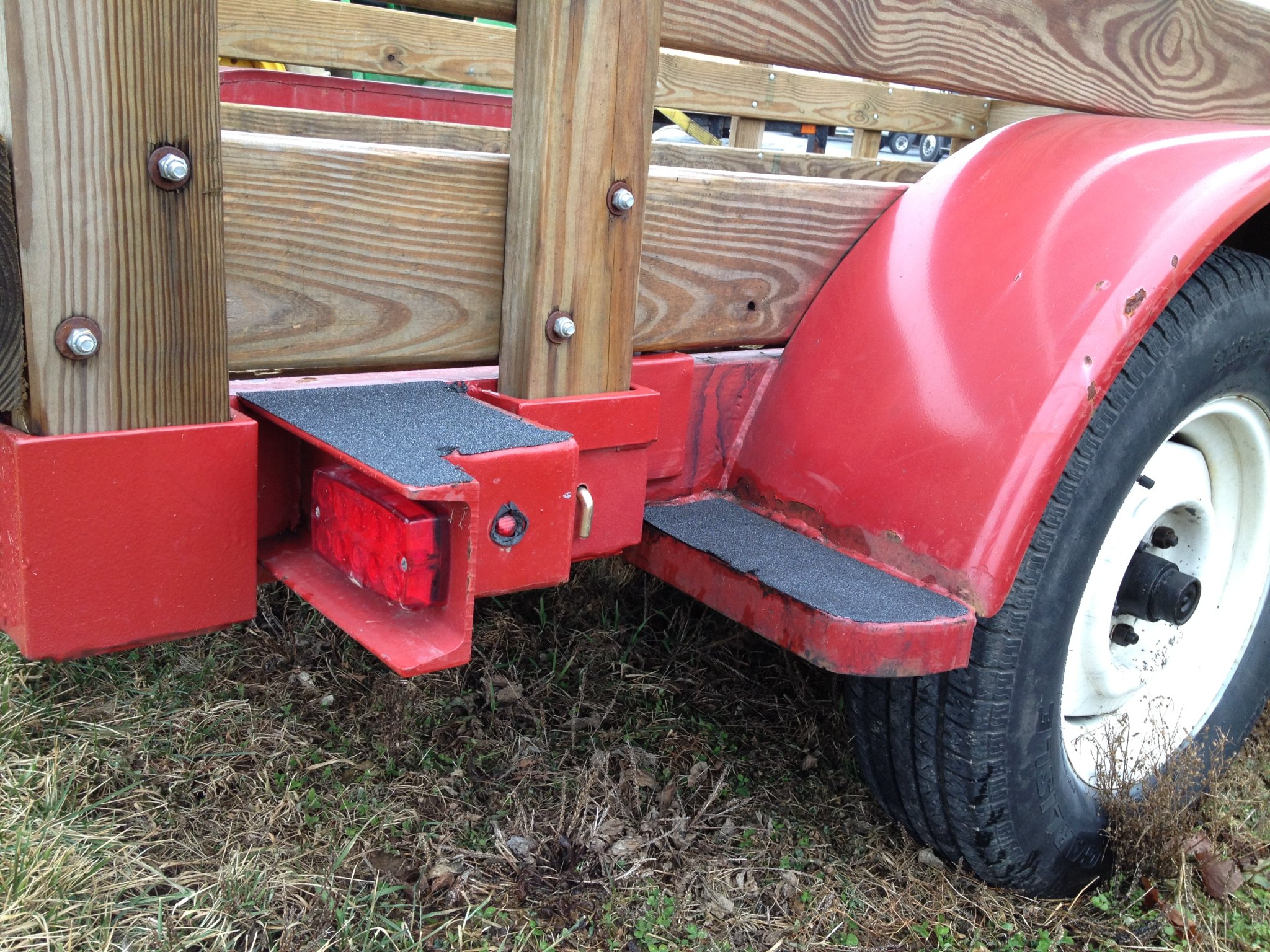

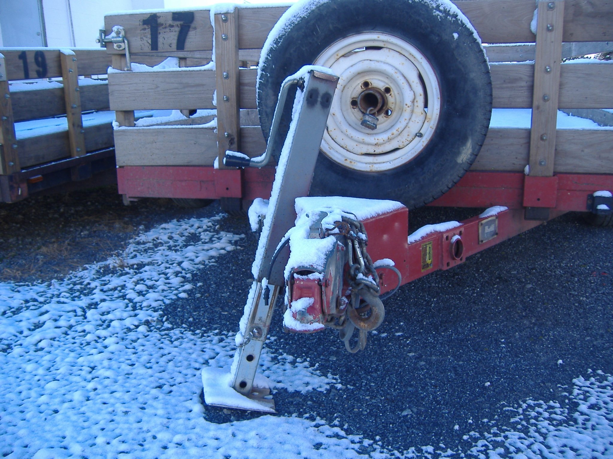

I'm familiar with that stuff, Paul. The last 10 or so at work, vehicles and trailers were part of my responsibilities. We had over 20 utility trailers that ranged from smaller ones in the pics below to some much more substantial ones. Depending upon the weight rating and vintage they had no brakes, surge brakes or electric brakes. We also had several deckovers, a dump trailer and a fifth wheel.
Jacks often fell victim to drivers who somehow forgot to flip them up. Fenders were ripped off. Lighting frequently took hits. We had one guy who managed to catch the trailer cord under the jack, then cranked the jack and tore the cord off. We started using coiled harness tails and safety cable to make them almost impossible for the jack to step on and for the chains to drag on the road. The two black rings are all that's left of a tire from someone running a flat.

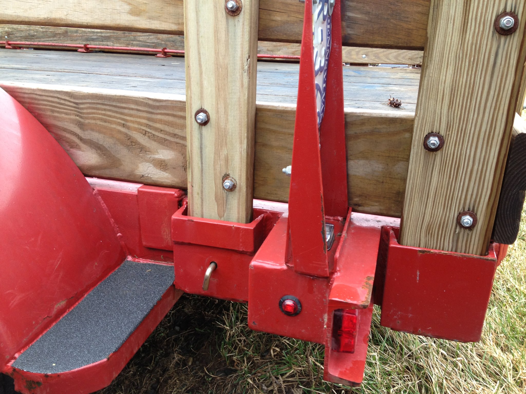

I came up with the armor for the lights and fender bottoms and it really cut down on the repairs. Many things that would have damaged our trailers got themselves broken instead. A bit of skateboard tape made them handy steps. Going to all LED lights and paying more attention to splices and wiring routing helped too.

@chim : That's exactly the same sort of box I build around the tail lights on this trailer. Apparently they managed to back into something just right to smash the lights. :rolleyes:
