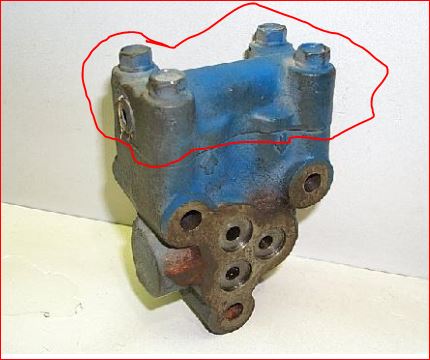

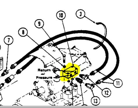

Here is a better picture of the part that you remove and replace.
Thanks again NIW...... I bought the block. It was in stock and only $100. Now I know where the lines are going to go, I'll have to figure out where to put these controls. I'm right handed so with the 3pt control and draft control already in the best spot, I was thinking about making a two tiered pedestal with 2" box stock welded right on top of the rear FEL frame. Or maybe get a valve with a joystick and a set of levers at 90 degrees to the joystick.

If you go with a new valve you'll also need a third line for return / tank that will go strait to the sump (Rear end, Transmission).
I'll dig a little and see if I can find the best place to send this. ;)
