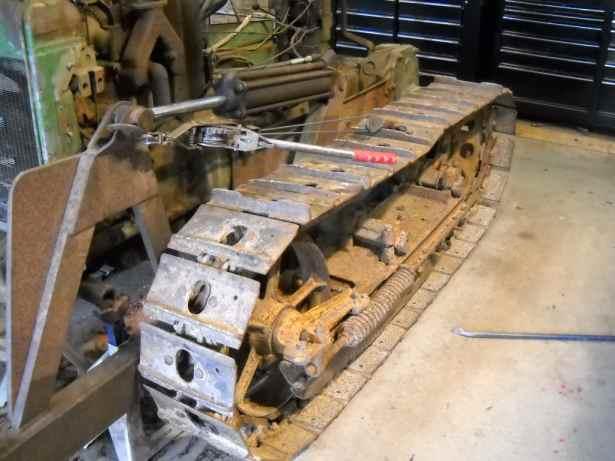

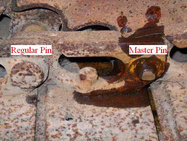

Do tracks have a "master link" or can they all be driven out?

First image is using a comealong to pull the track around to a convenient spot to press out the master pin.
Second is a shot of the master pin.
Gotta make up a rig to use a bottle jack to press the pins out. Good project for tomorrow.

Redesigned one half of my pin pressing jig to be more rigid plus pulled my head out of my...uh...back pocket and heated the HEAD of the pin where it keys into the link. Still took a couple of hours of jacking, whacking and heating but I got them both out and the tracks off.

Your master pin press was just what I was going to suggest, except a lot heavier. We had one years ago for pressing master pins out of tracks on International TD-18s, a TD-20 and a TD24. We used a piece of 3" square bar with a hole for the pin to pass on the inside and another 3" bar on the outside. Both were drilled for 1" threaded rod and we had a 20 ton porta-power to press them out. Even with the porta-power we almost always had to apply a lot of heat to the pin bosses to get them out.
