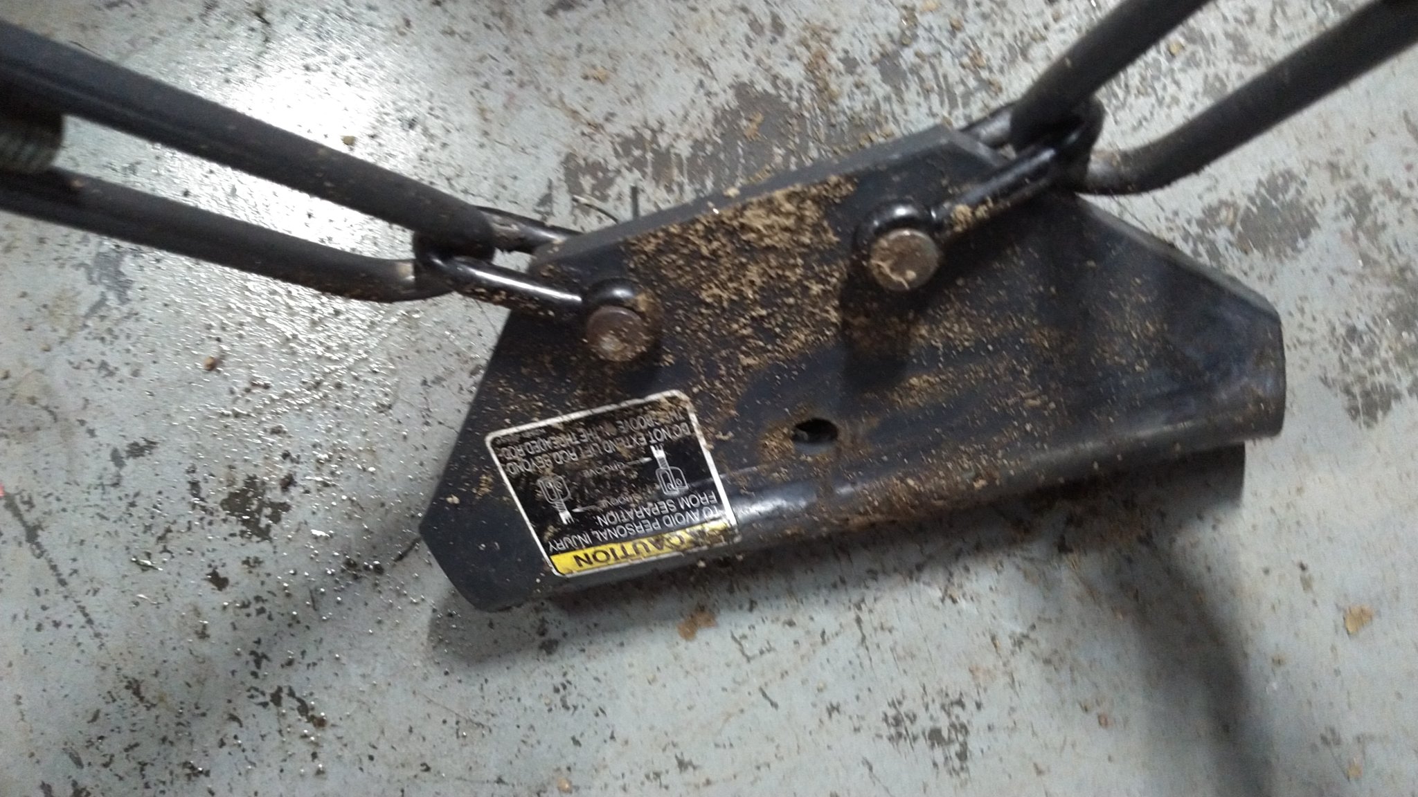

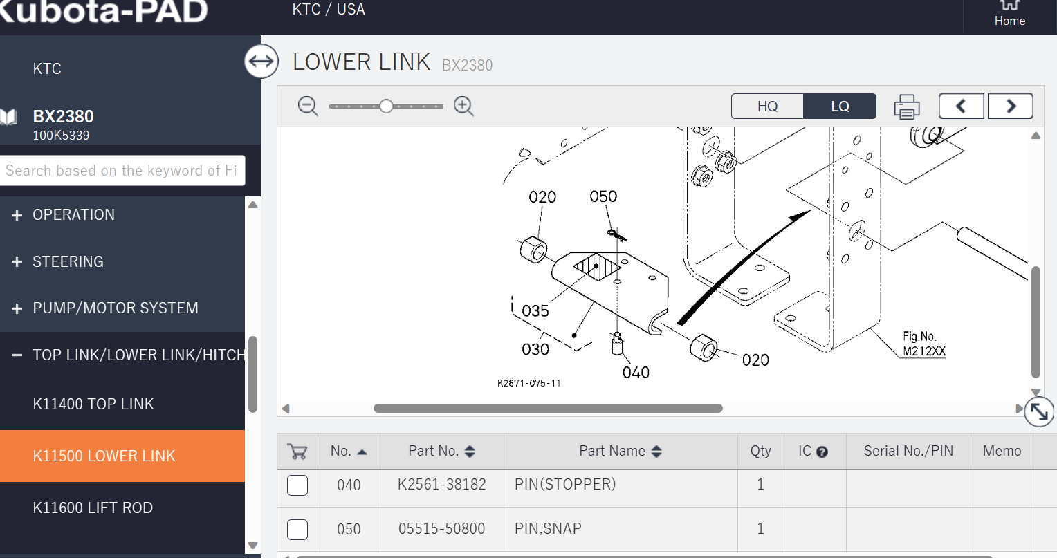

The one that fits in the center of this plate. Mine snapped, is lost and the plate keeps falling off. In watching the Messicks video it looks to be a funky two diameter pin. Can someone snap a picture of theirs for me?
I called the dealer and they were too busy to deal with this little guy. Will any old pin that fits do the trick for now? Thanks.

A 1/4" x 1" any grade bolt will work with a nylock nut will work. Less than buying the correct Kubota part with the retainer clip. I have been using this method for more than 2 decades, and if I misplace it, I always have a spare available in my nut and bolt cabinet. I buy them at Tractor Supply

Thanks, I did find another pin to drop in there temporarily that seems to fit nice, wife was able to till the whole garden with no more mishaps. I measured mine at 3/8's. I guess based on the diagram and functionality there just needs to be a pin there to stop the plate from working off the cross bar.
