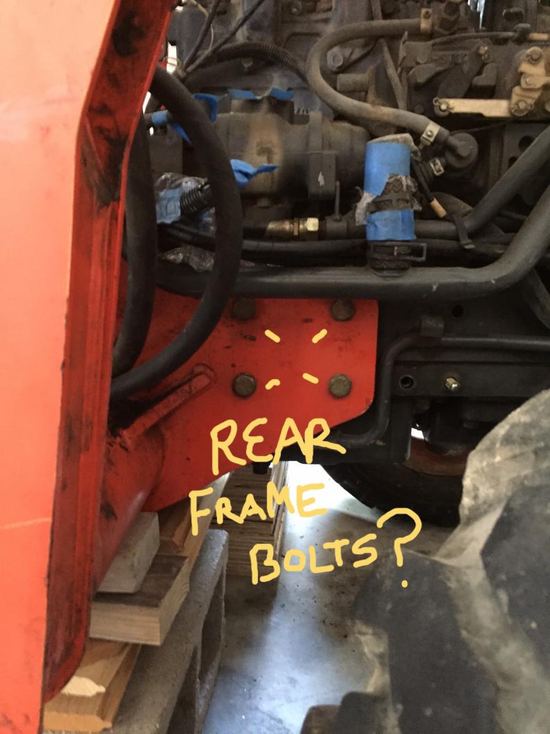

Ok, I'm at the point of pulling the engine. All jack stands, floor jacks, cribbing, etc are in place. Unfortunately the shop manual, for a novice like me, is a little vague on exactly which bolts I need to back out in order to free the engine. Here is what my shop manual says...
When it comes to the front axle (I am stuck at this step) I am trying to figure out exactly which screws/bolts step 2 and 3 are talking about. See pictures.
Front axle frame:
1. Place disassembly stand under the front bumper and hoist the engine.
2. Remove the front axle frame mounting screws and nuts
3. Remove the reamer stud bolts
4. Separate the front axle frame from engine
Separating Engine
1. Place disassembly stands under the clutch housing and hoist the engine.
2. Remove the engine mounting screws and nuts
3. Separate the engine from clutch housing
Picture 3593:
This is a 'passenger side' picture of the tractor
#1 is a screw that is holding a hose guide of some kind. I don't know if this screw also goes into the engine or not. Can anyone speak to this? Should it be removed?
#2 - On both sides of the engine there are studs that stick out (I have removed the nuts and lock washers). I have felt on the back side to see if I can tap out the screw but it doesn't look that way. Does anyone know how to handle these studs sticking out and whether or not they even play a part in the front of the tractor mounting to the engine? If they don't, I can put the nuts/washers back on.
Picture 3584:
Are these the four bolts holding the rear of the tractor to the engine?
Picture 3595:
This is a picture from the 'driver side' of the tractor - you will see the same stud popping out as on the other side.
I appreciate anyone's help. I'm really close to pulling this engine...will be a huge milestone!
32,976
8,429
Yes the hose bracket bolt is a frame bolt too.
I'm pretty sure you will need to remove the loader mount in order to get to all the motor bolts, and yes the loader mount bolts probably do extend into the motor.

Hey guys, could use some more advice.
If you will notice the pictures of the frame bolts on this thread
- I have hoisted the engine
- Stud bolts are removed
- Front frame bolts are all removed
- Removed the rear frame bolts (the four bolts inside the orange paint)
- There were two bolts on the engine that looked like it was helping hold it against the clutch housing - I have removed those too
I cannot get the front of the tractor to separate from the engine. I have it supposed on a wheeled jack. I have disconnected everything that I know. I had multiple guys tugging on the front last night and it will not come free from the engine. Obviously I need to slide the front of the tractor free so I can then slide the engine forward off the clutch and then lift it out.
After removing the studs, the front remaining six bolts, the rear eight bolts (ones in orange), and two bolts on top of the clutch housing that looked like it was holding it to the engine block, I have done all I can see to do.
Any advice? Anyone know what I am missing?
