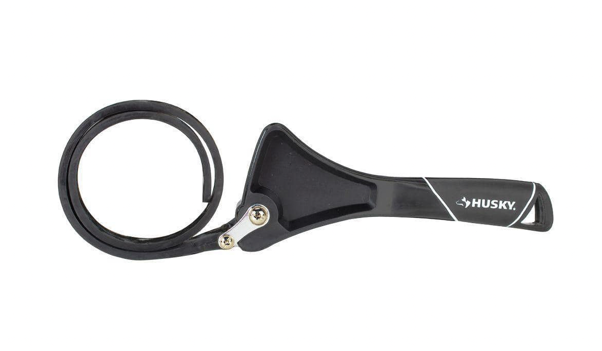

BTW my normal filter wrench with the metal band could not be put over the filter. I had to get a strap type from the garage and thread the strap around it. The guard near the filter is too close to the filter’s end to allow a normal band type filter wrench. I used this:
