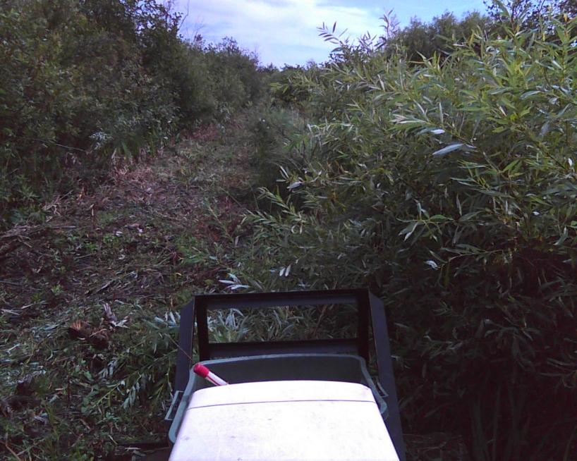

I thought I would toss this out there, before I sell this thing. I have a Case 444, which is a hydraulically driven 2wd garden tractor. There is a pump off the back of the engine that powers the back axle and a rear, hydraulic PTO to drive rear attachments, such as a rototiller, log splitter or brushcutter (Hydracutter). The pump produces about 2000 psi and a flow rate of 9 gallons per minute at 3600 RPM. That is divided up between powering the tractor and the rear attachments. I have a 4' brush cutter that is driven off of the rear hydraulic PTO. Since I purchased my B7100, I figured I would sell my Hydracutter and get a shaft driven brush cutter instead. But, this Hydracutter is a great implement, but I don't need 2 brush cutters.
I don't know much about the hydraulic capabilities of my gear driven B7100 (with B219 FEL), but I suspect the pressure and output is quite low. I just want to make sure that there really is no way to use my Hydracutter with my B7100? I just thought I would toss this out there for discussion...just in case there is a way to make this work, before I regret selling it.
