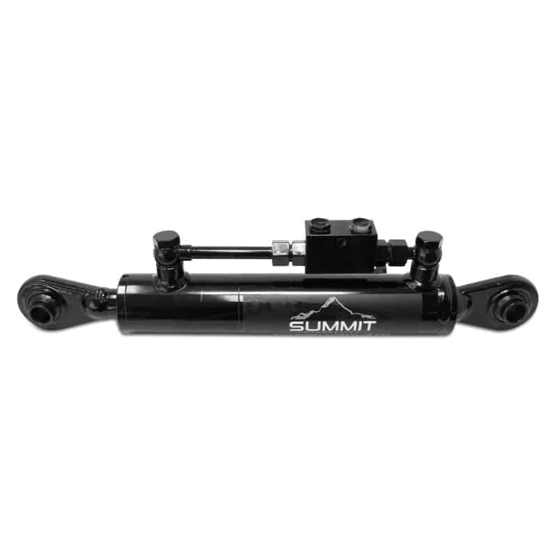

Drift is mainly a function of internal leakage in your control valves. Its been said the Kubota valves have more than normal.
The way to deal with that is pilot operated check vslves on the cylinders - frequently callec a "lock valve". Here is a top link with a check valve.

I think we have a little confusion here.
Short answer is I have used Summit products for quite a few years with no issues.
Now the longer answer.
You already have two OEM directional control valves (DCV) on your new tractor. Those DCVs will be used to control your TnT cylinders and are the concern when it comes to drift.
One way to prevent drift caused by leaking directional control valves is to install a double pilot operated check valve (DPOCV) on each cylinder. Thats whats pictured on the Summit top link I posted. DPOCV check valves are considered zero leakage devices and will hydraulically lock the cylinder. They have the side effect of preventing float operation of the cylinder.. Did you purchase OEM directional control valves with the float option?

As said, a double pilot operated check valve (DPOCV), will keep the cylinder from drifting. DPOCV locks the pressure down and needs a few hundred (??) pounds of pressure to release. Your valves, being installed by Kubota, are prone to leaks but that does not effect a cylinder with a double pilot operated check valve (circled in red below).

For your application, you will be better off getting cylinders with check valves similar to what is pictured.

Since you dont have float on your control valves a DPOCV will prevent cylinder drift. I opted to use Summit's DPOCV valves on the outlets rather than the cylinder. The plus there is it eliminates valve leakage and works on any cylinder connected to the outlets.

One thing not mentioned yet regarding the DPOCV, is that trying to buy the cylinders and the "cylinder mounted DPOCV" separately and doing it yourself, will/may turn out to be a complete nightmare, (and as pointed out early on, completely unnecessary)
So unless you are a "Hydraulics Guru" like @TheOldHokie , be sure to use a DPOCV in the lines (like he pictured).
