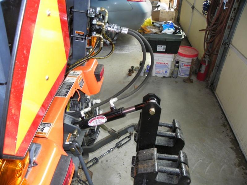

Looking to buy a hydraulic top link for my bx2200 and wanted to ask what size your using and how well it works. Will be using the 3pt with fork lift forks to move fire wood on pallets.
Is this othe one you got from Surplus Center?
1.5X4X1 DA HYD CYL SWIVEL EYES
ITEM NUMBER: 9-7258-4
SPECIFICATIONS
Double acting
Bore x stroke 1-1/2" x 4"
PSI max. 3,000
Rod dia. 1"
Ports SAE 6
Retracted length 11-1/4"
Shpg. 6 lbs.
END MOUNTINGS
Rod end swivel-ball
Ball width 1"
Ball O.D. 2"
Pin hole 0.75"
Base end swivel-ball
Ball width 1"
Ball O.D. 2"
Pin hole 0.75"
