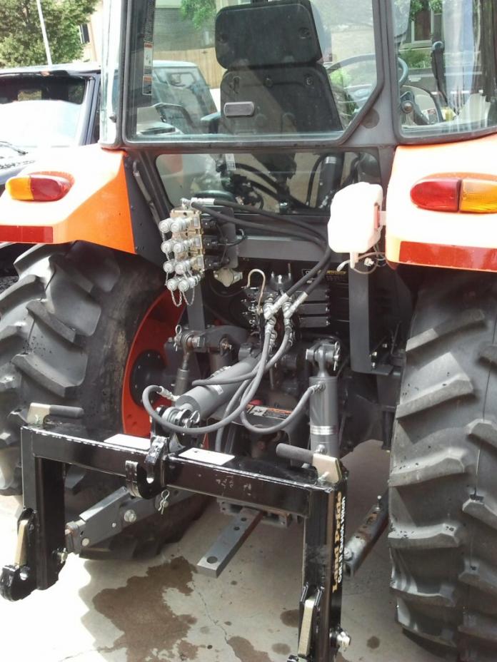

Lakeside Ca.
Dual remotes have (as far as I know) separate valves. A typical use would be a disk harrow with folding wings. One remote controls the wings, the other raises and lowers the disk.
Two remotes run off one valve could be done but I can't picture a use right off the top of my head.
Here is a picture of a single valve that operates 4 separate sets of rear remote outlets. To do this 3 electric diverters are used. This can be done with a single diverter to get a person 2 sets and as many diverters as required to get as many separate sets of outlets required. The most that I have ever come across is a total of 6 sets of outlets. This was on a Kubota M7040.
