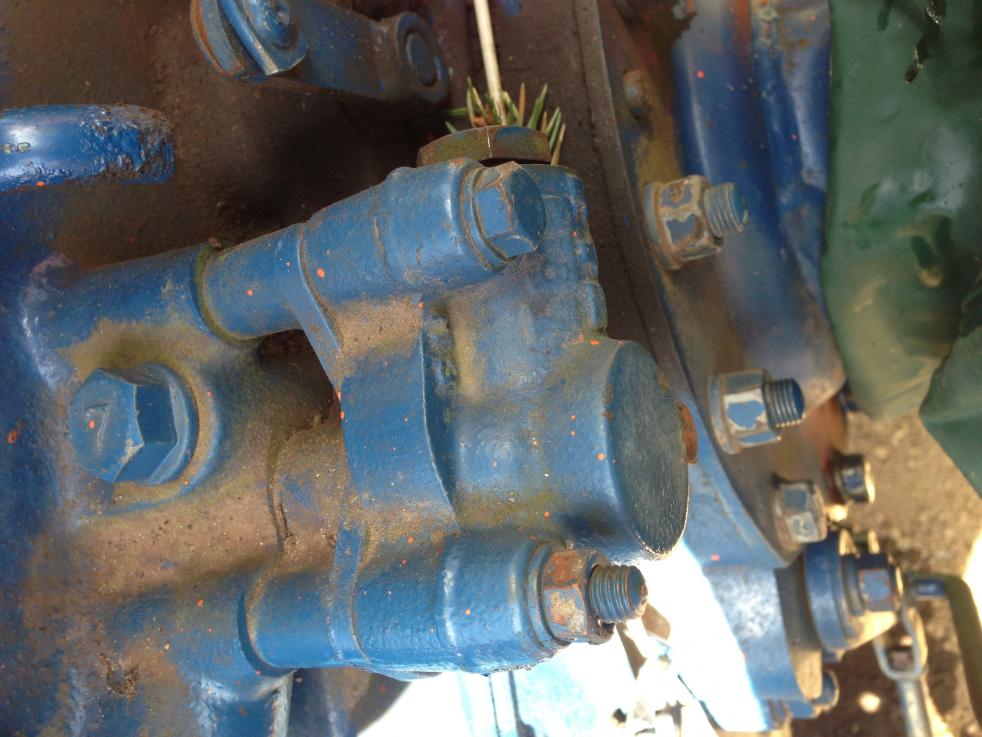

Pictures as follows of the block where, line diverts into loader valve. Is there any kind of bypass here?
Next picture is the loader valve I have. Pressure in and out are disconnected at this point. Return on right is where line broke. It has a relief valve at the in port
Final picture is on drivers side right below seat. Is this the main relief valve? This would not have anything to do with loader though right?

Hooked lines together, fired up and 3pt lifted me and my brother right up and just off idle, before it wouldn't even lift me. So it would seem the pump is fine. Looking like something in valve even though it doesn't make sense to me how it could be losing pressure in the valve body without fluid spraying out of it. Tomorrow going to hook valve back up to see if there are any changes, then I know someone with a similar tractor maybe I can borrow their valve to test.
