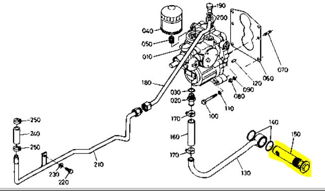

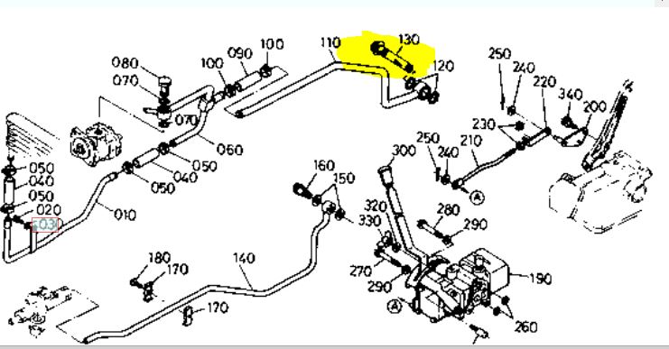

The filter on the top of the hydro is not the filter for they main hydraulic pump, that filter is for the hydro, it only gets fluid when you try to move the tractor.
Now the chances of the main pump just going out is highly unlikely.
You just need to make sure there are no suction leaks on the intake line (large line) to the pump, fill the tractor with hydraulic fluid, leave the output line (small line) just slightly loose, have a pan under it, and be prepared to shut it off quickly.
Report back after you do that.

Check all suction lines (one to the HST and one to the main hydraulic pump) for wetness, if any are wet it could have a suction leak.

Ok you don't need to focus on the main hydraulics then, as that part of the system is working.
Now all you need to focus on is the HST.
how long have you had it running with the HST pedal held down?
I have seen them take a couple min to kick in after a full fluid drain.
And like i said check the suction line of the HST for wet spots in the line or the rubber hose, it could be sucking air.
