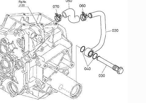

Check your fluid level. The filter is on the bottom, hope you didnt run into something and loose your fluid?
Check the suction pipe to pump. There is a filter in the hard line bolt. There is a rubber line to the pump. If it is not fluid delivery to pump you might have a pump drive issue. Do the hydraulics throb at all when you use the levers?
