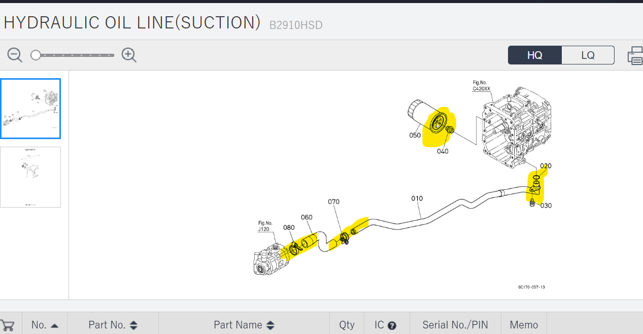

First make sure all these connections in yellow are leak free (not wet).
Make sure fluid level is up to level.

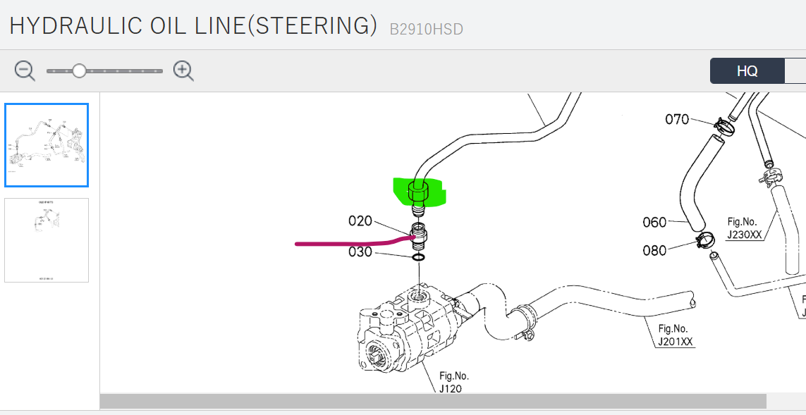

Start the tractor and run it for a minute, check steering function, if you have steering quit it's fixed.
If not, shut off the tractor.
Go to the top of the pump and locate the feed for the steering, use two wenches one holding the purple fitting and loosen the green nut, do not take it off, just loosen.
Start the tractor, be ready to shut it off quick, look for fluid to flow, when it does stop.
I finally got some time to work and try this> At first loosening the top nut didnt do it. I loosened the bottom until it was free ( 030 in diagram ) Suddenly the pressure blew out the plugged line with what looked like dirty fluid. I suspect the seller I bought the tractor from had not serviced it as he told me.
Im changing all the fluids now. I'll write the date on the filters when they are changed from now on.
