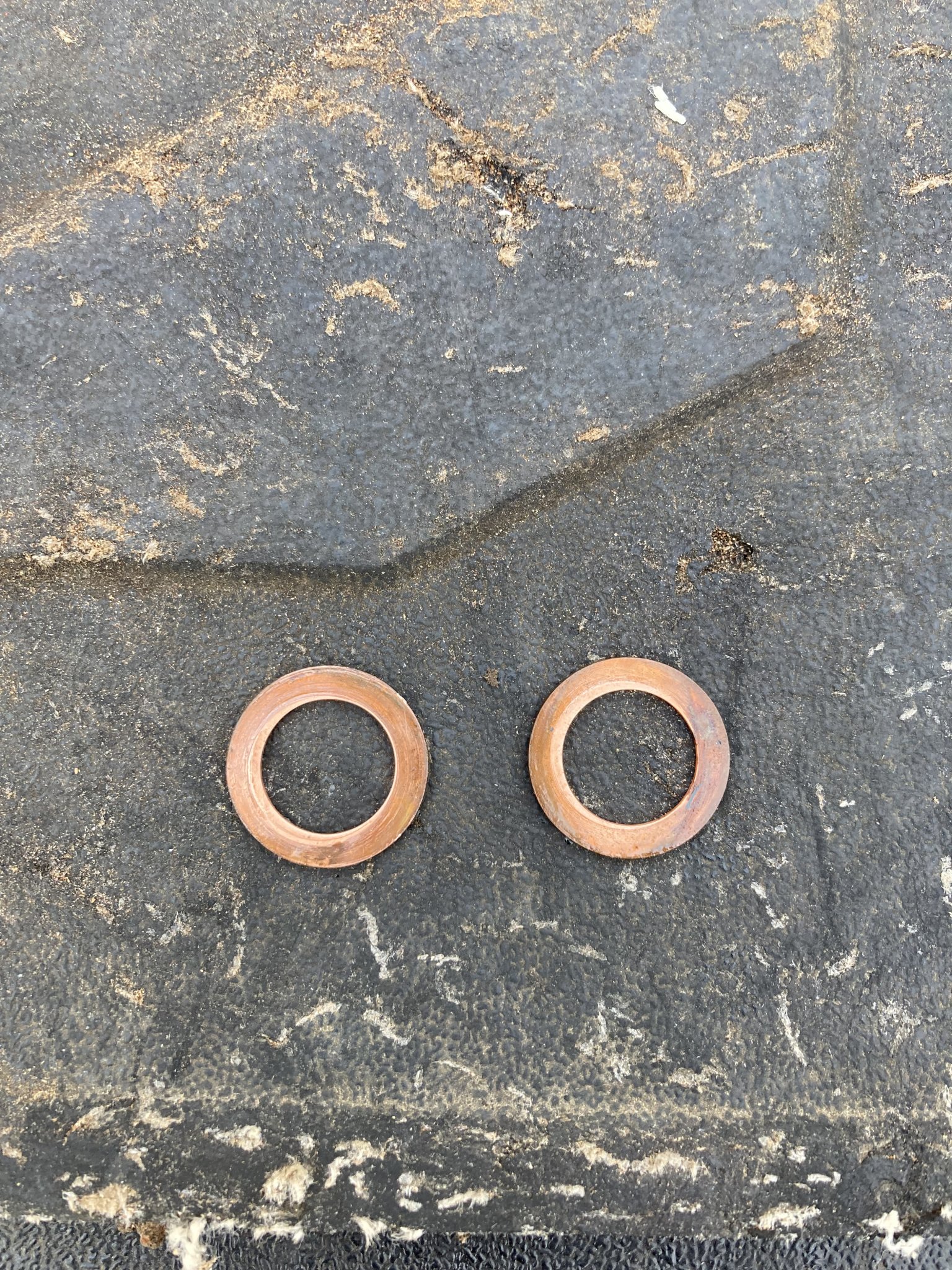

Jim’sMX
MX5100
Dec 19, 2023
91
200
W-S NC
The old ones don’t look bad to me, but the new ones seem to have fixed the problem. The hard line flexed away from the pump making it an easier procedure. The inner washer dropped out while I was prying the other one off the bolt. Nothing is this easy for me I’m not fully believing yet. Thanks again for the help. I had a 12pt 22mm socket.
