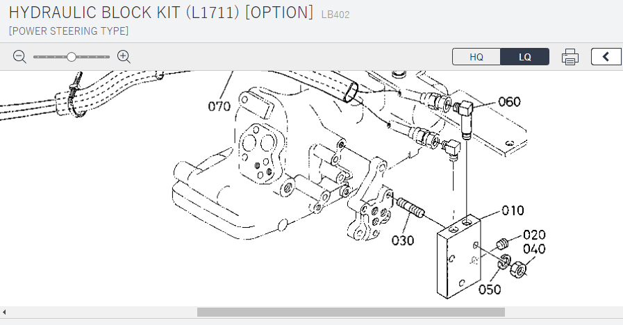

There was a lot of different blocks with different port configurations.
So do as @TheOldHokie said.
Disconnect the lines at the Valve not the block, it will make it easier to put the lines in a bucket.
Pull the manual stop and crank the tractor, the supply line will pump oil out.

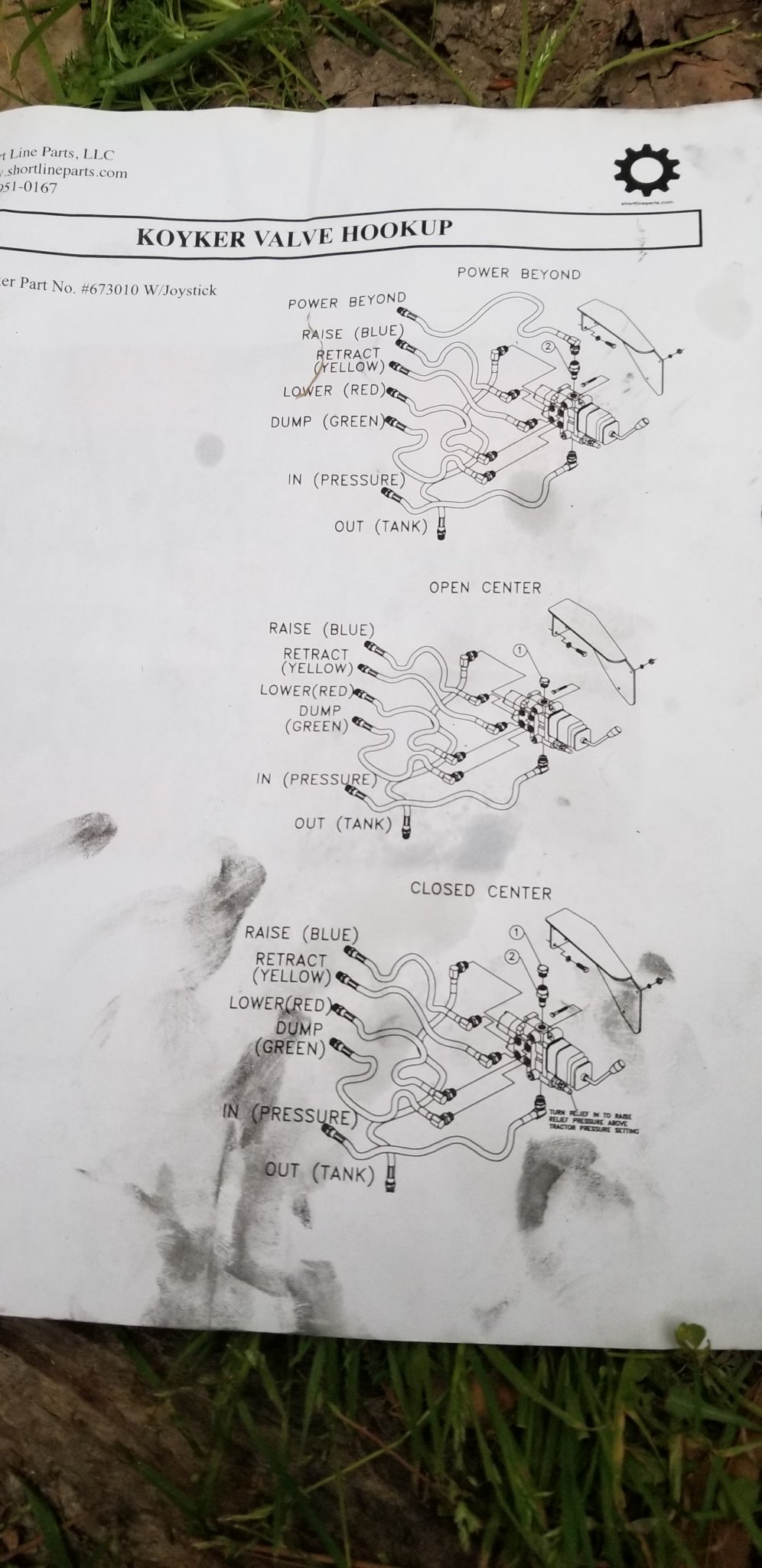

I pulled those labeled 7 on the bottom of the valve. It sprayed fluid nicely.
Per the diagram for my valve that is the in (pressure) line.
Should I assume the other two are swapped and change them out or is there a test I should do before hand?

That is the number one hose on the picture. It is power beyond on the hookup instructions I got from shoreline.
Now I expect I have air in the lines though with how hard the inlet was coming I doubt that would matter.
11,307
6,347
Air will get blown out of there as soon as the pump starts.
Yoy have oil going in and none coming out. And the loader does not work. Where is it going?
Can you post a pucture if the diagram of the valve?
