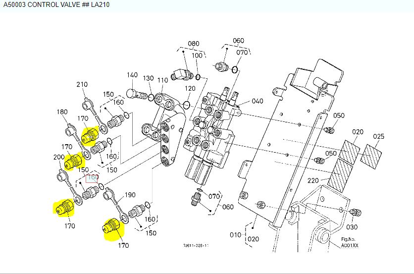

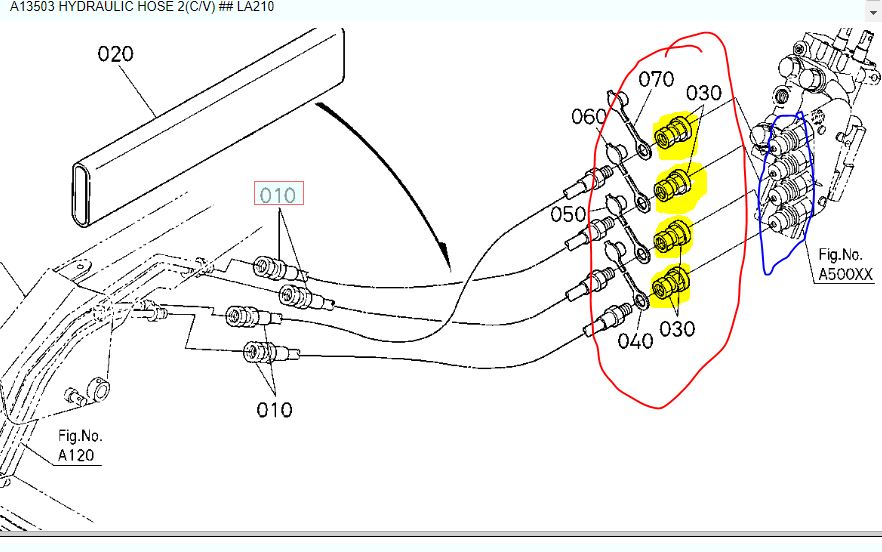

Sorry lets back up one step, lets make sure are lines from valve to loader are going to their proper pipe and valve hookup, look at this picture.
This picture also shows the line side (in yellow with red circle) quick disconnect portion (female) and the valve side (Blue circle) quick disconnect portion (male).
This picture is a breakdown of the valve side (male) of the disconnects
OK, NIW, I'm with you. You're talking about the parts to these connectors...the female connectors on the hose side, and the male connectors that on the valve side...all located below the joystick. Your thinking is that there may be problems within these connectors, especially the yellow line...could be either the male section or the female section?
Am I getting it yet? :)
