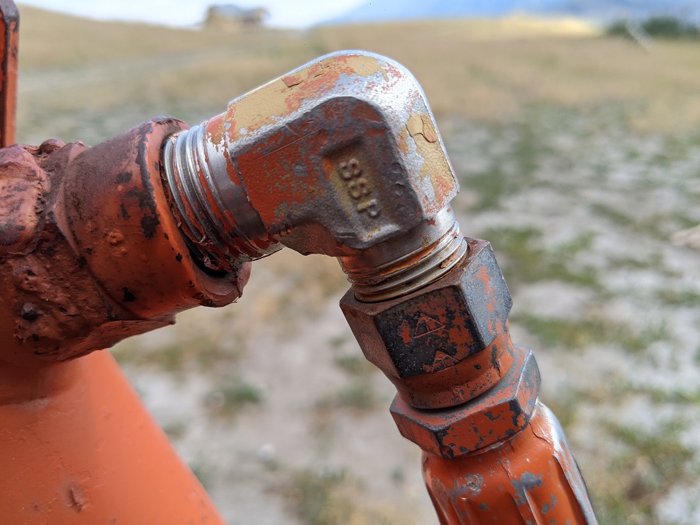

I have a M7500DT-A-L, and it has (I think) an M1820 loader on it. There has been plenty of... custom work by the previous owners and I want to clean it up while I am fixing/reformatting the hydraulics. Does anyone know what type of hydraulic connection was correct for this loader? I am guessing 37*, but I don't want to tear into it unprepared. It looks like at some point some of the hard lines were replaced with random hoses and a bunch of steel was welded all over to protect the now twice as thick hoses. I would like to replace the now rotten hoses with hardline and remove a bunch of the chunks of steel to get some smoother operation.

It looks like you have a ton of added pieces to make the fittings work. If you need new hoses anyways, i would take a hose off and take it with you to a hydraulic shop. Show them the fitting you need and have them crimp the connector needed to connect directly to the hardline. You could cut out the stuff in the middle and make it cleaner.
The fitting that goes into what looks like the cylinder... you can get a 90 crimped to the hose that will thread into the cylinder eliminating the 90 you have and 1 threaded connection.
As long as the new hose matches the hardline you should be fine. Be careful hard lining everything, the loader lines need to be flexible for the loader operation

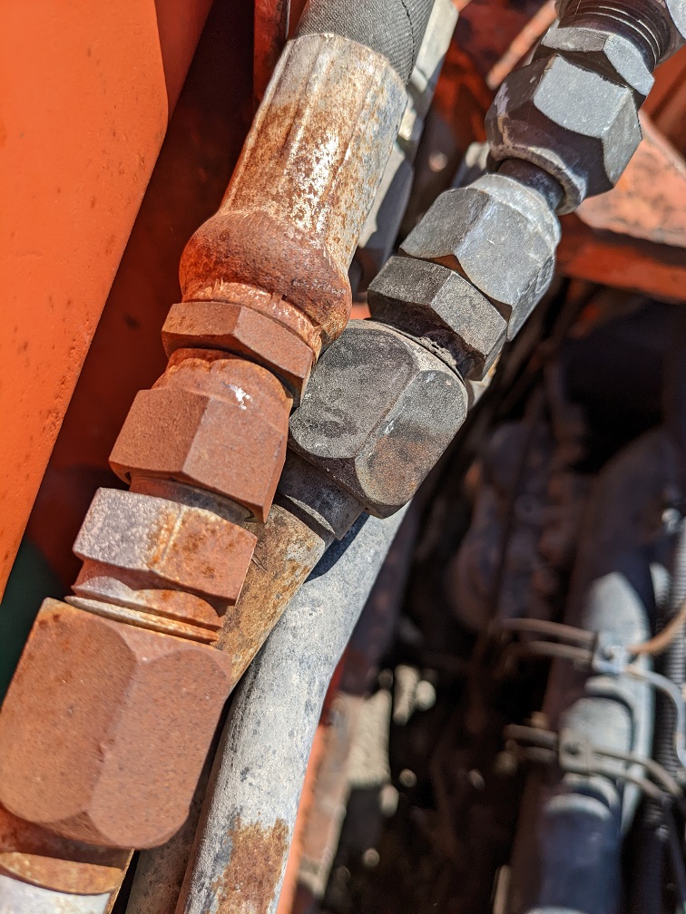

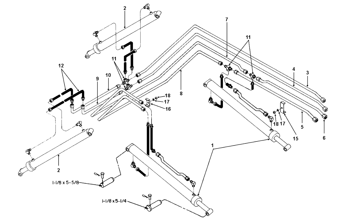

Hard line 7 - 10 has been removed and replaced with hoses, I basically just want to return it to this config (with short hoses for moving bits). The main problem is that 7 and 8 are kind of required clearance-wise as the hoses JUST clear either side of the frame, so it has to have steel bumpers that are tight enough that the engine loads up just pushing the bucket to touch the ground. With those lines I can grind the bumpers down/off and have a less frustrating experiance using the FEL. I will look into those and see if I can get some ordered to compare. Thank you!
The ports on the cylinder are almost surely NPT. If you are making the tubes and hoses you are in control of those connections. I know Kubota used brazed NPT female swivel ends on the tubes and hoses with male NPT ends on my 1980-ish loader. Over the years as things aged and failed I have replaced most of that with JIC.

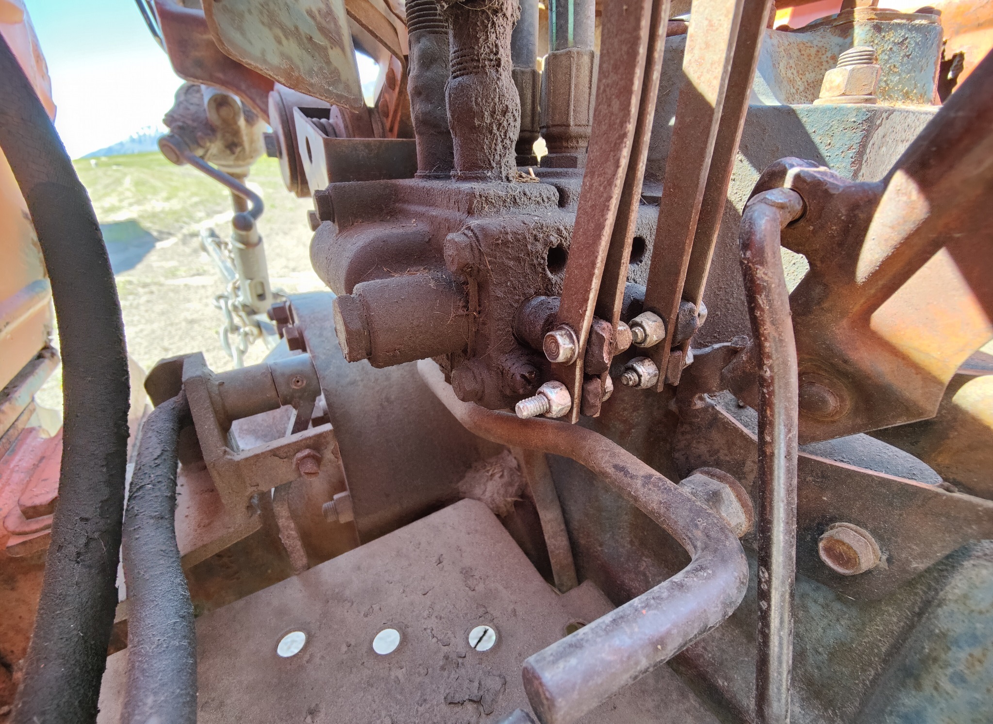

That's a great thing you are doing :) My M4500DT of about the same vintage uses BSP parallel threads for some connections (e.g. pressure line to the stacked valves on the side of the transmission) , and metric parallel threads (e.g. on valve work ports and return line connection to transmission).
Do you have any pictures of the control sticks for those valves? I think I have the same setup, and on mine the PO had fabricobbled the levers together from steel strap and all-thread. I want to see what they should look like. I plan to eventually put a new set of valves closer to the steering wheel and move to a higher volume crank driven pump for the loader. I am going to use those two for rear remotes.

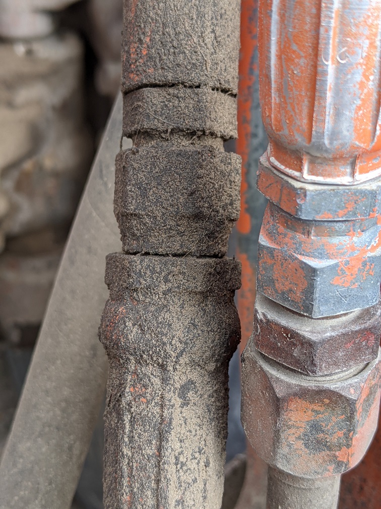

I got one of the tees off of the loader and brought it in to a local hydraulic shop. They confirmed it was a JIC #10 (5/8" 37* JIC fitting). When I was pulling it off I realized I am only missing line 7 and 10. For now I am just going to get line 7 replaced (Sounds like it will be about $200 to get that line built). I thought it might help someone else who is trying to figure out the sizing on those lines in the future. Thank you!
The ones I have aren't genuine, the levers were extended upwards to put them within easier reach of the operator. Photos of my setup here:
Lucky! I don't have a full picture right now, but these are my valves.
You get full pedals AND you don't get stabbed in the thigh by threaded rod! I want to set mine up similar to yours or just put stubbies on it once I go to a joystick.
