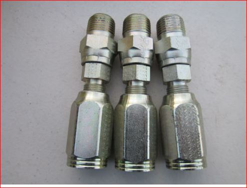

Re-useable hose fittings work in a pinch, but not the easiest to install on a hose. Having 1/2 the vulnerable hoses on hand will save you a trip to nearest hose supplier. Theres two each of same size hoses and possibly four each.
Im guessing three hoses would get you by.

You can get a set of reusable hose ends and a section of hose and have that around for an emergency.
