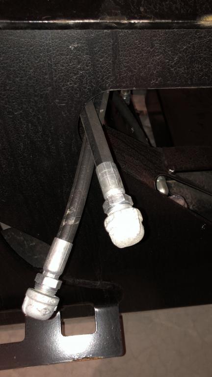

I have a B26. I just got a 3rd function valve for my loader installed by the dealer and a hla 1000 plow. The valve has block off caps at this time. The plow came with two small hoses that are also blocked off with caps. I need another foot or so to make the connection along with a coupler. I am not sure exactly what I need. Can you please take a look at the attached pictures and give me a recommendation as to what I need? Thanks in advance.

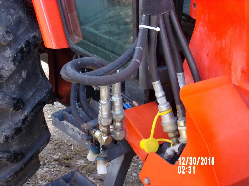

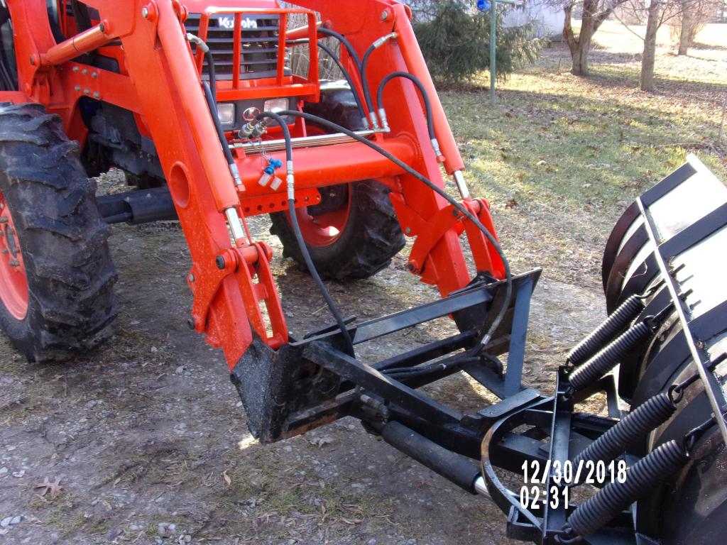

Just get the 'dust caps' for them., good idea to alternate the male-female connectors and when you install them, don't use Teflon pipe tape, use a paste sealer. Any teflon tape floating around in the system can cause issues.
Think I have a picture of mine but you will have to look close....
I also added how I made the 'third function' plumbing removable with the loader. That is all Pioneer male-female disconnects and dust caps.

Once you have installed the couplers others are recommending, get rid of the caps presently on the plow hoses. Those are galvanized plumbing fittings and have no place on a hydraulic system. On the plow unused, no big deal, but never put them on a system that could see hydraulic pressure.

Those galvanized pipe caps look like 'water service' ones, good for maybe 250#..
Replace them IMEEDIATELY with proper ones, good for at least 3000#...

Those galvanized plugs on the blade are dust caps only. They’ll be removed and tossed. Your new couplers should come with correct dust caps, which are typically a plastic or rubber push-on type. Just there to keep the dust and debris out. The quick connect couplings will keep the fluid sealed in till they’re connected.
If you want to see why, just keep operating the valve lever 'on-off-on-off----':eek:
The Gavi caps are on the Blade, kind of hard to pressurize them, they are just there to keep crud out of the lines. ;)
