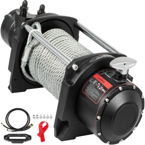

I would love to have a small front mounted Hydraulic winch for my tractor. Something along these lines:
My question is:
Could I use some type of 'diverter' to supply the winch with the hydraulics used for the front loader and thus use the spool valve to operate the winch (in and out)?
The object being able to use the front loader (not at the same time as the winch), switch the diverter and then operate the winch as needed.
I'm not well versed on hydraulics so any ideas would be welcome. I don't know the pressure or GPM requirements of the winch versus what my tractor output is, so it might not even be possible.

Your tractor has a 7 GPM implement pump which may be a little low for a winch. Most of the winches I found wanted flow betwenn 5 and 15 GPM. It will work but your line speed may be kind of slow - e.g. 20 ft/min as opposed to 40. All depends on how large the motor on the winch is. The gear ratio is 32:1 so they are probably using a small motor at a higher RPM.
For a power source a diverter valve would work but I fail to see any advantage to it. Its just as simple and probably less expensive to mount a single spool valve next to the loader valve and plumb it into the loader lines. You don't have to keep switching back and forth and you have a real third function. Guesstimate that at $250-$300.

Yeah. apparently this winch wants about 15 gpm (by design) to operate at full capacity (speed).
I'll need to look in my repair manual and check the pump flow rate for my tractor, but online sources say between 4.4 and 7 gpm. Either way....would make for a sluggish retrieve of cable. Dang it..........!

I looked it up before I posted. The DT flow is 7 GPM and 2WD is 4.4.
