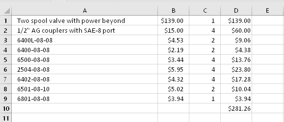

I'm about to work up the full cost of all this to make sure I've got a handle on what's involved. Seems like the valve itself, hoses and connectors, 4 quick disconnect pairs so far.

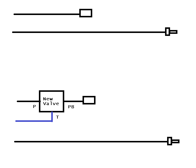

I am saying no hoses on the quick connects - mount them right on top of the valve. That will save you significant $$$ and a lot of grief dealing with hose management.
You need to add a tank return to the plumbing for the valve. That is not the same as the backhoe return The backhoe return is a high pressure power beyond going to the 3pt. The low pressure tank return is a new low pressure (300 PSI) hose going to a tee installed in the loader valve tank return. See B2650 parts diagram below. Just some cheap and flexible oil resistant hose like used on oil coolers and 4 hose clamps,

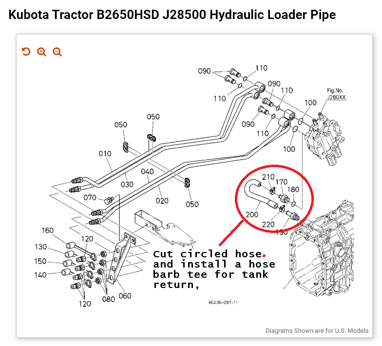

Here is the plumbing.
Top is the two existing lines for the backhoe.
Bottom is the modified circuit with the new valve installed in the backhoe supply line. The blue line is the new tank return.

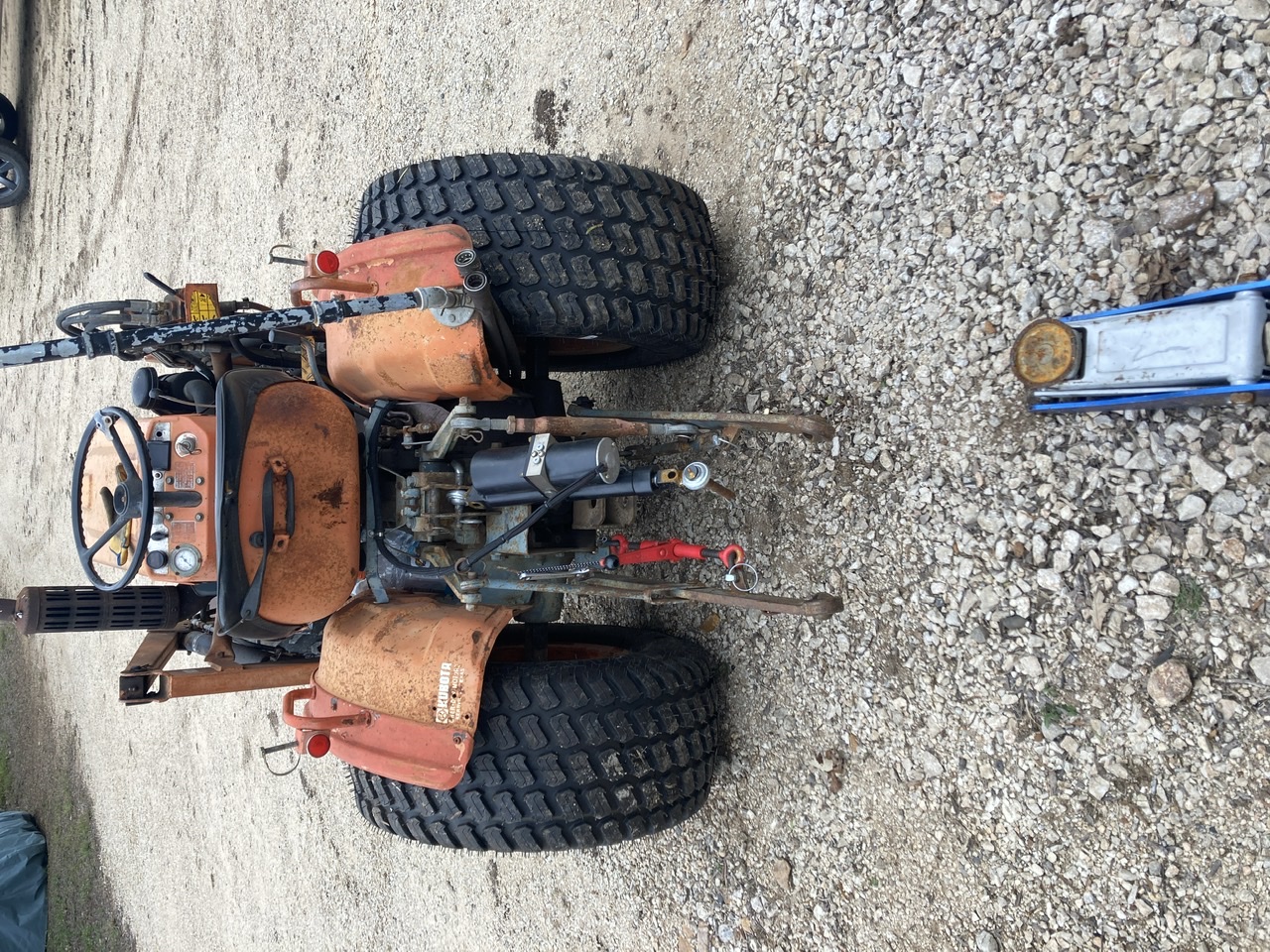

I am NOT going to push the electro-hydraulic actuator solution but i will at least explain it, in my case anyway. I got mine (2 of em) for $200/ea on ebay. Not because they were exactly what i wanted (theyre on the small side for this job) but because they were the ONLY reasonably priced ones i found for sale over a period of about half a year.
I installed one as a power top link on my Kubota B6100 powered through a 6-terminal ‘motor-reversing’ switch. I verified it pulls no more than 22amps on 12v when hitting its relief pressure. I have more like a TWO amp charging system on that tractor but you dont run a top link all that often so it averages out just fine. The first one i ordered a spherical rod end (ball joint) that would screw onto the rod and left the base end a regular crosspin hole. Eventually after maybe a year i got careless and let an implement jam up on the onboard reservoir of the cylinder and crack it, so i swapped on the extra one i had until i repaired the other one. This time i just welded ball ends on both ends because i was feeing a lot more confident about welding by then.
So, issues..
1. availability. You want a different size, different force level? tough crap. These things barely exist in a competitive price range to normal hydraulic options. Keeping in mind, by the time you hit 350$ or so you can buy a standalone 12v hydraulic power pack and any dang cylinder you like from surplus center and have tons of options.. but in the <$300 range options for electro-hydraulic actuators are extremely limited.
2. Strength. The ones i have are barely strong enough to handle the job of top link on my tractor which is the absolute bottom end of the cat1 size range. It has no problem pushing out (duh, gravity) but when pulling the top in it struggles (just really slow) with 300-400lb attachments and i doubt it would tilt up my bush hogs at all, though i havent tried. You can work around it pretty easy if it were to actually stall out pulling on something, but this is the main reason i dont really recommend the specific cylinders i bought for anything other than the smallest cat1 applications. I do think these exact models would be good for anything that has to do with pushing wheels down on a drag implement, or angle adjustment on an implement. I dont foresee ever NOT using the ones i have, but i will eventually use them for something besides a top link. Like welding, my familiarity with hydraulics has improved leaps and bounds and i can diy a full hydraulic top link setup right now, just waiting on motivation.
So given the same circumstances i would do the same thing over again, it truly is ‘good enough’ for my application and cheaper and simpler overall than 99% of all hydraulic
top link setups. I really like these things. But i dont go songing their praises because i cant point you directly to a bigger model that would be strong enough for a bigger machine/implements and still cost less than a ‘regular’ hydraulic top link setup. So in some ways, my setup is a fluke. But its still cool for me, and im still happy with it and glad i did it. 😎
sorry about image rotation 🤷‍♂️

Yes - much less expensive than people think. I do lots of these and unless there is some problem with obstructions that list will put the valve and couplers under the seat. Then its just a some minor rerouting of the backhoe supply line.
The valve and couplers are Summit. The part numbers are industry standard JIC/SAE hydraulic fittings. I probably have most of it in stock. Just ask Google to show you pictures.

That is 99% correct. But....
You cant treat the valve for the remotes the same as the valve on the backhoe. Why is that?
Its because Kubota is cheating with their backhoe hookup. The backhoe return line is actually connected to the inlet on the 3pt valve. When the backhoe is hooked up the 3pt is physically disabled so that "return" line is open to tank and there is no back pressure on the tank port of the backhoe valve.
When you take the backhoe off and hook the AUX valve up you will be using the 3pt to lift things and that will subject the "return" line to full sysyem pressure. The seals on the tank port of the AUX valve are not designed for that level of back pressure and you risk damaging them = leaks. So you need to use the power beyond port on the AUX valve to feed the 3pt and that in turn requires a third dedicated tank port - e.g a third coupler your backhoe circuit does not currently have.
Clear?

Omigosh, I think I ALMOST understand that.
The backhoe hookup relies on the idea that the 3pt hitch won't be lifting anything (because how could it, there's a backhoe there!) Sure, it still works, I've moved the hitch while the backhoe was attached...but there's no weight on it, so no real pressure buildup when the hydraulics are involved.
If I hooked up the valves the same way as the backhoe, then there would be hydraulics going into that port on the tractor potentially when the 3pt hitch IS lifting something heavy...and it wasn't designed for that interaction.
That's brilliant that you know that. I would have just figured it was a supply and return line, and so you could hook up anything to either line and use it any way you wanted.
Now I believe I understand why I have to create a return somewhere else from the valves Doing that, because it sounds like hacking a part, is still the scariest aspect of this whole thing. Do I cut into a line somewhere (not random, I know...just don't know where yet), put in a t-junction, and then connect 3 hoses with hose clamps?

Careful - my ego is oversize already :giggle:
You got it figured out.
I would just caution that raising the 3pt lever with the backhoe connected can damage the backhoe valve. There is no weight on the lift arms but when the lift gets to the top pressure can still max out at the end of its mechanical travel.
The loader valve is just like the AUX valve and it already has a tank return connection. Its a low pressure (300 PSI) hose connected with hose clamps. You can tap into it by cutting it in half and installing a tee. Then plumb the tee to the tank port on the AUX valve with a few feet of inexpensive 3/8" transmission oil line and hose clamps. I posted a parts diagram showing the location of the loader tank return a ways back in this thread. Should be nothing scary about making that low pressure connection

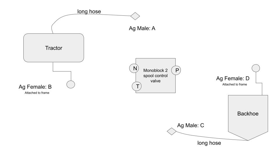

Ok, I'm finally back on this. Weather has warmed enough to get me outside again.
I need to fully understand the connections that have to happen before I can start to visualize it and then order the other parts I'll need.
I drew a diagram to help me understand what connection goes where. I've arbitrarily named the 4 existing connections as ABCD. So, in normal circumstances with the backhoe removed, then I connect C to D and A to B. When the backhoe is attached, I connect A to D and C to B.
So, what I need to understand is how the N, T, and P connections on the valve enter into the equation. I could guess, but that'd be fruitless.
Thanks for any help.
