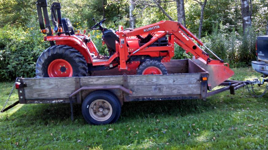

My b7800 in my trailer taking to the woods to skid tops for fire wood last fall. Trailer is 6'x10'8" no brakes on trailer truck 2007 GMC 1/2 ton standard cab 4.8 auto no problems. uploadfromtaptalk1456964127882.jpg uploadfromtaptalk1456964142980.jpg
Sent from my XT907 using Tapatalk
34,506
9,749
WOW! :eek:
You are literally breaking every rule in the book, wow. :rolleyes:
I wish you luck and hope you have a big insurance policy! ;)
