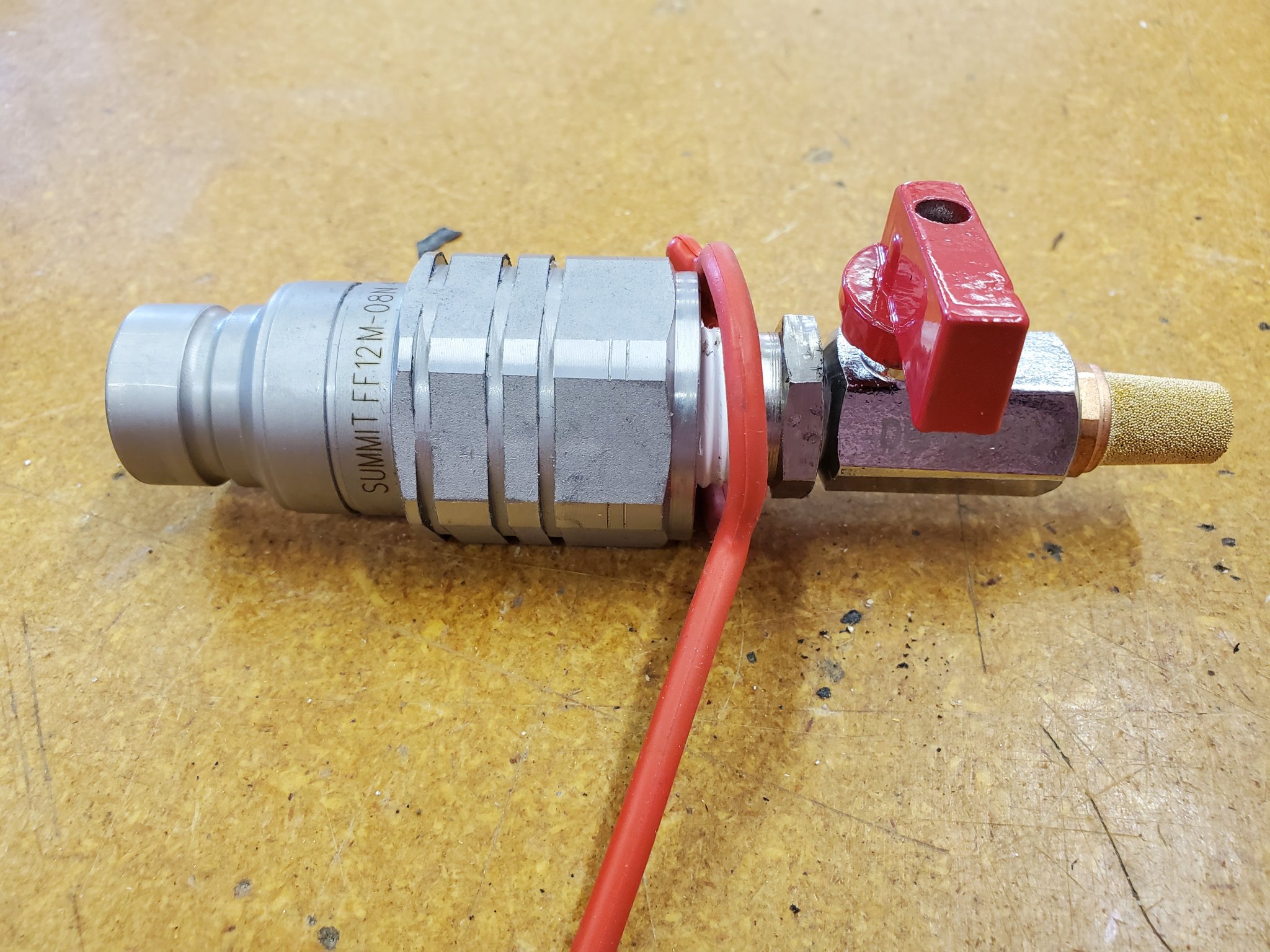

You have pressure build-up in the lines on the grapple. You relieved it when you removed and reinstalled the couplers. There are commercially available solutions to depress the center check valve to make hookup easier. Here's something I built.
Made one for each hose on the grapple.
Made one for each hose on the grapple. View attachment 78051
McFarmall,
Is this just a shut off cock? Shut down the line, hook it up, then, open the line back up and away you go?
If so, how does it work for you?

McFarmall,
It's just a ¼" ball valve and a sintered bronze pneumatic "muffler" attached to a male and female flat face coupler. I click those onto the grapple hoses with the ball valves closed. When I use the grapple again, I just crack the ball valves to relieve the pressure in the grapple hoses. I depressurize the third functions in the usual manner, then hook up the grapple hoses to the tractor. This has worked great for me so far.
OK. I'm tracking now. You click these in when the grapple is not in use, then, relieve the pressure from the grapple lines prior to hooking up again. Nice.
I leave the depressurizing couplers on the whole time the grapple is parked. They live on the grapple when it's parked.
