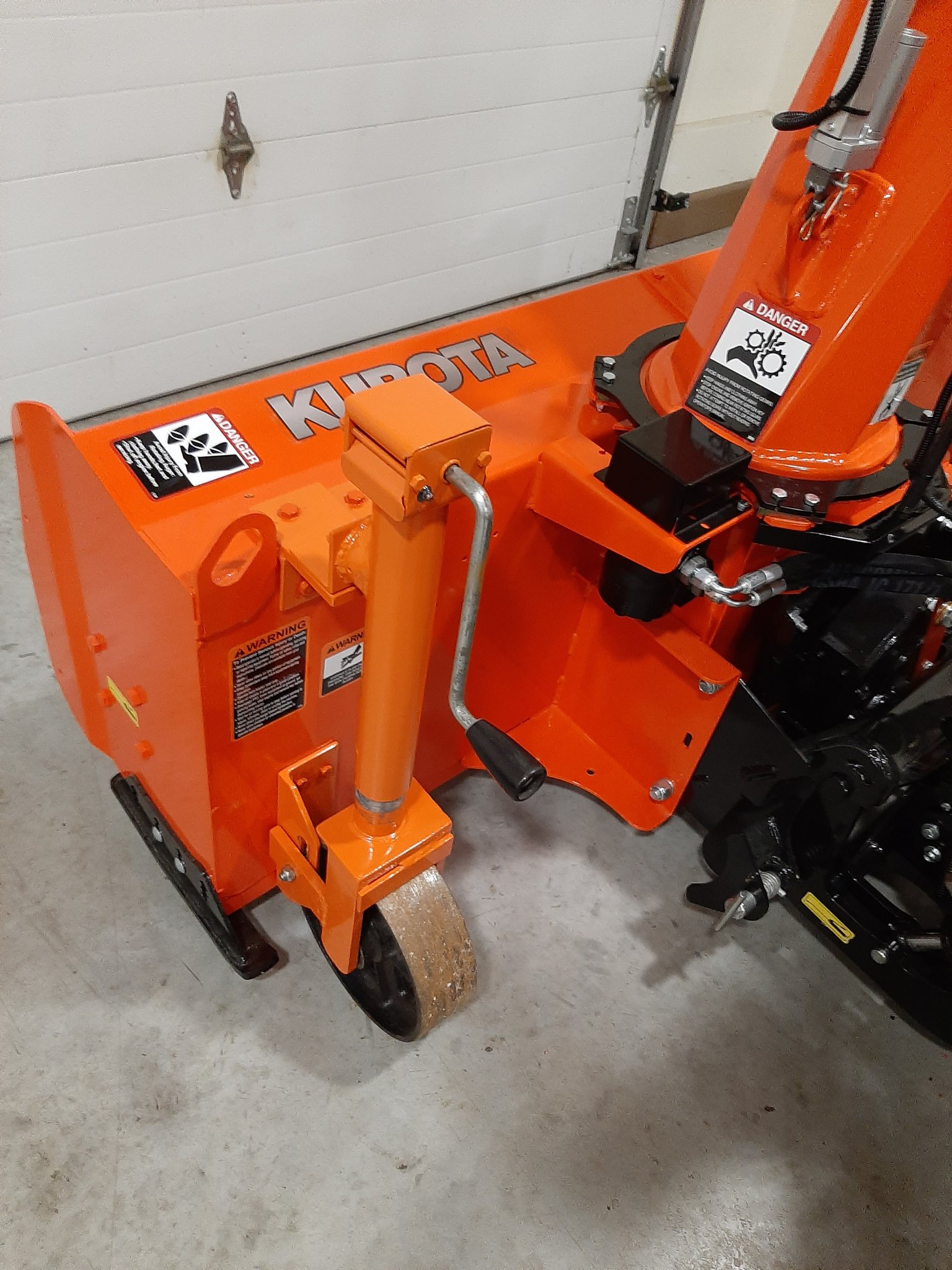

I'm.gonna receive the restrictors on dec 16. I'm being impatient and tempted to try something else in the meantime. I saw some people tapping the inside of a fitting, adding a bolt and then drilling a small hole. Would it be a bad idea to just fill the inside of a fitting with a big ugly weld blob? I'm guessing that if aome particles would break free it could break something.
12,960
7,345
You can make a restrictor plate by drilling a .030 or .060 hole in a small metal disc then put the plate inside the fitting. I almost suggested that a while back.

The easiest way is like you said. Drill and tap for a pipe plug size and drill a very small hole to start.
Maybe a 1/16".
I have used this method for slowing functions on equipment we sell.
Weld might be hard to drill. Can also have small pieces possibly dislodge b

I made a small disc with a 1/16 hole.
At low throttle it's manageable. At high throttle it's still too fast. The restrictors I ordered will be 1/32 so it should help. My intuition says that adding 2 restrictors instead of just 1 won't make a difference.
Now it doesn't make a difference whether I slap the valve full on or just barely. But that was expected and I understand why.

You are doing a great job. My new blower has the identical chute rotator from the factory and even it rotates faster than I like so I might eventually install a restrictor in the lines as well. I might also say that mine does not rotate all the way and just stops where the teeth stop. Does not seem to cause any issues.

I just received the 1/32 restrictor today.
This is much better. And it doesn't matter if I'm on high or low throttle.
