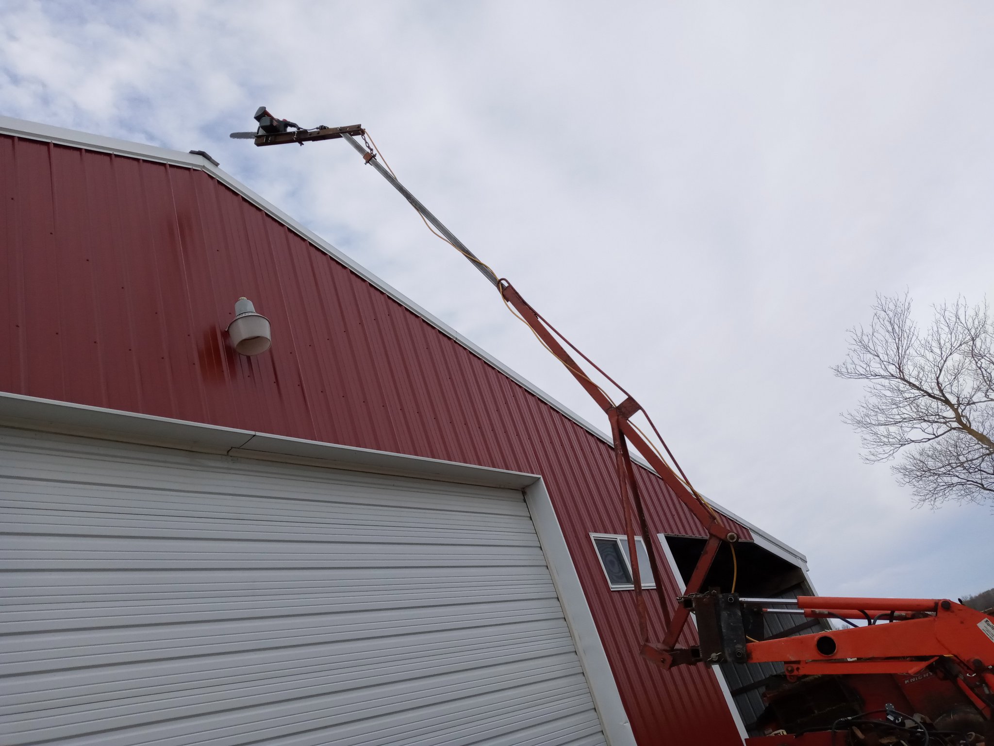

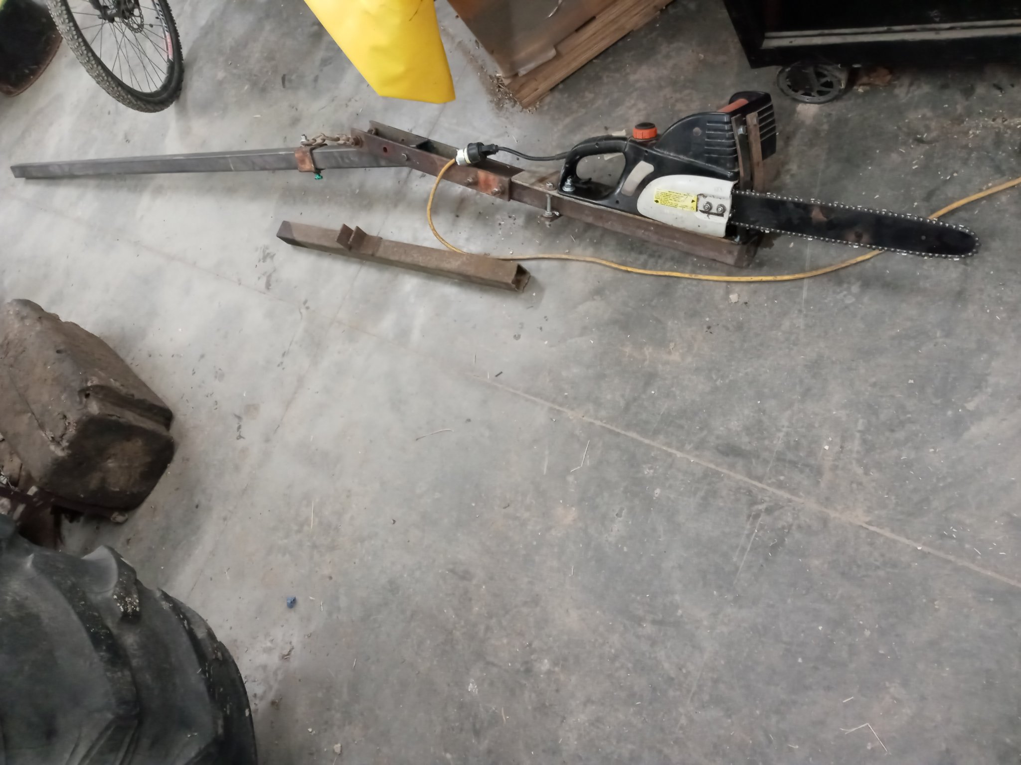

I wondered about a limb saw, then put this together instead. $2.50 auction electric saw, the rest I had laying around.

I like it Boz. I'd need binoculars or a camera though. You wouldn't have a picture of the attachment, by chance? I have my Ryobi 40 volt chain saw modified for remote run/stop and planned to mount it on a much shorter pole.
I hope to use it again soon and I'll get some better pictures. This is the first saw, drive sprocket went bad, so I'm using saw #2. I have a generator on a trailer behind me for power. The saw works much better than I thought it would. After using it with my Kubota, I wouldn't want to use a bigger clumsy tractor.
