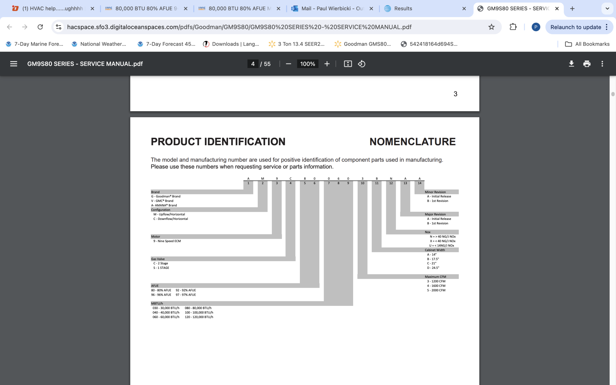

OK, so I called "HAVAC direct" and the guy told me that Goodman uses 2 names "9 speed" and "multi speed', but they mean the same thing.
Apparently he was correct too......I hate just taking someones "word for it" so after some searching I found this 'decoding chart' and the difference between the 2 models I listed is a (3 and 4) which is the "tons"
GM9S800804BN VS. GM9S800803BN
The 9 in both of the part numbers means "9 speed"
So decoding the above part numbers mean that these are both
Goodman
Upflow
9 speed
1 stage
80%
80,000 btu
One is a 3 ton, the other a 4 ton
2,815
3,386
So I guess I have no choice really, but I have to get a "variable speed" motor.
If anyone knows that I have misunderstood anything, please speak up.

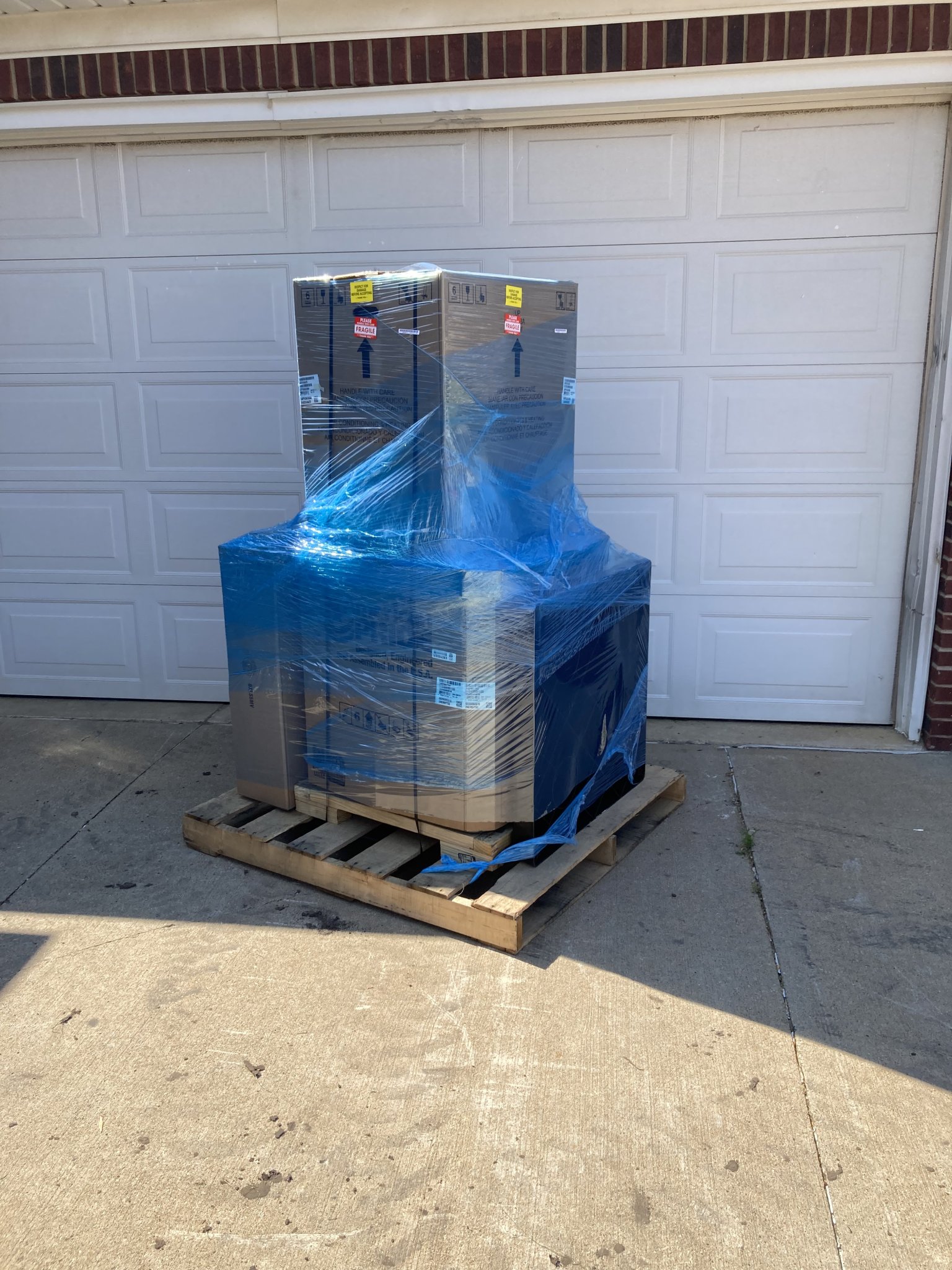

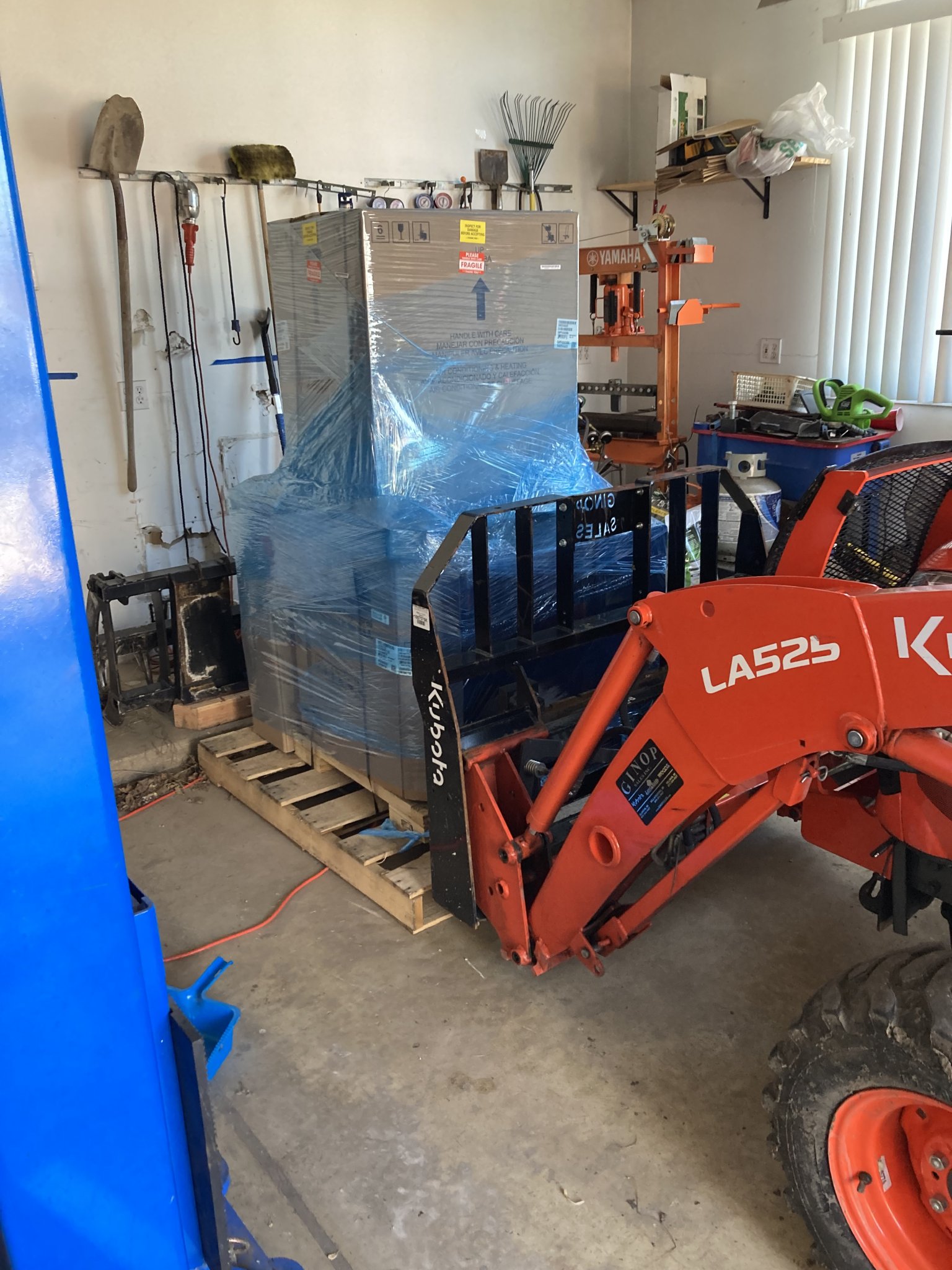

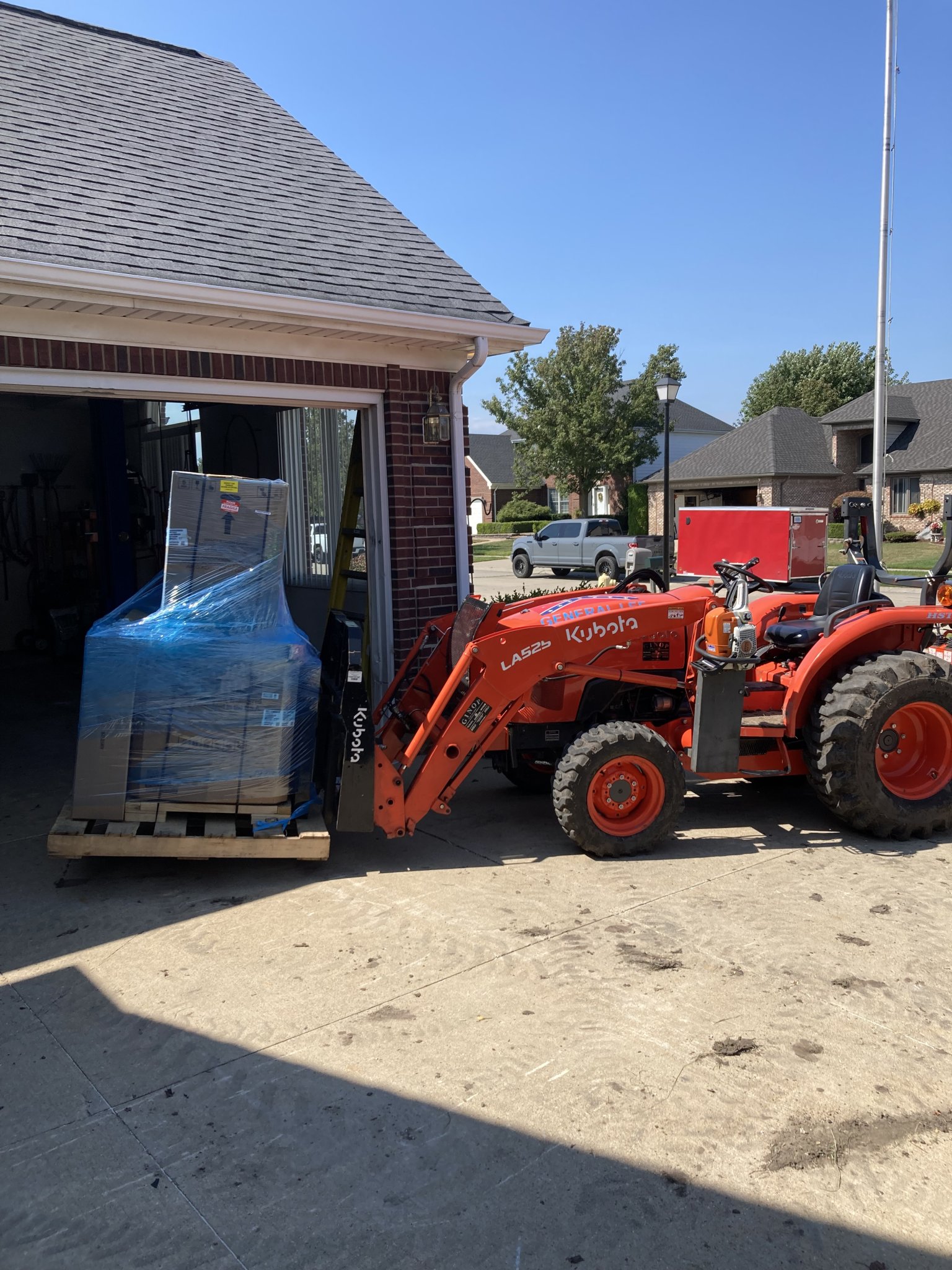

Here are some pics for reference.
and right here is one of many reasons to have a tractor!!!!!!
looks heavy!!!!!
nope not heavy at all when you have one of these....
all tucked in and ready to mate up with a furnace.
