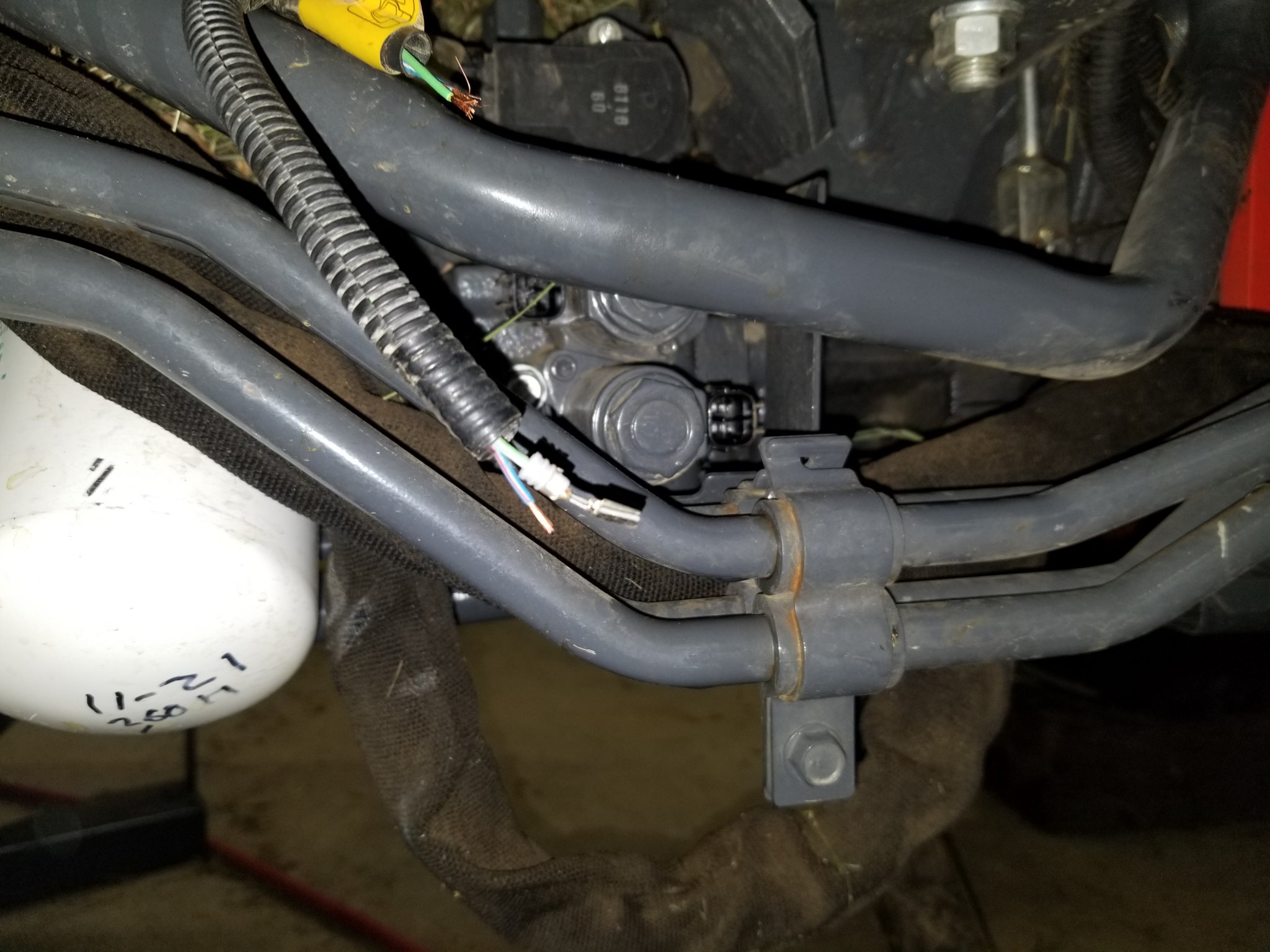

Error No. 90 HST-F Solenoid NG.
I ran over 1 stick. It made it between the brake rod and the main oil line. Ripped the wires out of the servo regulator.
I think from Kubota you have to buy the whole harness.
I don't if their is a +- on these.
I would like to buy the plugs with 6" of wire.
Or the metal prongs would work.

They look like pretty common connectors. Just google search 2 pin auto pigtails. If it ripped the pins out of the connector shell then the shell is likely damaged as well and won’t hold new pins
i may have some in my stash at work, may send you a PM this week if so…

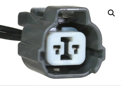

Looks like I found it.
$78.35 each
link doesn’t work (on my end anyways)

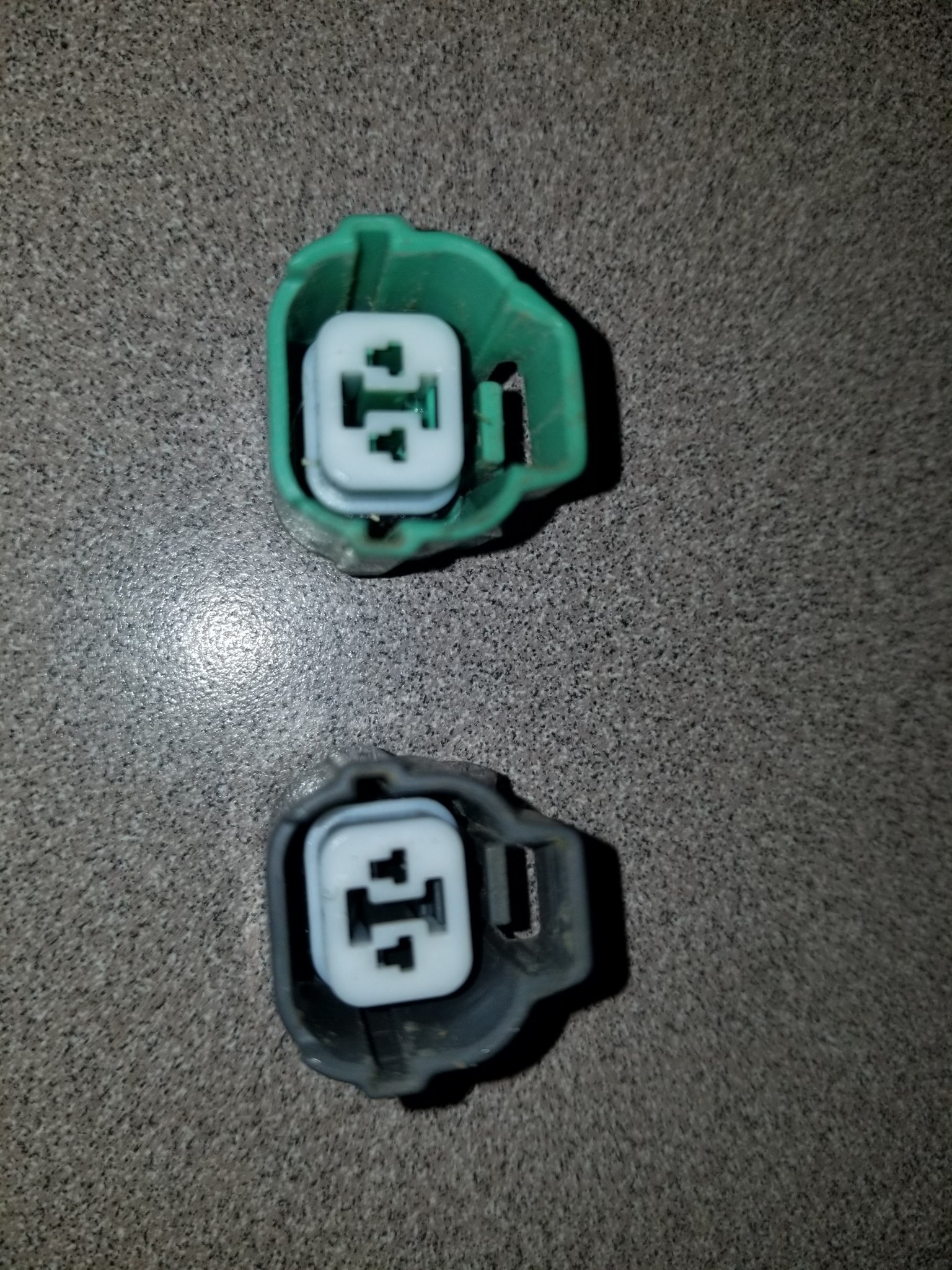

are the connectors the same (aside from color obviously, it’s hard to tell in the pics). Will either one connect in place of each other?

Try this link. That price is insane.
Heres another I found at a more realistic price.
And yet another
Seem to be used on Honda/Acura headlights

i agree the price is insane. I was a dual brand tech for a while and one was a Japanese brand. I have harnesses laying around because pigtails aren’t offered(in the dealer world) They look pretty identical in the pics
Thank You I ordered some off ebay.

The Solenoid is 3.2K ohms both ways. I don't think I have to worry about polarity.
It is really a Proportional valve.
