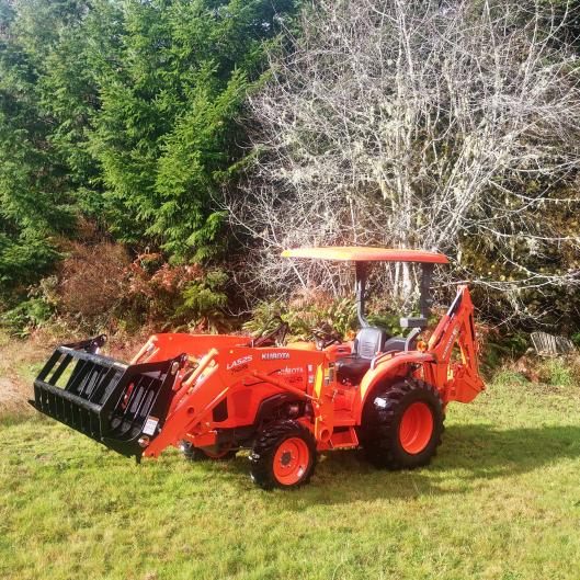

This is my new L2501 DT love affair, the blackberrys around here are in serious trouble, .7 hrs on it...it's sure shiny & new lookin' it's like art in a way all perfect like that....not for long...[/ATTACH]

I'm glad our experience with your tractors help you make your decision.
Enjoy.

Nice machine! Got all the goodies too.
