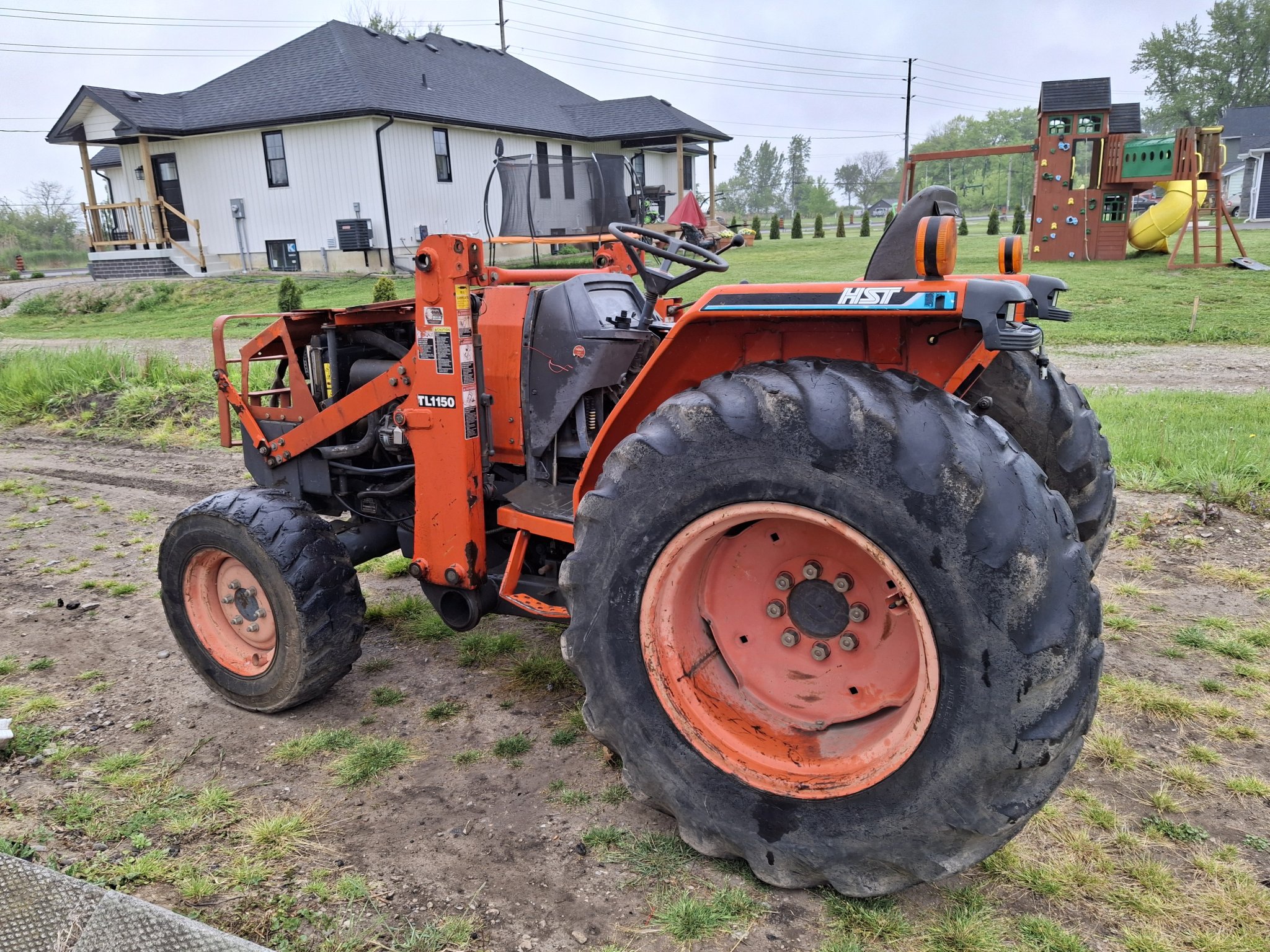

Okay guys, I may have a verdict. Couldn't get the tractor to stall in medium range, revs up, pedal full forward, brakes fully pressed. The revs didn't dip once.
Clutch gotta be burned up.
The tractor supposedly has 1380h on it. But it looks like all very hard hours as it's pretty beat up.
I find it weird how in high and low range, the tractor won't move. But medium range I can get it to limp along.
But the pto still engages even in high gear.
Am I doing something wrong? Any other tests I can run on the clutch?

You shuld be ablr to stall it in medium range. Put the nose against a big tree and try again. Then repeat in low and high.
We may have a misunderstanding. By 'stall' I don't mean the engine stalls. I mean the wheels quit pulling.
With the brakes pressed, high range, pedal forward, the engine kept running, did the wheels stop? At that point did the PTO keep turning?

Thoughts? Advice? Clutch any good? I'm leaning towards a pressure issue...
Please advise this tractor newbie. Thanks!
I couldn't understand all you said, but I think you had it in high range, pushed the pedal, and it barely tried to move. The PTO continued to rotate at the same speed. Right? If so, we've ruled out the clutch.
Now on to the logic diagram in your post #1. As the diagram directs, test the charge pressure first. Since both forward and reverse are affected, the charge pressure is common to both.
You have checked your fluid level, correct?
Thanks for reviewing my video!
Yes, I feel the clutch is still good.
Correct, I put it in HIGH range with PTO engaged. Pretty much did a brake stand and no effect on the PTO. Rotated as normal.
I guess I'm onto HST pressures now.
Well, I still have travel, right? I can still limp the tractor around- both forward and reverse.
