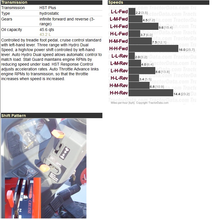

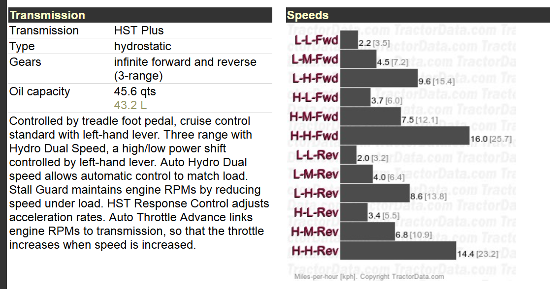

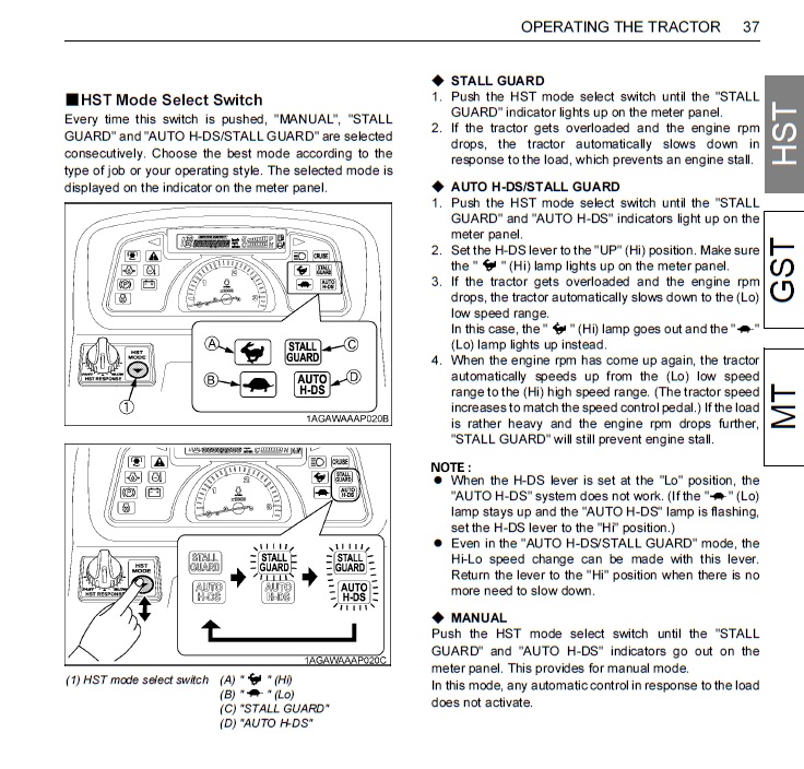

From the symptoms (as I understand them) the tractor is acting like its doing unintended, quick changes of gear range without conditions calling for it. Does this L4740HSTC-3 have menu-selectable HST mode controls?
As Kubota has developed the HST transmission, adding electro-hydraulic features like Stall Guard, Three-Range Hydro Dual-Speed, Auto Throttle Advance, and HST response control, my head is spinning trying to imagine their possible failure modes - and how those could interact to produce the symptoms you describe.
Maybe somebody more familiar with how they work will have some ideas. Dick B.

Does this L4740HSTC-3 have selectable HST modes?
Yes, the -3 version has all the newer HST features... Perhaps too many :)
As Kubota has developed the HST transmission, adding features like Stall Guard, Three-Range Hydro Dual-Speed, Auto Throttle Advance, and HST response control, my head is spinning trying to imagine what their possible failure modes might be or how those could interact to produce the symptoms you describe. Maybe somebody who's mastered this new chapter in tractor operation will have some ideas.
From the symptoms (as I understand them) the tractor is acting like its doing unintended changes of gear range without conditions calling for them?
Definitely not gear change as in L M and H. It acts like it is getting an erroneous signal from HST pedal. If trying to simulate it would be like stepping off and on pedal rapidly. Because of this, I tried testing pedal sensor monitoring resistance change with rotation. Probably cycled it 100 times over several days hoping I'd see some crazy glitch. Also used the display in diagnostic mode to watch input voltage for HST pedal while it was acting up, but all looked steady. But it is always possible the display updates too slow to see a signal glitch. I don't have an oscilloscope or similar to monitor in real time. Additionally, no codes are recorded in the panel.
I wish I could find more detailed literature on these newer control systems. The WSM is limited in what it covers.
Hypothesizing one of the proportional valves is not making good electrical contact at sensor or possibly the computer. I have never pulled the CPU harness as it is difficult to get to. Then again, I can not find any literature describing how proportional valves control speed or if there is another sensor responsible for this.
It's not dropping between hi and lo as the dash doesn't indicate a change (turtle and hare symbols).
