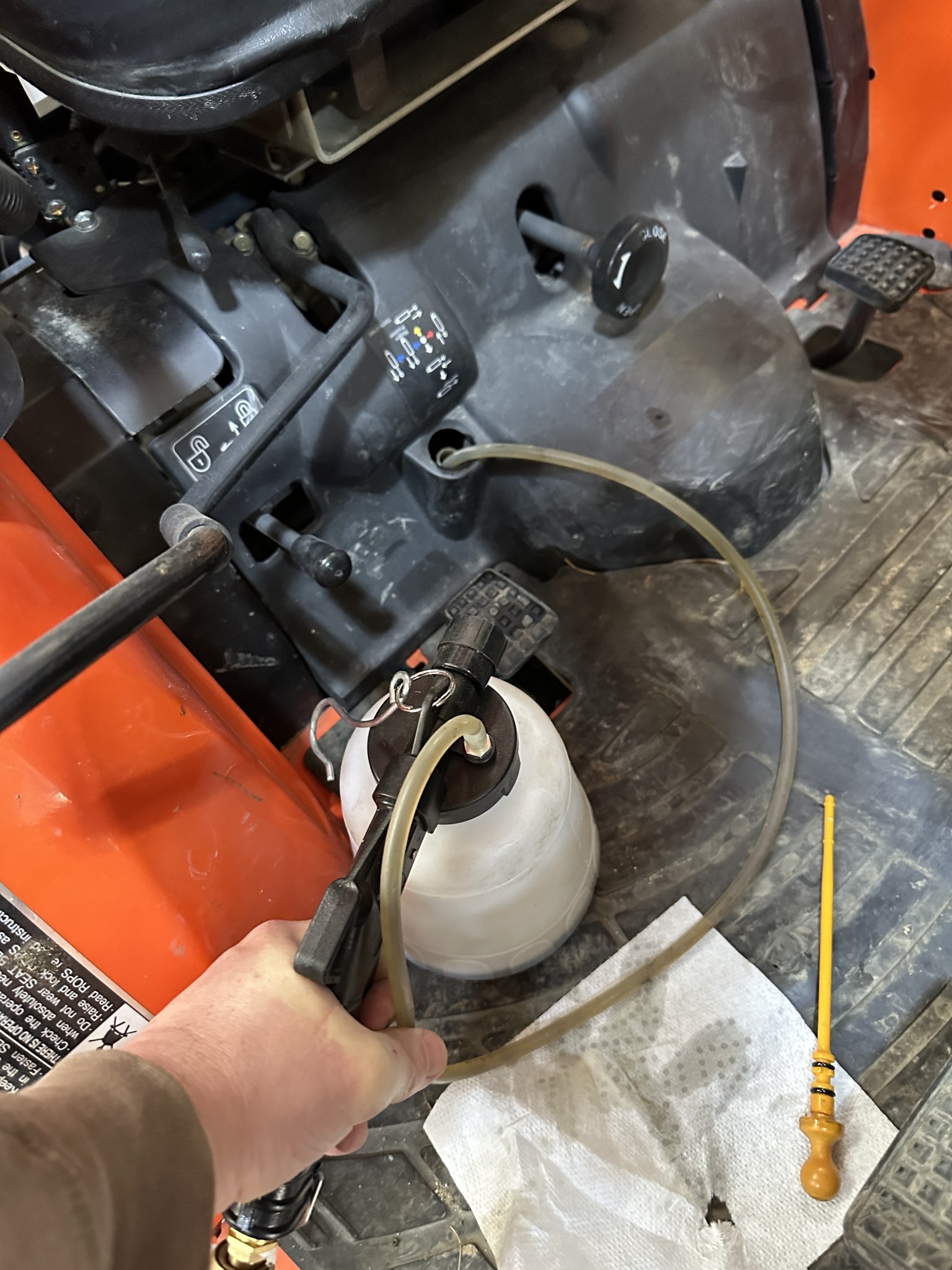

The whine was on the ride back along the driveway. The thing that got me was the level on the stick once I shut it down being low. I did check multiple times. The today it being above the full mark. I will let things drain out of that dipstick tube and check again in the morning. I used my power bleeder to go in the dipstick tube and suck fluid out. It’s a lot more accurate than popping a drain plug and making a mess. Made sure the suction hose was clean and set it on a towel when I was checking the level IMG_2115.jpeg
