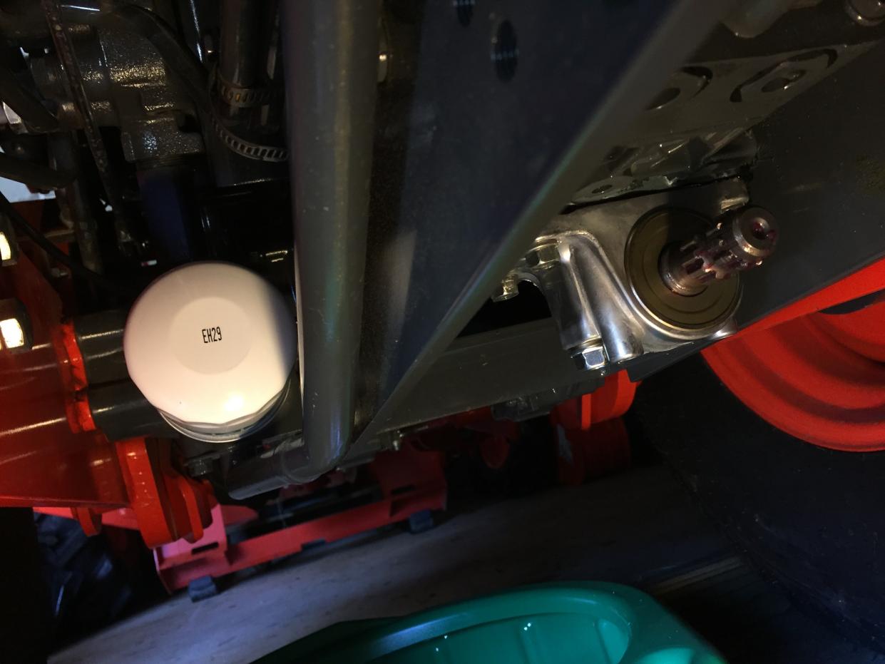

On the left hand side of the mid pto shaft there is an HST suction filter "HH670-37710." It keeps leaking. I tightened it by hand as much as I physically could muster.
I thought maybe something was defective with the filter and I have a spare so I swapped it out. I cleaned where it gets screwed in to the max, everything looked good. Now the second new filter, still leaks. I went to napa and bought a cap style filter and used my ratchet to tighten it up even more.
Still leaking.
Here's a shot of my first replaced filter top. I screwed it on so tight the metal started to scrape. I guess I can remove it and take a picture so you guys can check it out but I have to run out for a few hours.
What gives!? I just poured four gallons of SUDT fluid in there. I'm beyond frustrated. :(

Thanks for the replies guys. I got back home after 5 hours and it was leaking just slightly. I took off the filter and gave it a quick wipe and cleaned it up again. I put it back on with my cap oil filter wrench (Which is 80mm 15 flute by the way) and it held.
I ran the tractor for about 30 minutes and drove it up and down my drive. So far so good.
It's a mystery to me.

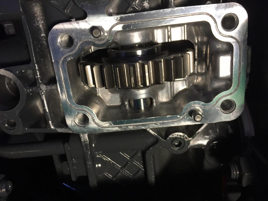

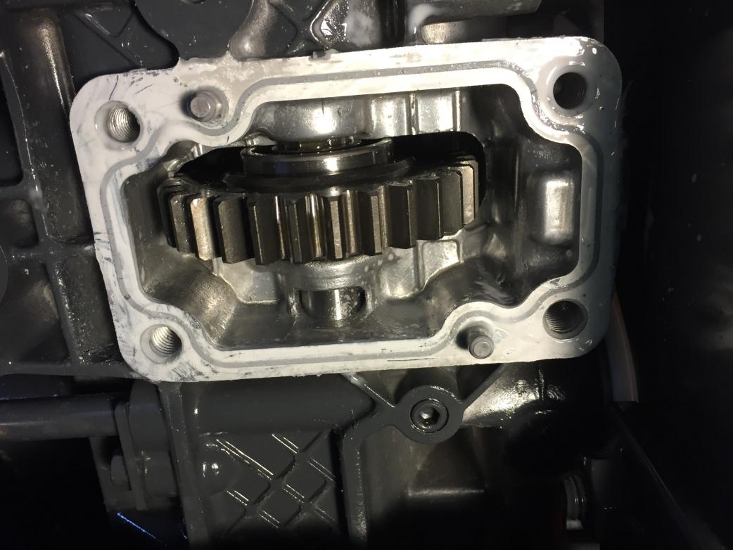

What could possibly have gone wrong? I pryed the seal off, removed the ring, reassembled the shaft exactly as it came out into the new gear casing. Reinserted the ring and pushed in the new new seal, applied the gasket material, and reinstalled the housing just as it came off. It didn't appear to have any fitment issues.
Bearing issues? Not seated correctly? More importantly, could something else have been damaged while I engaged the pto, even in low?

I would say with it being a consistent sound, some debris is in either one of the teeth or a bearing is bad or has something in it.
Did you move the alignment pins from the old case to the new case?
Sorry to hear your having issue, can you turn the shaft by hand and feel for a click?

No I didn't move the pins from the old case to the new. I tried moving the shaft by hand but wasn't able.
I was extra careful trying to keep everything clean. I wore nitrile gloves, wiped down my table, used brake cleaner then an air compressor on the new parts. I guess it's possible some debris got inside somehow...
I went out and bought the permatex gasket remover to help me clean the surface. It was covered. It even got into the bolt holes from the factory and it was all over the bolts when I undid them. It dried to a rubber and I cleaned those up too. When I used a rag at first to wipe the gasket remover down I got a bunch of lint flying around when I did it. So I sprayed everything (the open case attache to the tractor) down with brake cleaner and wiped it down with a lint free cloth. Maybe I put on too much gasket material and it overflowed into the inside? Maybe I sprayed some of the lint up into the gears? :confused:

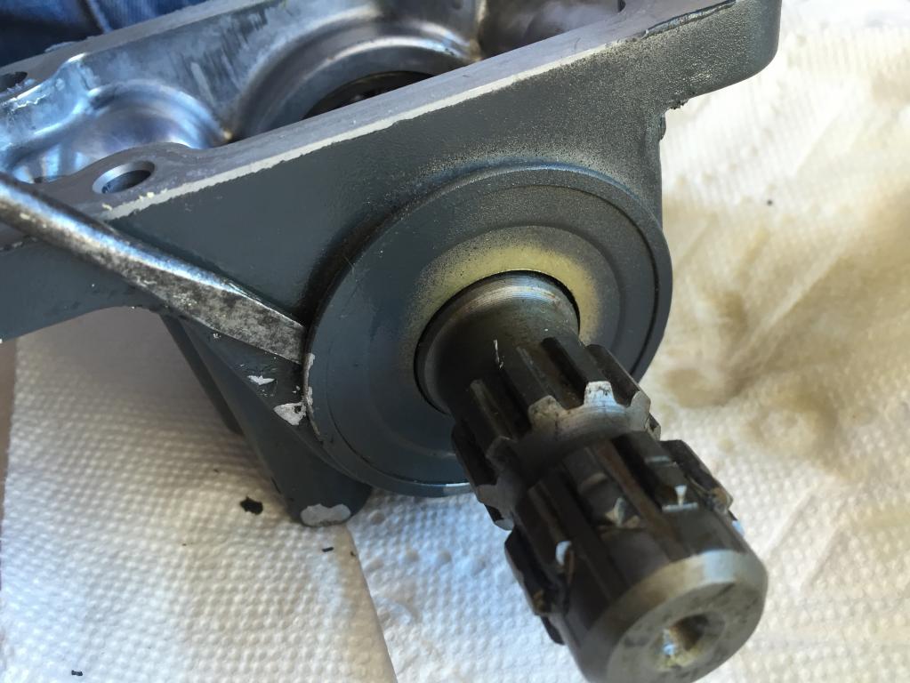

Once I pried the edge of the seal off, the ring came out simply with the pliers. I didn't know it sat inside a groove and that's how it worked. Once I did that the whole shaft came out with the bearings attached to it. I simply dropped it in the new case and it fit like a glove.
Ah well. They're picking it up tomorrow to check out both my problems. I'm not going to risk doing anything else.

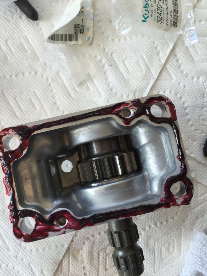

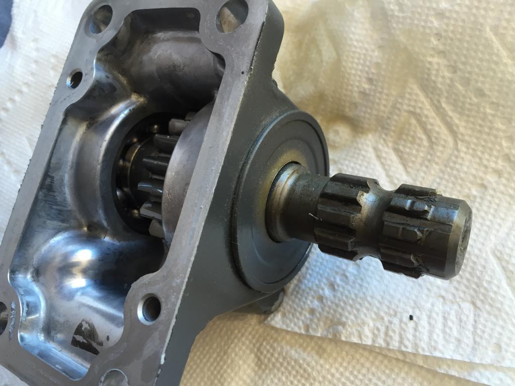

Picture number 2. Is that the old case? You can see the balls for the back bearing.

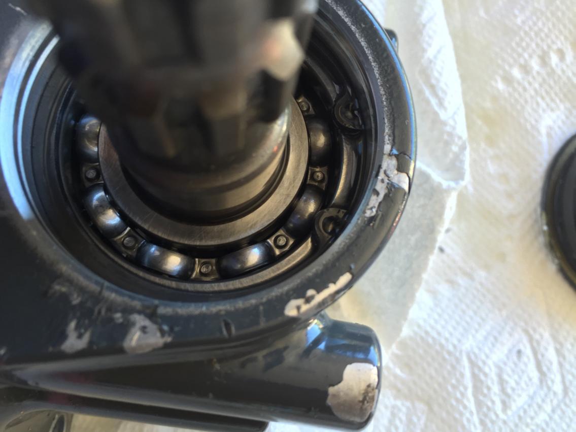

Picture number 5, looks like the back bearing is in a different location :confused:

#2 is the new case. You can see the nice threads where the bolt goes.
Here are 5 shots in succession of the old case as I took it apart.
I literally just picked it up and put it in the new case. I can't see how anything got misplaced. It stayed together as one piece and dripping with fluid. :confused:
It's too bad it didn't work out. Would have made a nice write up. I've got another 15 shots I didn't upload.
10,664
7,935
That's a pretty straight forward set up and design by the looks. Could be a manufacturing defect in the case. One of the bearings could be in a slight bind.
Please keep us informed as to what you find out :)

When you assembled the shaft and bearings in the new case, did you spin it by hand a few times? If yes, was it smooth - did you feel any roughness or did it feel like the bearing wanted to stop/rest in any one spot?
I did spin it. It felt smooth and clean. The oil was still churning around with it. I honestly thought I did a perfect job. I'll update when I get the word from the mechanics on both of my issues I had. I just hope they go easy on me with the bill. I'm praying it's a defect in the materials.

You probably did everything right.
Maybe the problem was already there and that's what caused the seal leak and required you to start the job in the first place.
