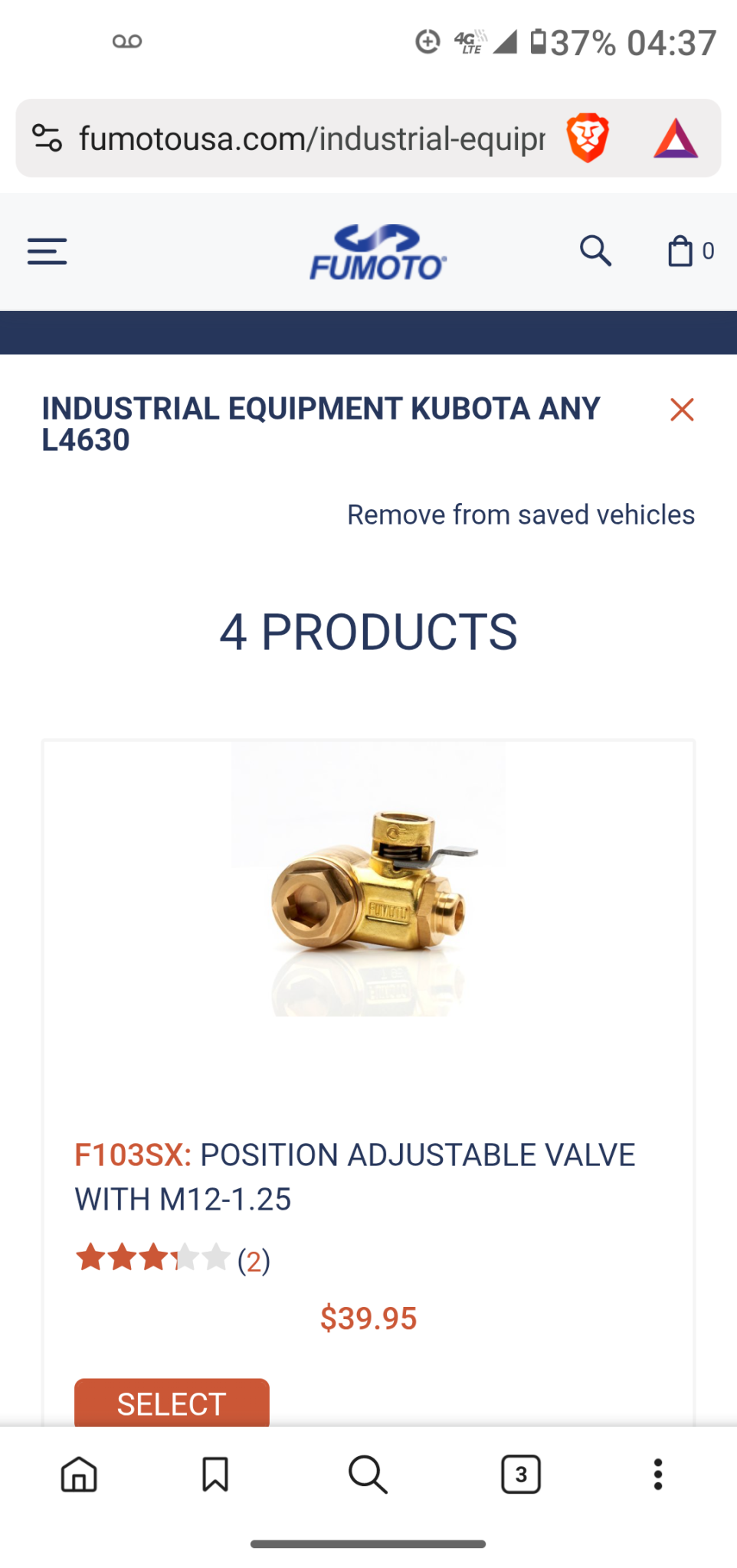

I'm wanting to add a https://www.fumotousa.com/ drain plug to my HST ... I haven't gotten my manuals yet for my recently acquired 2005 L5030 HSTC, but reading online it it takes just under 12 gallons, that's gotta be a big drain pan, and a bigger pain in the backside to empty ... So I want to add a drain valve and hook a hose to it so I can control the flow into a jug or bucket ...
Kubota part number is #15522 96010 but no reference to thread size ... Anyone know what the size is?
According to Fumoto a L4630 (which is same as mine but smaller engine) takes a M12 - 1.25 in the engine oil drain plug, I looked that model up, and it is Kubota part number #16427 33750, which mine also takes the same plug, and I figured I'd also put one in the oil pan ...
