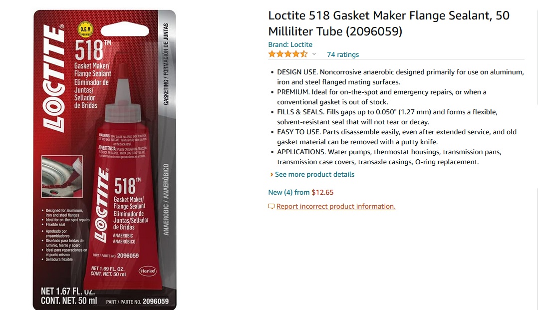

A comment on the teflon tape first. Remember the drain plug's seal is to the face of the transmission case. Teflon is used where the sealing parts are the tapered threads as in NPT. Drain plugs' threads are not tapered but straight like a nut and bolt.
I helped a skeptical friend with a 1982 Honda 450 today.
His drain hole was messed up and was re tapped but the new threads were not square with the crankcase so the drain plug did not seat flat on the aluminum. He tried every imaginable drain plug washer and gasket. People who suggest re tapping often fail to consider the difficulty of getting the new threads perfectly square with the crank case.
I gave him Loctite 518. An anerobic material. It only cures when there is no oxygen. He smeared too much on and after a day there was still a lot of goo around the plug. I had him wipe up the mess and fill the crankcase. Hours later not a drop. The 518 between the drain plug flange and the crankcase had cured.
Loctite from amazon
I first used in on a Seadoo jet pump and was impressed.
Do not put a washer or seal on the drain plug. Just clean, apply 518 to one surface and tighten.
Dave

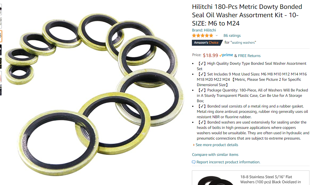

I would say if there are more clean threads in the housing a longer plug could be used. The other is instead of a crush washer use one of these. If neither of these work, you need to put a Heli coil in. They are not hard. Don't know what kind of tractor you have, but many have plates that come off so if you were afraid about the metal chips... you could work off tractor.
Just to make sure we are talking about the primary hydraulic/trans drain plug under the rear gearcase. If your talking about the one up closer to the engine, that is a split pin plug to drain fluid from the clutch housing. It can weep udt/trans fluid, or engine oil. This involves a split to repair either engine main, or 4wd propeller shaft seal.

Kubotafreak has made an interesting point in distinguishing the HST drain plug from the split-pin plug which is SUPPOSED to weep any fluid which accumulates. HOwever, the split pin plug is also not critical to seal tightly due to the nature of its’ job. So it is unlikely that is the case.
The think I believe important for Tractor Gal to consider is: If indeed it is the HST drain plug which is leaking...then it is IMPERATIVE that it be properly repaired. The last think you want is to be out working your tractor and have it come to a dead stop because that defective/loose drain plug fell out in the field.
I believe the BEST repair will be either a “Heli-Coil” insert and a soft copper or crush washer.... OR.... drilling out the hole and tapping for the next larger plug/bolt. Any machinist or mechanic with only average talent can do this “square” and not end up with the issue mentioned by Dave_eng.
AND DO NOT USE LOKTITE or any other “thread locker” on a drain plug. Those products are not “sealants” they are threaded-fastener-Locks....they do not work well with damaged threads anyway... and you must not find yourself prevented from using the drain-plug in the future. (Been there...done that.... when a service-shop Lok-Tited my drain plug on my truck without my permission. When I found out it was a nightmare getting them to pay for the repair which included complete replacement of the oil sump. On a tractor that may be tantamount to replacing the entire transmission/HST housing/casting and you certainly do not want to create that monster.)

I used it on my oil pan because the previous owner buggered the threads a little. If you do it right there is no danger of it "getting into" anything
