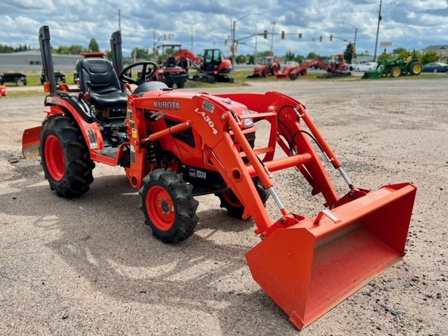

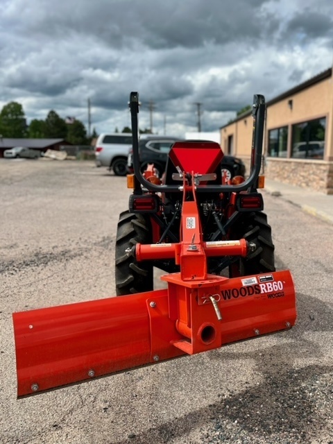

Howdy from Cheyenne, Wyoming. Considering the purchase of a 2012 Kubota B2320 from the local Kubota dealer. It has 93.8 hours on it, has HST transmission, LA304 loader, and a Woods RB60 rear blade. They are asking $16923 have not had the opportunity to speak to the salesman yet. I live six miles east of Cheyenne on 3 acres. Looking for something to maintain my gravel driveway and clear snow and do some dirt work to level an area for a pole barn. My driveway has a lot of grass and weeds growing in the gravel, would like to reconfigure it to a half circle style in the long run. Would the B2320 be up to the task? The dealership was closed today but went in and took a look at it and it looked pretty good and the tires were in great shape. Anything I should be looking at?

With that your going to wish you had different tires come winter.
Small R1's in snow are pretty worthless, and 100% worthless on ice.

Not big enough. I have a B2601 and always wish I’d purchased bigger.
Many thanks for the input. Till I get the pole barn built I would like to be able to park it in one stall of our two car garage. Did not have a tape measure with me but with the bucket sitting like it is in the picture I paced the length from the bucket to the back end of the rear blade at 14 foot if thats accurate it would fit on my big tex 35SA utility trailer that is 6.5 x 14 foot with a 1922 pound cargo capacity to bring her home and take it in to get serviced. What is the length of your B2601?

Would chains help? What tires would you recomend?
SmilingBob
R14 tires are the best with or without chains.
Turf tires and then turf tires with chains are really good.
Next would be R4's with chains, R4's alone are pretty bad.
R1's are ok in deep wet deep snow and yes chain help, but with small R1's there is limited chain options that work well because most chain designs fall between the lugs.
The down fall is you will have to get rims for any of the three other tires as they take wider smaller diameter rims.

I'd hate settle for a tractor that did not have a quick attach setup. Once you have one you'll wonder why you went so long without.
SmilingBob
Are you sure its only got a 1900lb capacity? That doesn't sound right, unless its a single 3500lb axle.
If that is indeed the case you will likely be over capacity. The tractor itself rolls in at just over 1400lbs DRY. I can't say for sure what the loader and back blade weight comes in at but I'd bet its well over the 500lbs you'd have left to work with. A quick google search says the back blades around 250lbs on its own.
Legally you're in the red. Technically mabey ok? It's close but I definitely wouldn't recommend it. I've seen trailers tweak right at capacity with a hard bump, plus the liability.

On the tractor itself it would be a no go if I were you. That's too much money for too many compromises. I would want a quick attach loader, and r14 tires (filled). Just those two changes your pretty much at the same money as a brand new B.

17 Grand for a 13-year-old tractor... I think it's high. But I don't keep up on used equipment prices, so take that with a grain of salt. I'd say buy new or new-er and get the R14 tires.
Or offer a LOT less than 17.

If it has a pin on bucket, it would be a hard pass for me. I wouldn’t buy a utility tractor that I couldn’t switch between bucket and forks.
So far as parking in a garage bay, sounds like a short term issue. If I fold the ROPs I can fit my L4701 in a garage bay with a 7’ high door. Not folded requires a 9’ door. Long term folding the ROPs would get old. Short term I’d put up with it for the long term payoff of a larger, more adequate machine moving up to a L with a SSQA on the loader.
As others have stated, the tires are wrong for your purposes. That’s a big deal as well because you’ll need to change rims to get the right tires and neither are cheap.
If you size limit based on your current trailer, you’ll end up with a tractor that’s too small. If all you’re planning to trailer it for is trips to/from dealer it may be more cost effective to have them move it. If you really want/need to be able to trailer it, get the right size tractor and then get the right size trailer to haul it.

If you are absolutely committed to the little undersized B2320, you should know that $16,923 is way over priced.
324.5 miles up the road from you (in Sheridan), there is a one year newer B2320 with 242 hours, listed on Tractorhouse, for $11,880 (it does not have the RB, but new RB's are sold everywhere....... IMHO the best attachments are made by Everything Attachments, in NC., with no tax and free shipping.)
The B2320 in Sheridan is $5043 LESS than your local dealer is trying to rip you off, for this 11 year old machine.
With no grading experience, your driveway maintenance is best done with a "land plane" rather than a RB.
I have owned multiple tractors, and multiple RB's for over 50 years.
A RB has a long learning curve,...... a land plane can be used/dragged by anyone.
The B2320 is the wrong size tractor for your needs, but you are obviously entitled to spend your $$$$ however you choose.
