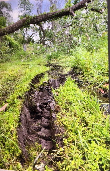

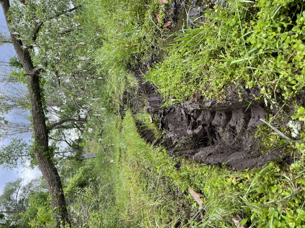

fishpick
BX24 & L4760HSTC
Dec 16, 2017
119
199
The High Taxes part of lovely NY, USA
dunno why it turns when I post it. But this was today to look at things. It’s just soup down there. No way I’m pulling on anything for a good long while.
also couldn’t get pics of the base and berm because my work boots would have given me wet feet as there’s about 4” of standing water to get back there…. Ohh. It’s raining now too.
Yeah, that is seriously wet and soft. Definitely wait until things improve.

re: picture taking on socallled 'smart' devices....
if you can, find the 'lock orientation' or whatever the phone OS calls it, in some 'settings' options. Once 'locked' phone will take normal pictures.
re: the 'project'... I'm thinking wait until mid winter ! That ground is seriously SOFT ,even if the tractor can drive on it (in ??) YOU can't safely get out of the way if the trunk spins fast towards you...
Looks like nice soil though !
