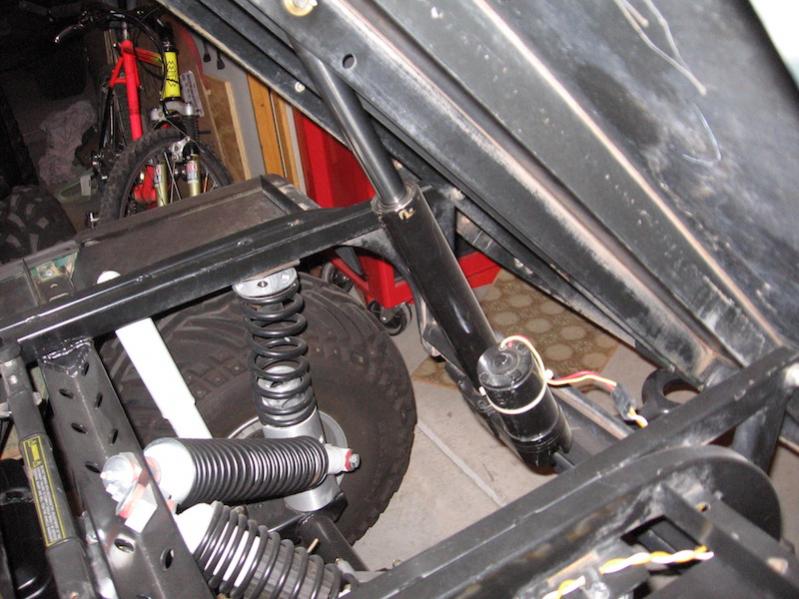

NIW's diagram is spot on. Used the same setup for the linear actuator that lifts the dump bed on Lil Foot. (not your grandpa's golf cart)
P.S. Yes, I know the coil spring is bent. Uncle in-law who has had the cart the last 11yrs severely overloaded it. Haven't had time to replace the coils yet.

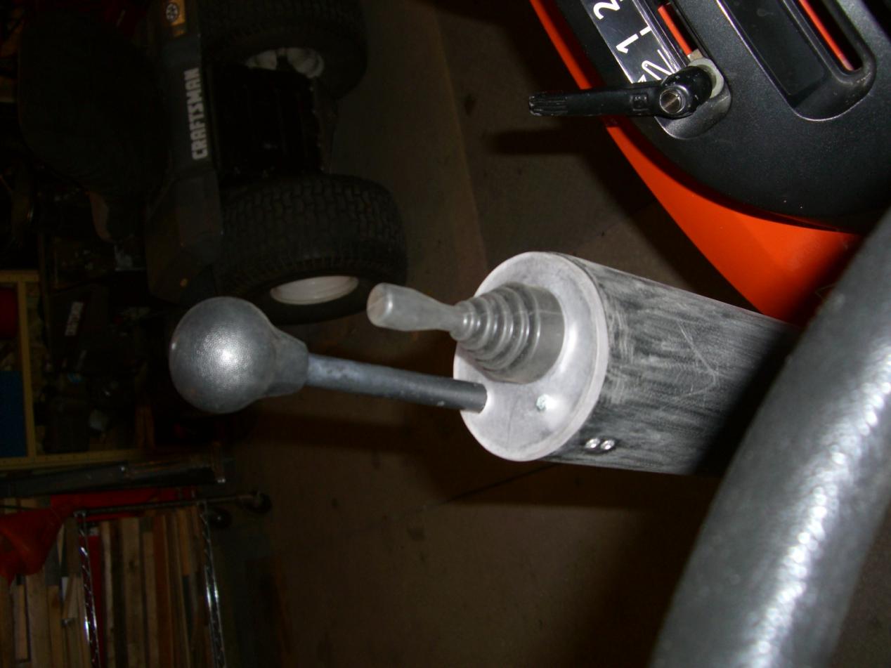

I was originally going to wire my actuator and rotator through 2 switches but in the end, liked the idea of a single joystick control.
It is a little more complex as each contact has to be wired through a switching relay, that makes 4 relays with a split feed via 2 fuses. As only 1 position can be powered at a time. I used a switched ground rather than a switched positive, that allowed me to only have to run 4 wires to the joystick and then group connect the other side to a frame ground.
4 top relays are for the joystick, bottom 2 are for LED ROPS lights, the fuse box is somewhat hidden at the very bottom.
Just a slight spin of the operator interface.
