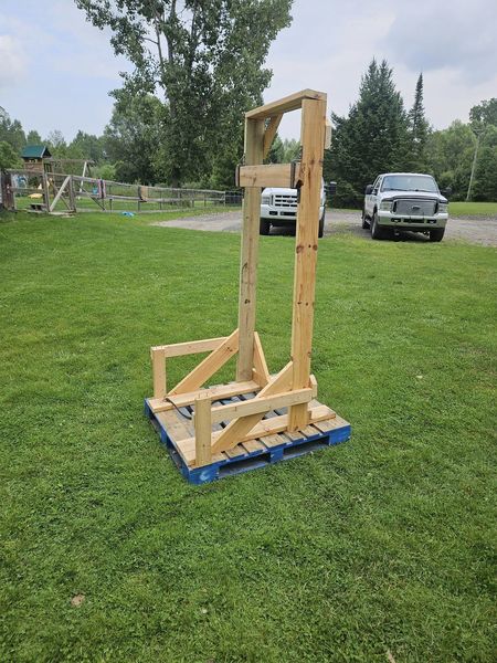

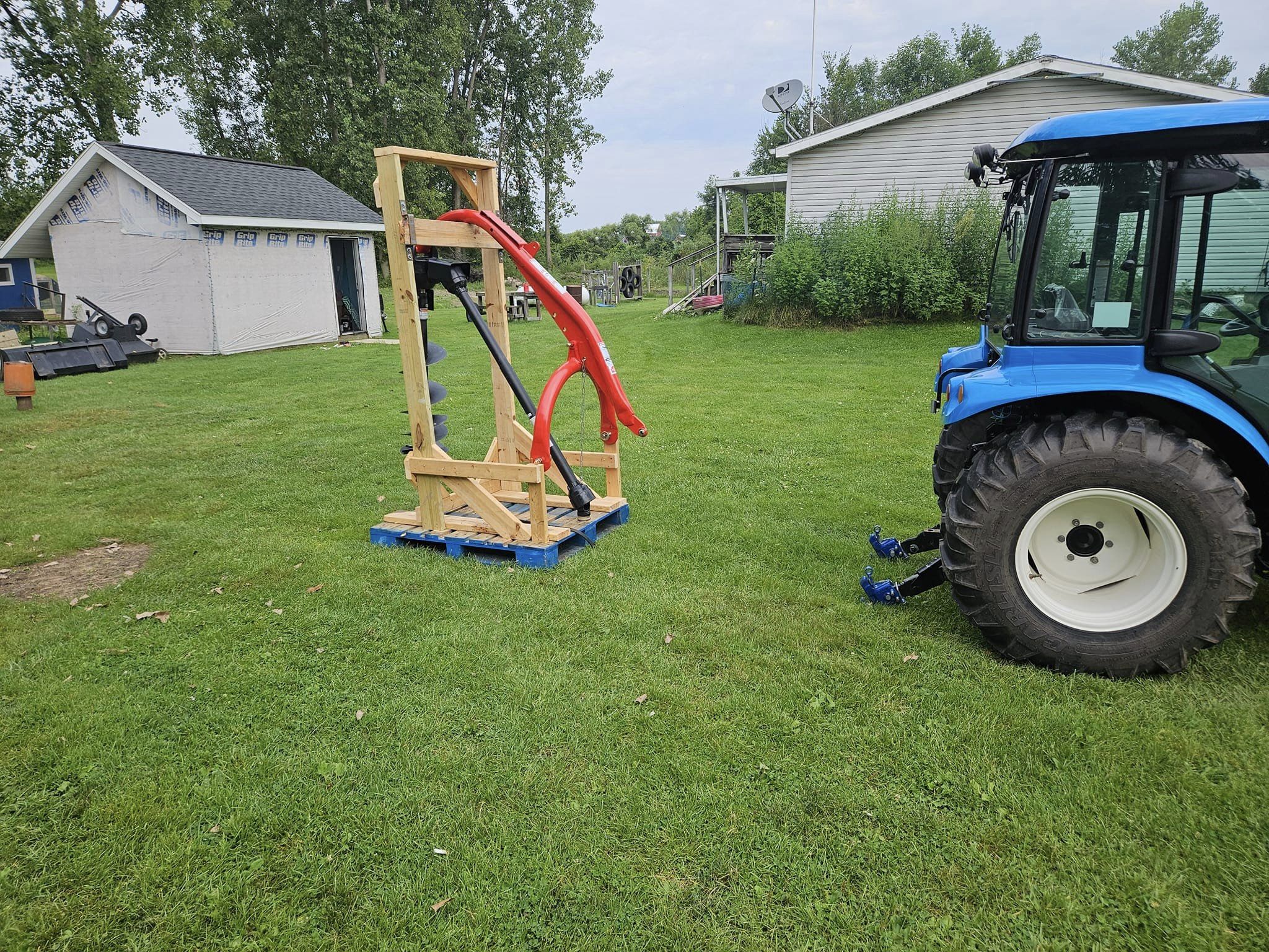

Saw this on another forum. Looks like a simple, inexpensive idea that would be really handy especially with anyone with forks. You can easily move the entire thing. Notice how the top cross piece slides in the metal brackets after the implements is backed up far enough.

I ratchet strap every thing together and lay it on pallet rack. That contraption looks like it might get a little top-heavy and tipsy as it's being moved around.

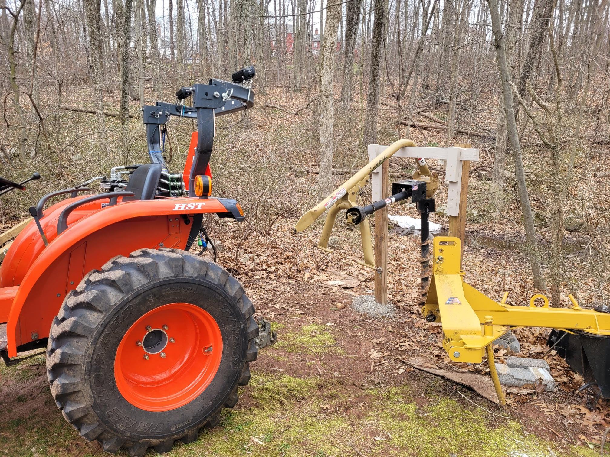

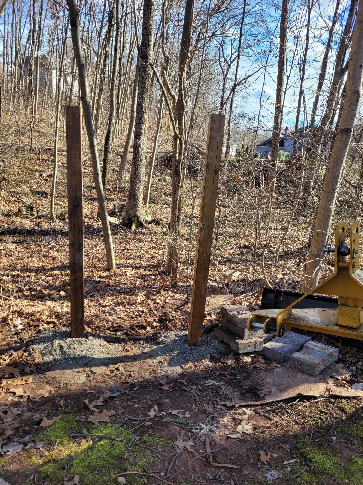

I made a simple 4X4 frame at the edge of the woods. Granted not mobile but simple and it works.
At the top of the 4X4's there is a bracket that a 2X4 slips into.
Just back into the space with 2X4 removed and phd high enough. Then slip in 2X4, lower phd onto it.
It made connecting / disconnecting a lot easier
But then how do you lift it into position and mount it on the tractor, especially if you are by yourself?
I use fel to lift it down from pallet rack,carry to a tree limb and suspend with a chain or strap. When I finish I have to use limb to remove from tractor, strap it together and back to pallet rack.

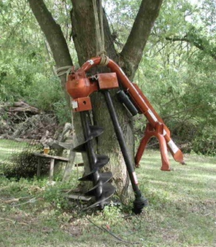

this way used to work for me…🤣
Hey don’t knock it—I just have a bftree, a straight one, I just ratchet strap it after backing up against it with auger vertical and then unhook the 3 pt and pto and drop both in 5 gallon buckets with holes drilled in them to drain water.
Mine is old and very heavy hence the bft…

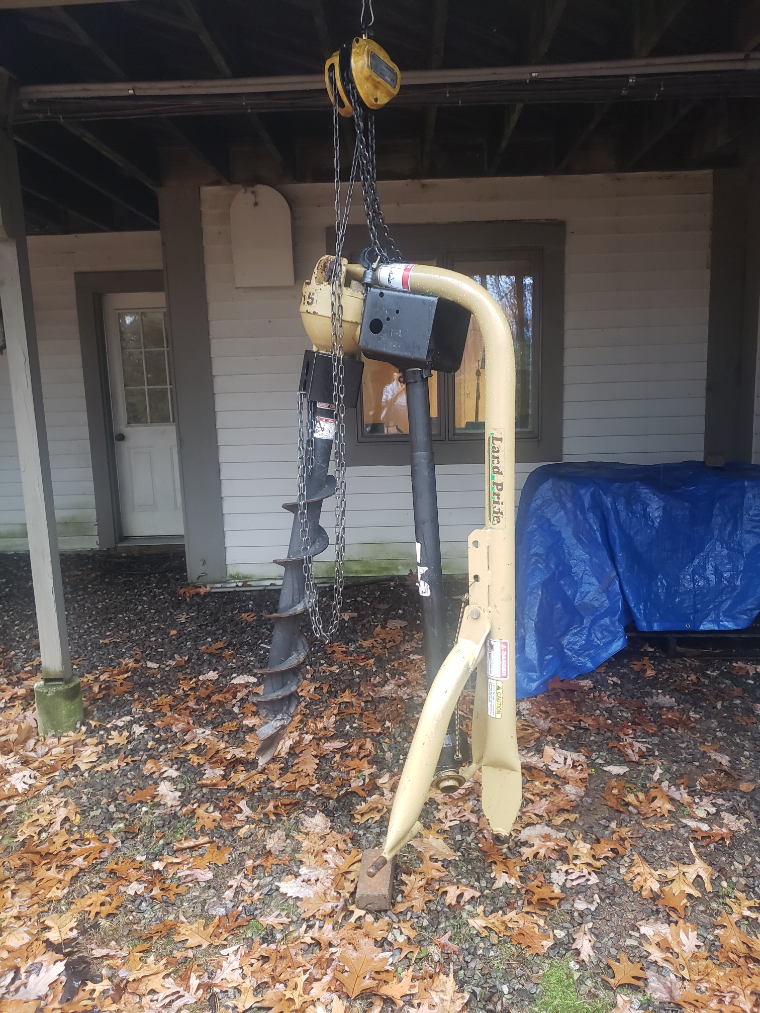

At our old house I did a similar 'hanging'. I was lucky, our deck was 10' off the ground.
