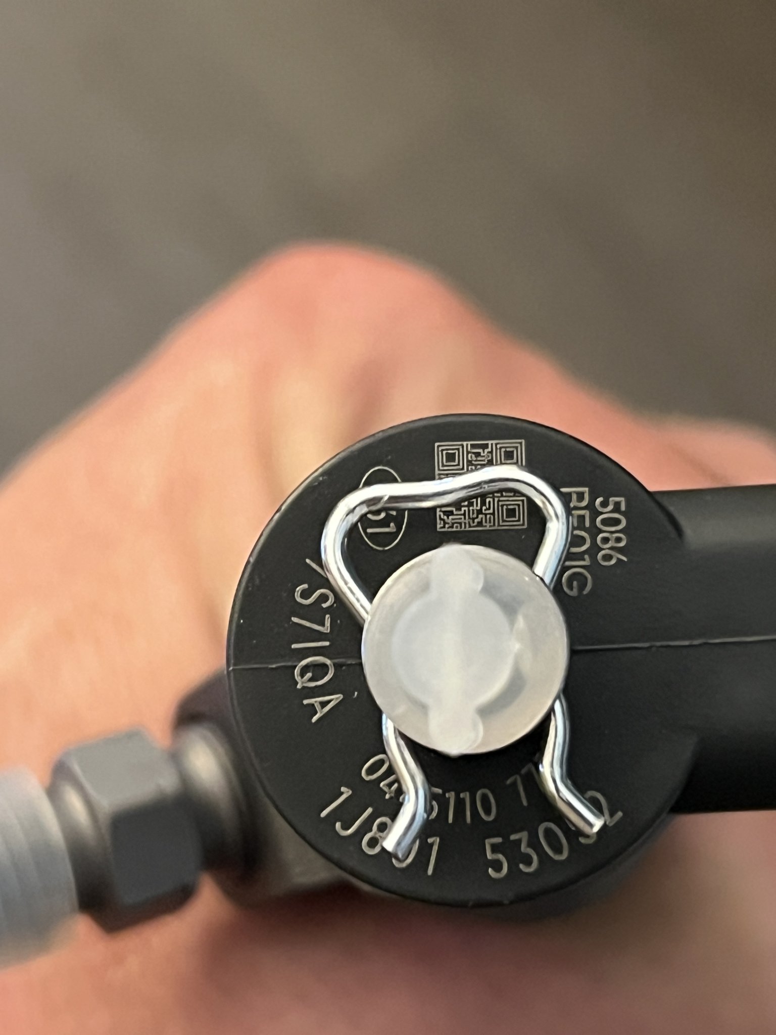

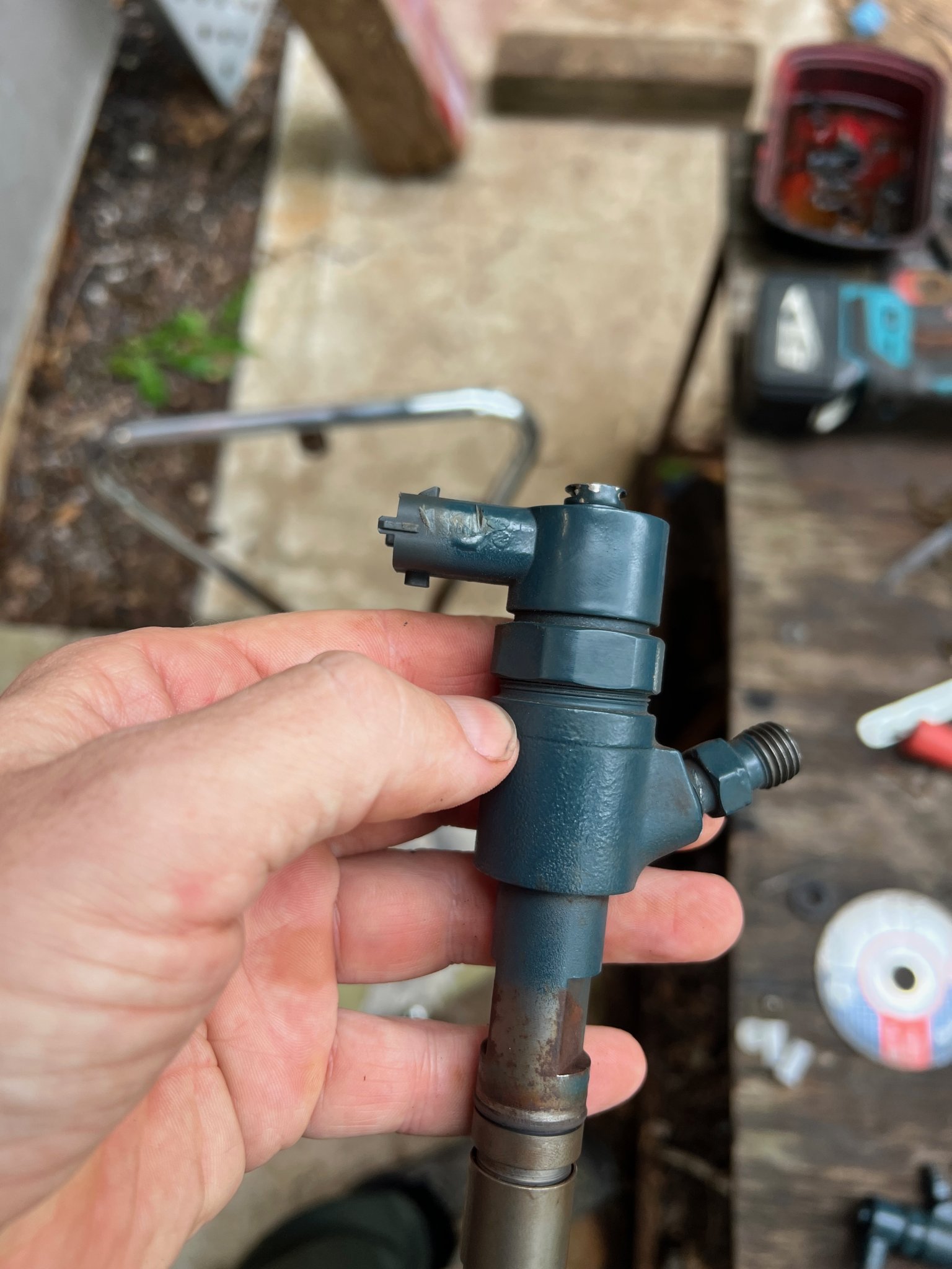

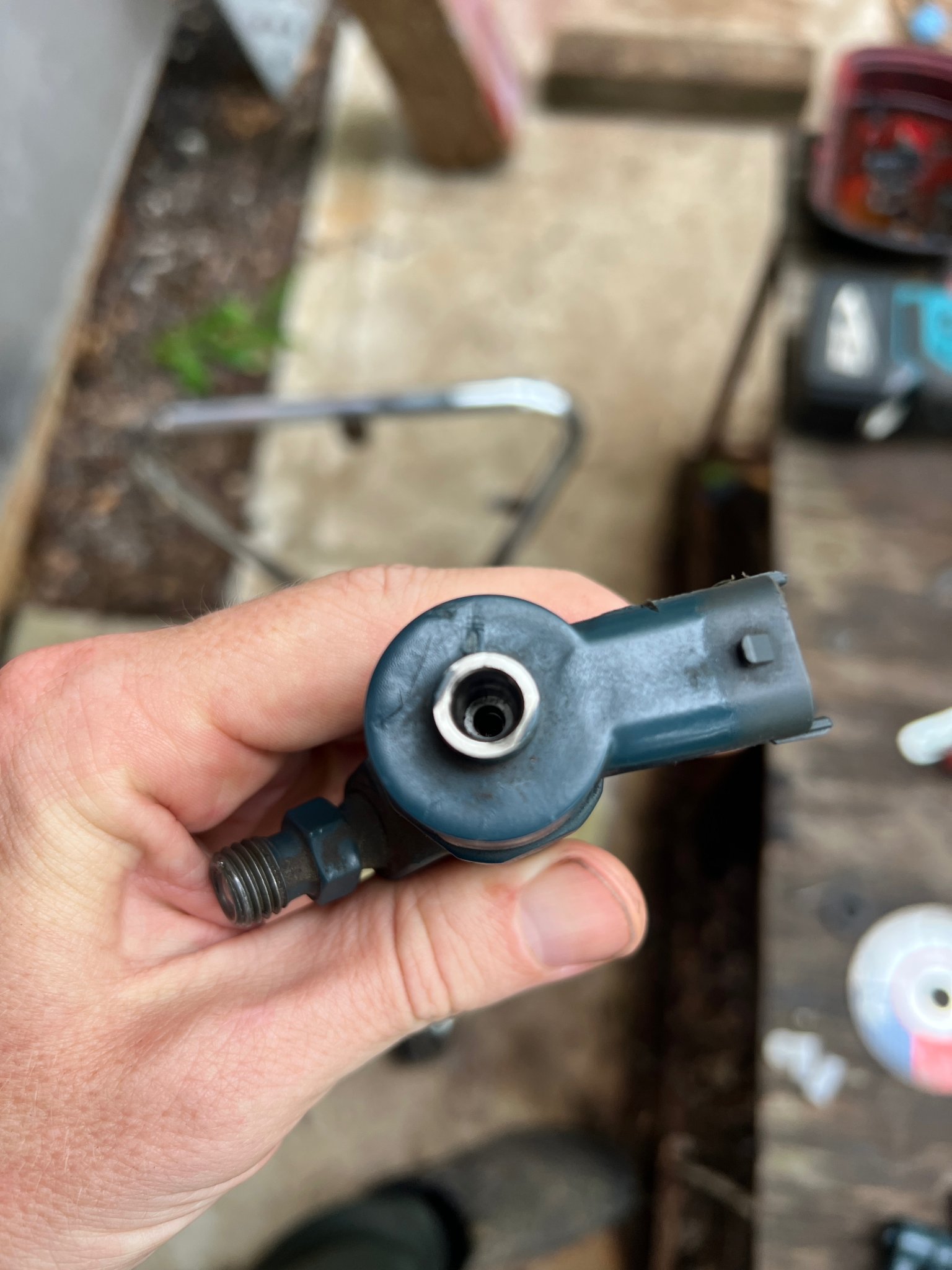

Well, here are the culprits. I don't see any markings on these injectors and they are the original ones. However, you can clearly see why the engine struggled to start. All three were pretty fouled up but the machine does have 23xx hours on it.
The new injectors from amazon did the trick. Machine started right up and goes up and down in RPM just like it supposed. Stable idle and full throttle. Replacing them was about 3 hour job but this is the first time I did it, so if I have to do it next time, it will likely be more like an hour.

Well based on the paint on the Injectors the engine was a cheap rebuilt or Junk yard recycle replacement.
Cheap or junk yard units get spray painted and cover all the original markings.
