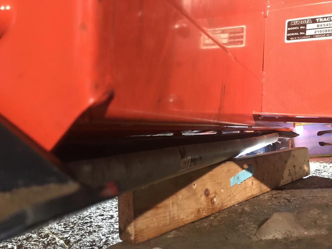

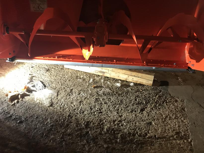

I cut a 1/2" slit lengthwise in a 2"EMT Pipe to allow me to put a bolt up through the inside of the pipe through the outside of my snow blowers cutting edge mounting holes. I've read where people are welding on pipes but i can't weld and prefer to not permanently change anything on the tractor until i know it will work.
So far I have used it with as much as 18" of snow and as little as a couple inches, it leaves a little snow behind but acts like a squeegee and doesn't seem to sink in like the skid shoes did. since putting the pipe on i use it in float position all the time. This is my first tractor so still learning from all the great posts on this forum.

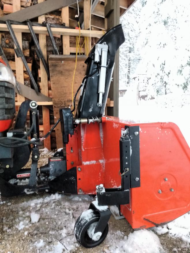

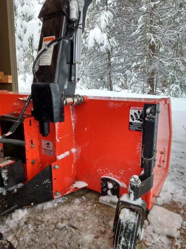

Here are the castor wheels that are on my front snowblower. They serve double duty for the snowblower and the sweeper that they came with. Both skid shoes and castor wheels are used and both are adjustable for height. The 500 ft laneway is all gravel and so far this year no shear pins have given up their lives.

What brand is that snowblower? The wheels and support look like they'd mount on any blower.

Maybe I asked the wrong question, so if one wanted the wheels and bracket only I should look in the parts list for the blower or the sweeper? Does it look to you as if easy to put on another blower?

The gauge wheels came with the BX2537 sweeper that was part of the package deal when I bought my BX23. I'm not sure if this is a sweeper add on or if it is a standard part. The mounting hardware to bolt the wheel and shank to the BX2750 snowblower was custom made to fit the blower but is very similar to the hardware that is still on the sweeper. This allows one to swap the wheels back and forth as needed.
