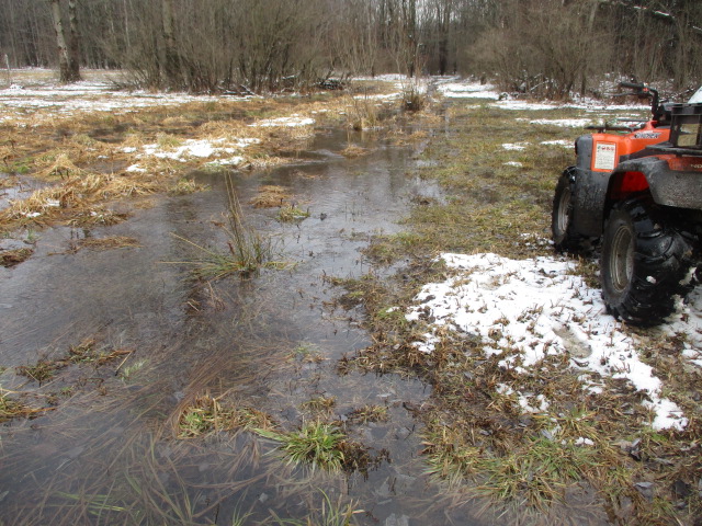

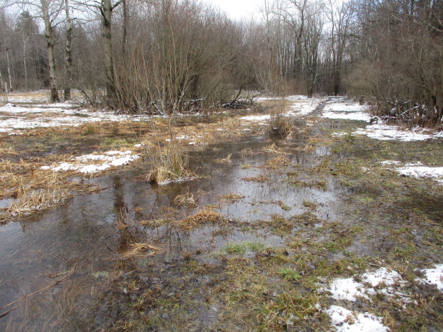

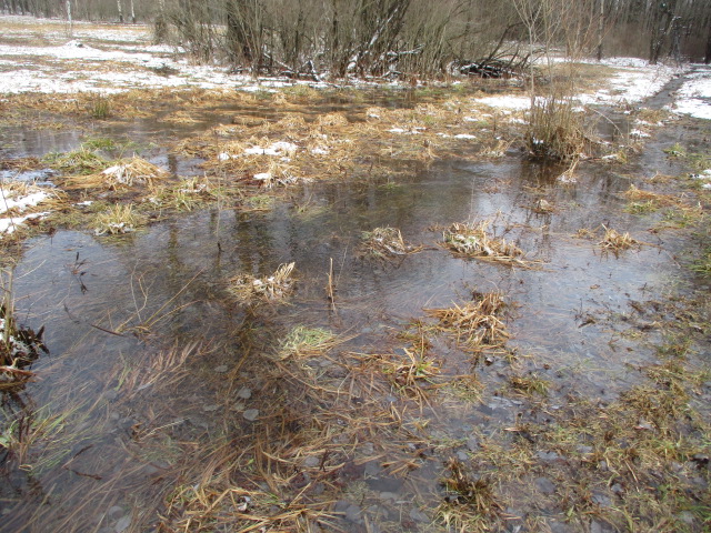

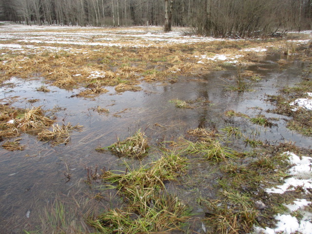

One of my projects for this summer is to put a culvert pipe in this ditch / low area and make it where i can drive my tractor across it.
It's not really a fast flowing ditch, but the whole low area is real soft.... even in the summer.
I want to put the culvert in, basically right where the 4 wheeler is.
But.... not sure what diameter I can get away with so it won't wash out.
Any input on sizing is appreciated...!

But just from his pic's it looks like it would take a lot of fill to get a 2 foot culvert in and a foot of cover.
Also a 2 foot pipe is $1000 give or take, and a 12" is $300 give or take, so I'll deal with cleaning out the opening a few times to make up for that.
This is all based on being a secondary temporary use drive.
