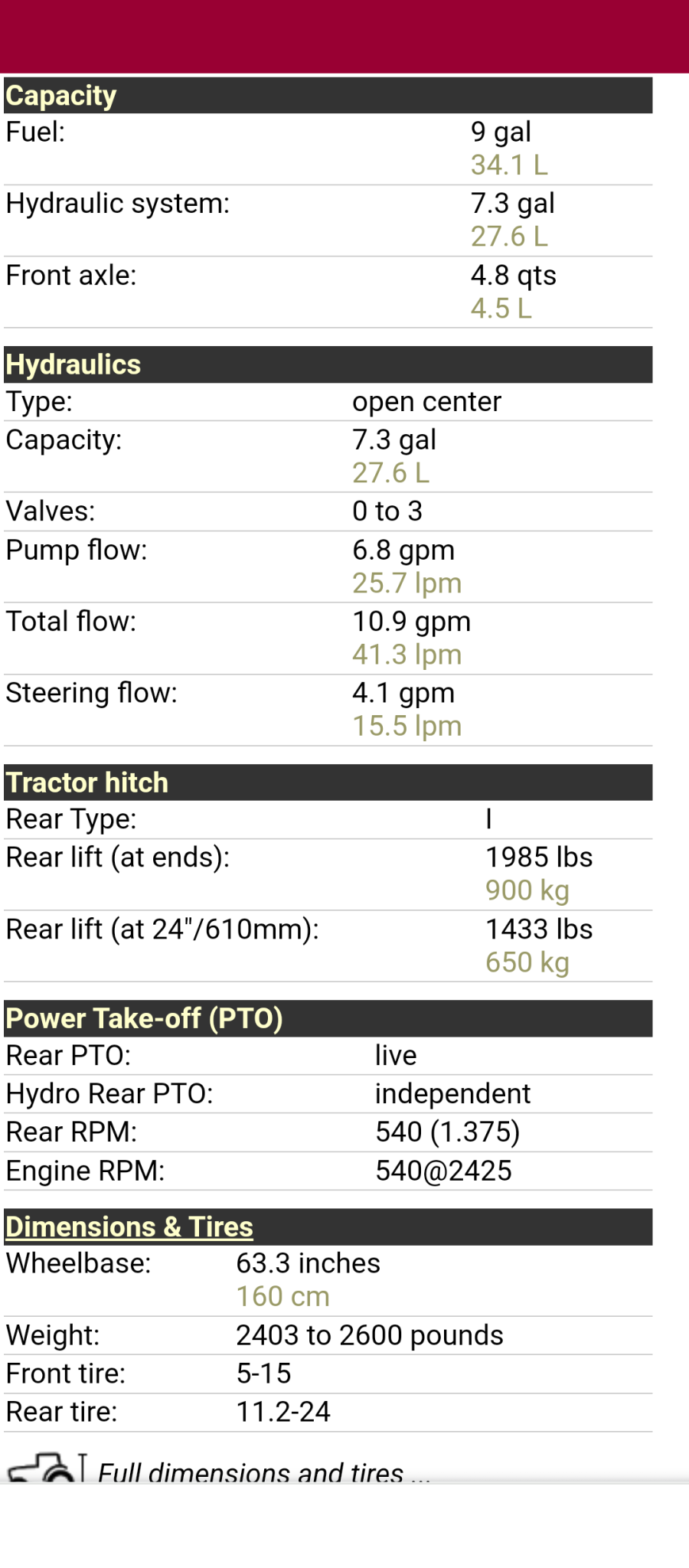

Curious about function: does it tie into existing flow system or would you need separate controls like a 3rd function?
Once I finish the heavy work I need to do, and only maintenance requirements are needed, I'll probably sell the Bobcat and maintain with my L3400DM, which an attachment like you've linked to might be a long term solution.
mine does not tie in. A completely different system, pto powered with its own valving.
my live 26hp @ pto runs a 20pgm pump fine.

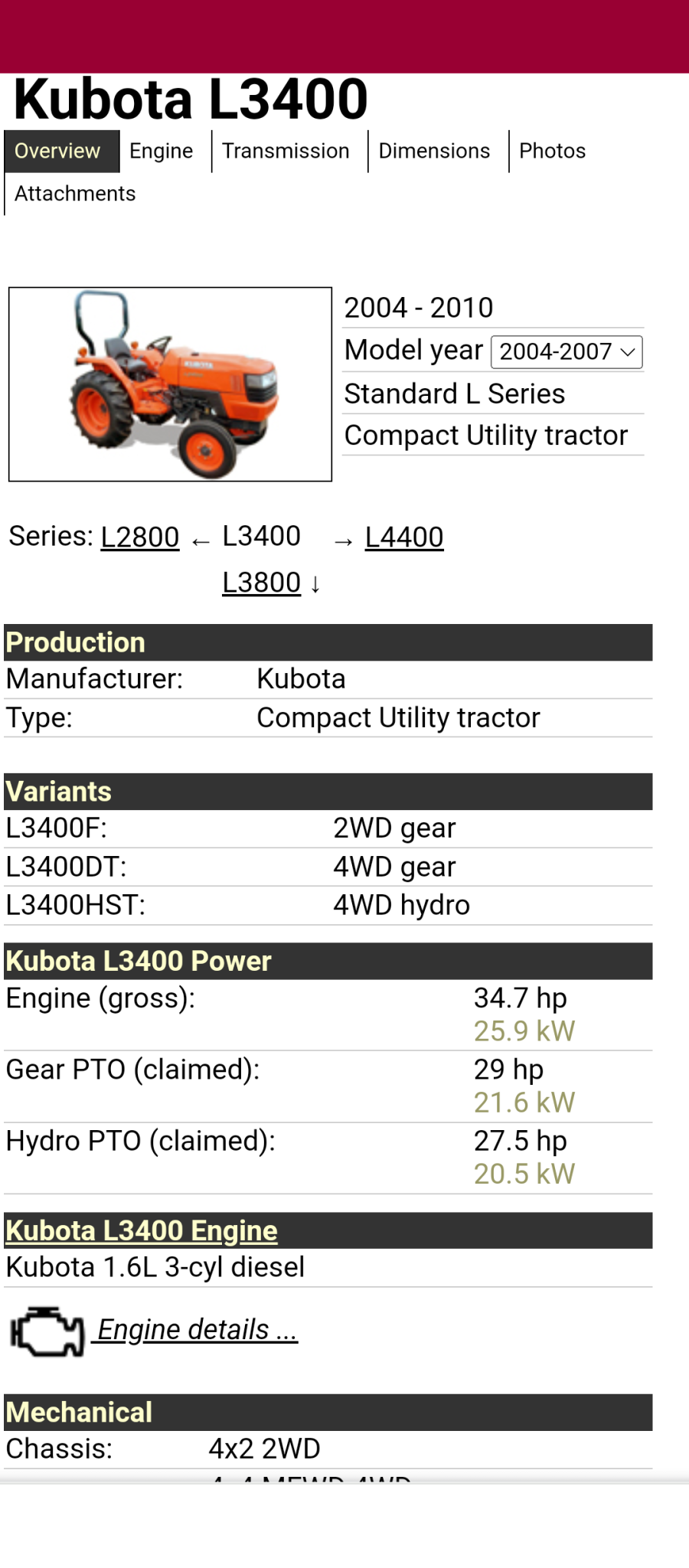

Mine being 29hp @ probably means I'll have to do some more research.
Thanks for that input.
