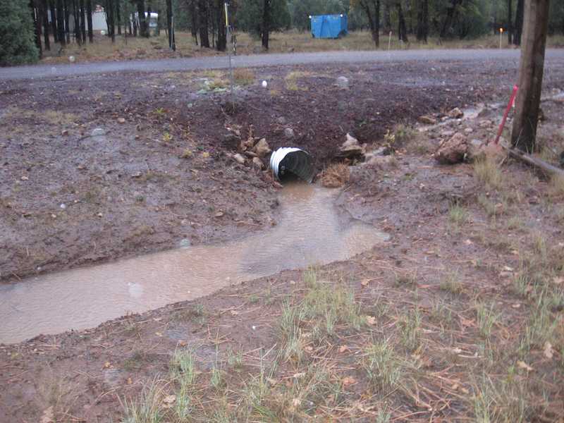

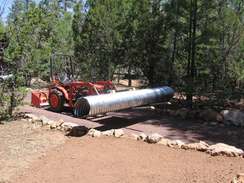

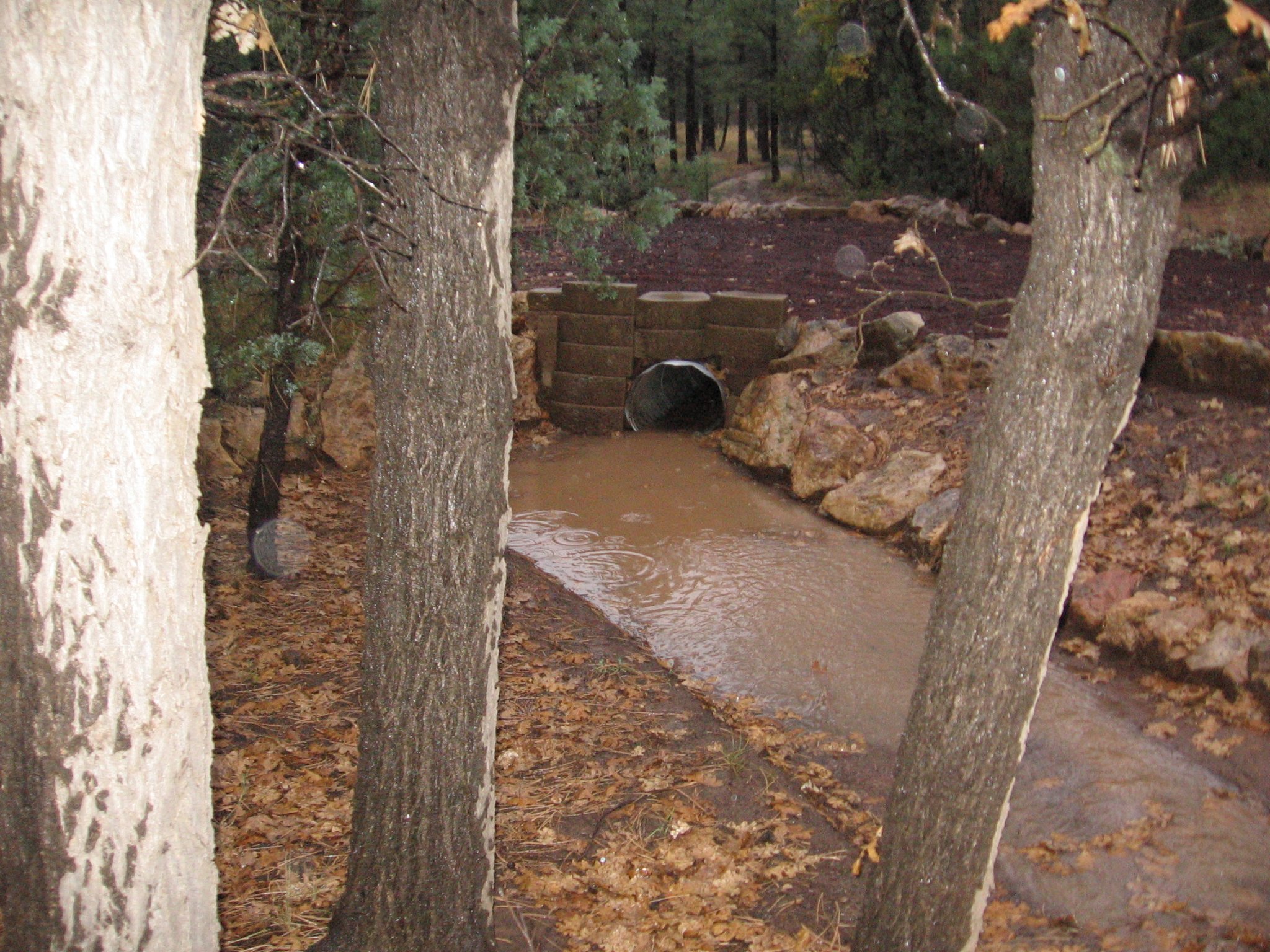

I used 25' of steel 17" x 24". (pic shows one 12 1/2' section)
(they put a 20" in a big press & squash it)
But my ground is a LOT drier out here.
jyoutz
Jan 14, 2019
3,601
2,705
Edgewood, New Mexico
Nice job. A couple of differences from the op: your ditch is narrow, not a wide swale. And you did a nice job constructing headwalls and using sufficient fill. It looks perfect for your application.

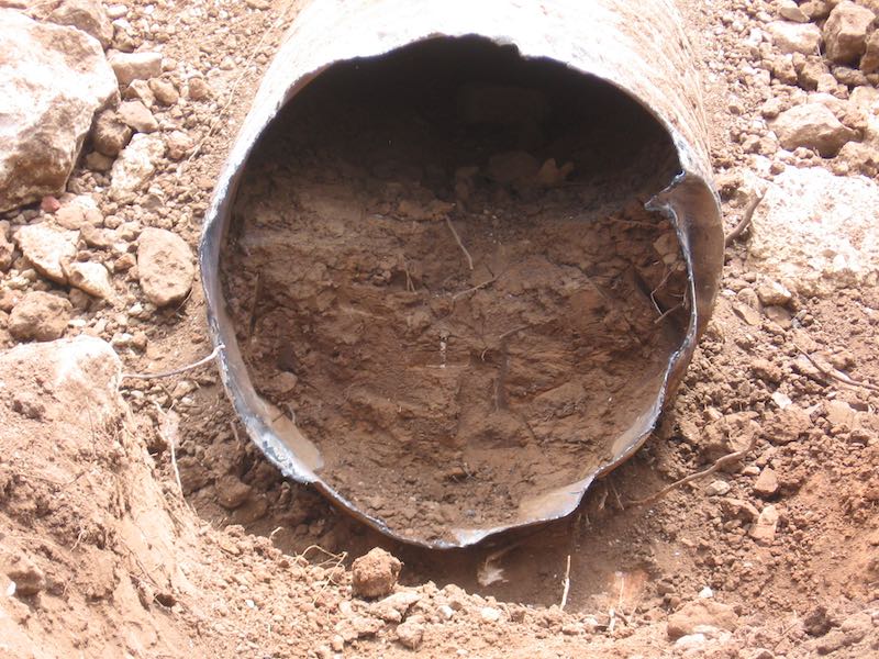

Pics below are before & after of the county culvert (16") that dumps onto my property. It had plugged up due to a 3" phone trunk line that had been trenched thru and laid into it. The county dug it up, cut off the culvert, had the phone company splice a new line under it, and tacked on a new section of culvert. The "plug" was full length, 40+ feet, and hard as concrete. You can see the pick/mattock marks that I chopped into it.
County was unconcerned, they said it would wash out.
It finally washed clean, but it took about 2 years, or 2 monsoon seasons.
I guarantee if you tried the above method to clear it, the culvert would pull out of the road bed before the plug would come out.
