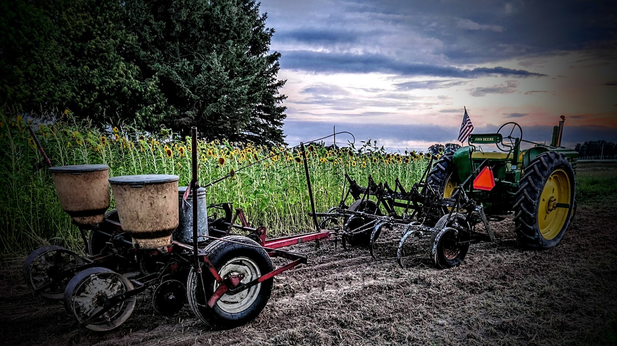

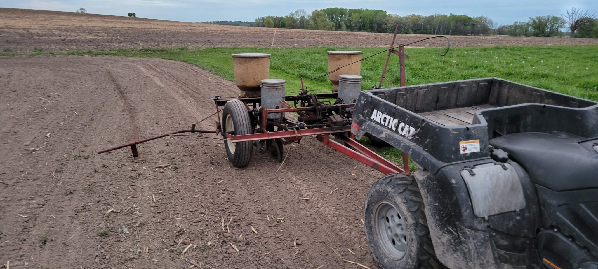

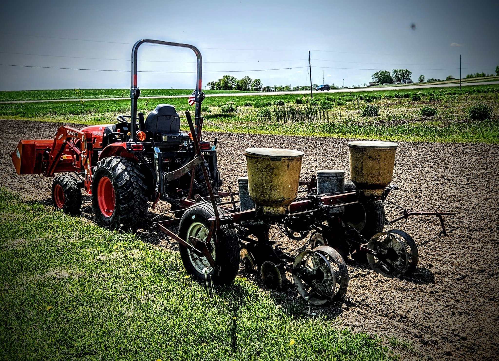

Lots of options for planters. I use to broad cast my food plots and drag them in but wanted rows. I was looking for 2 years. People are asking crazy prices for something steel wheeled/horse drawn in the weeds......almost 500 to 800 dollars. Most of those planters need seed plates and very hard to find them......most oringal cast irons are bought up at flea marks for 5x the price to make artsy flowers. You can order some plastic ones too depending on the brand. I was lucky enough to trade a hay wagon for my planter. It's a trip planter and bought it when the atv was my main tool.
It's from 1950 but well cared for. Being ground driven/trip biggest down fall is if the gear box breaks you might as well scrap it.
If you have rear hydraulics you could find a 4 row at autions pretty cheap.......maybe cheaper than ground driven. Hydraulics would give you more down pressure. You could take a 4 to 6 row and make a 1 or 2 row and make another one to sell. See a lot of guys doing that and selling them for 1200 + doubling their money.
Biggest thing is with a ground driven that everything is loose and greased, and plants are available.
For newer hydraulic types that are usually plateless cost depends on pumps and monitors included.
I really like my 2 row ground driven. I can hook whatever I want to it.

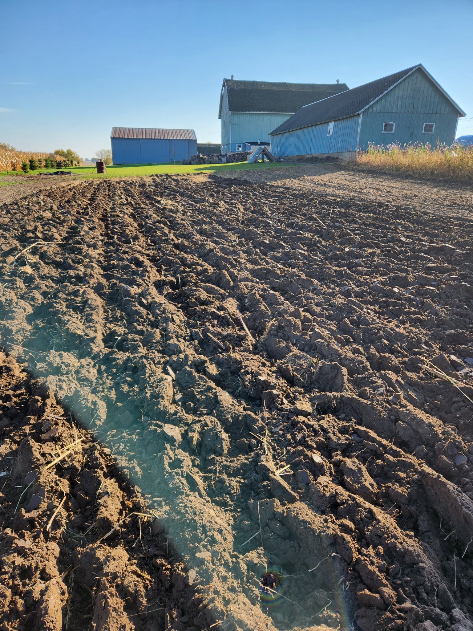

Sort of progress(but not really)…I finally brought plow to place up North where I hope to use in a few months) and off loaded it. (I am regretting not putting some oil on the shiney parts 😢)

Only time will tell…I picked this up a few weeks back and just this past week dropped it off up there. Our place up there is in the area where the lake deposits and the ridge moraine meet.

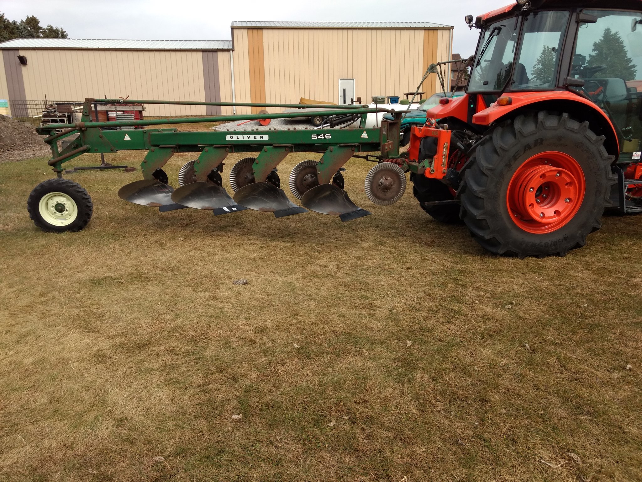

Good day. I am considering buying a plow for MX. I’ve not owned/pulled one myself (purpose is to turn over a pasture that has been left to grass for recent past (more than 20 yrs). I’ve seen older threads on thoughts on tractor size and weight and transmission but nothing overly convincing me one way or another whether an MX or L can pull a three bottom plow. How to decide? Thoughts? Soil according to the ODNR is finer loamy soils but in patches there is some clay. (Area is far upper NE corner of Ohio). Any thoughts from those that have pulled a plow before or better yet experience with an Mx or L? Any suggestion or advice would be appreciated. Thanks.
My M5-091 handles an Oliver 546 4-16s quite well. I found this plow for sale and it was stored indoors with the moldboards greased, a little pressure washing and off to the field.

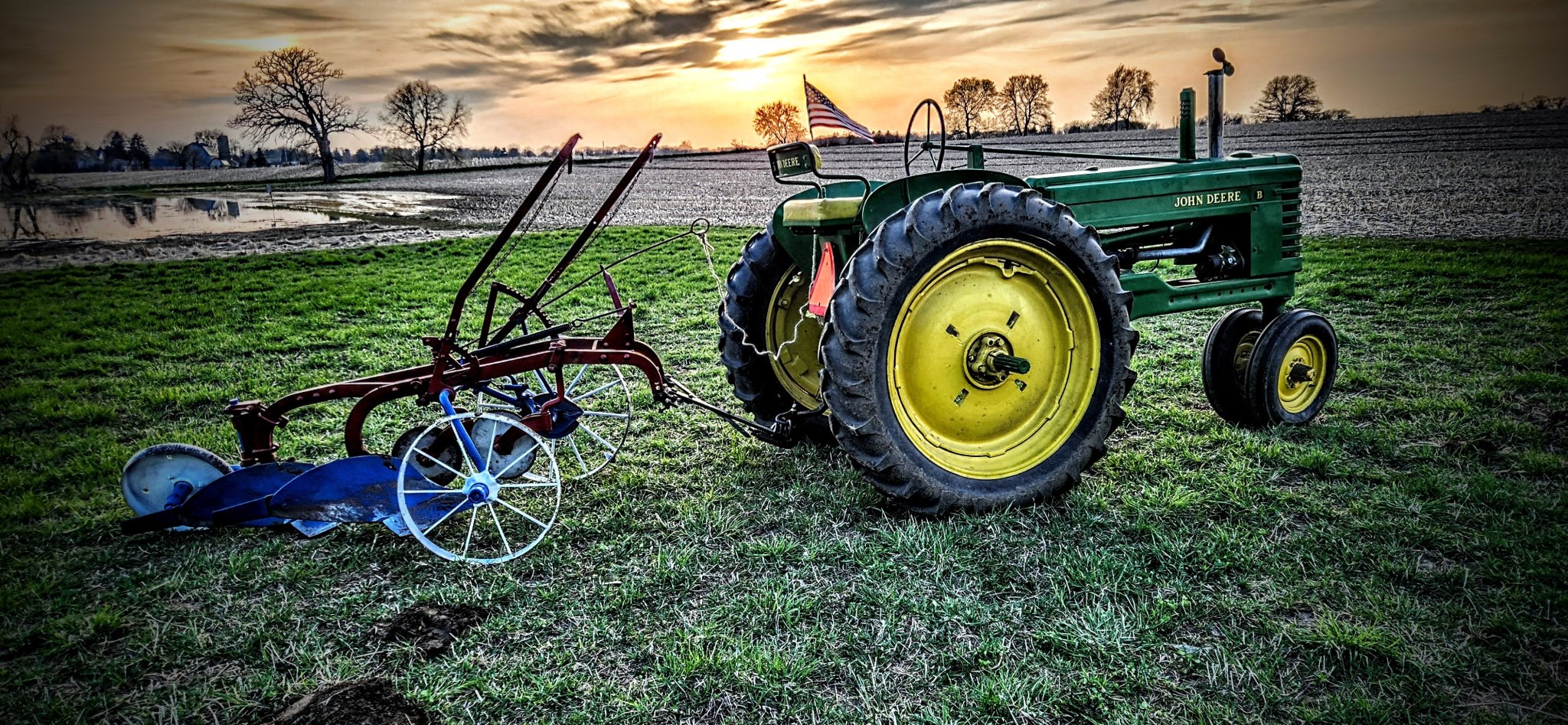

They say and I dont know, just where but I have heard of small pieces of gold found in those deposits. That is a nice plow maybe to nice to use,, lol
How I felt about my plow aftee I repainted it, but it was meant to be used.

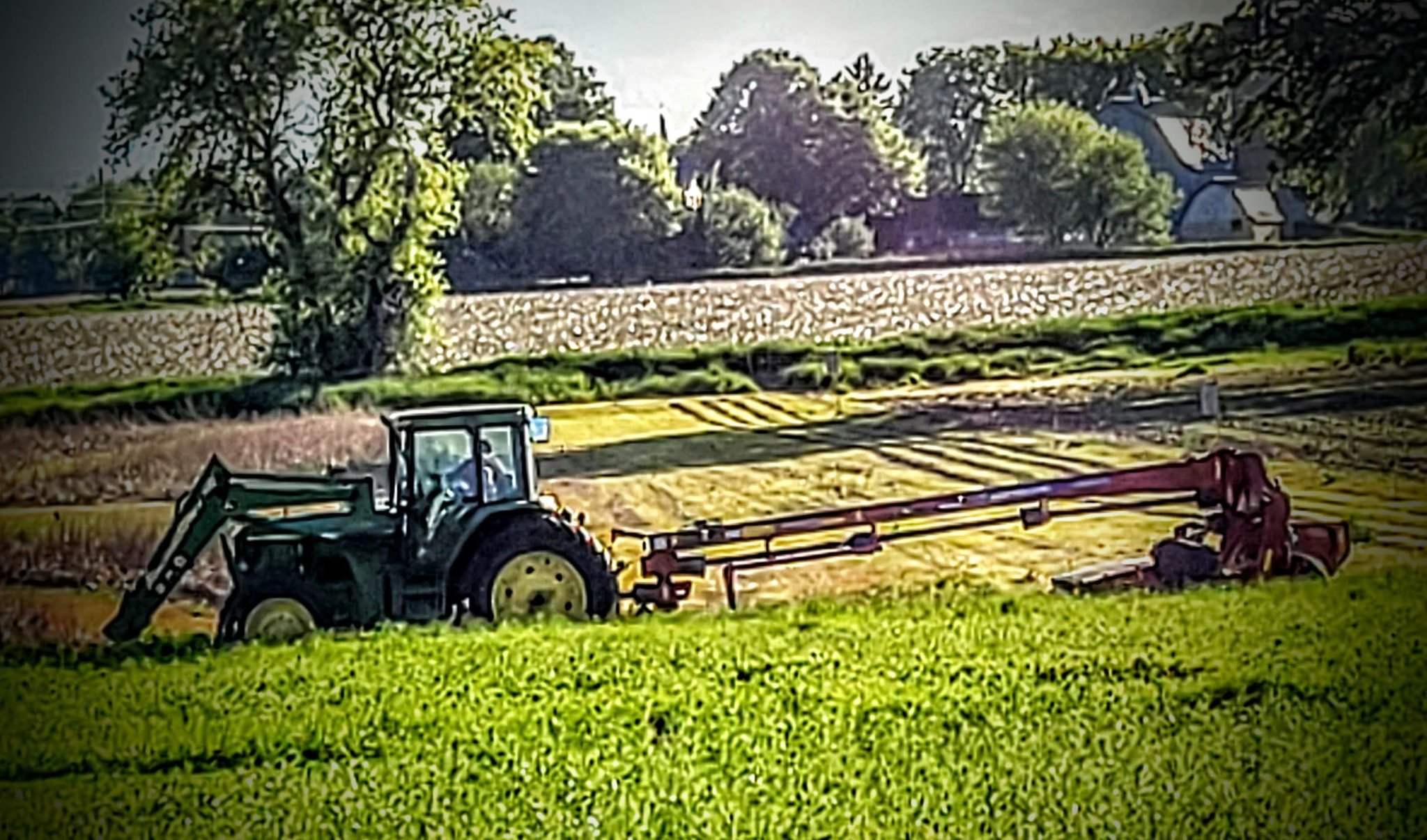

Starting out on my little farm I hired a neighbor to cut and bale my 2 acres of hay. A gift card to take his wife on a date, a bottle of jack or free labor went a long way. Unfortunately I was at the mercy of his time.....which meant his hay was #1 and mine sat, and or got rained on, or he'd be out in my field after chores late at night keeping my family up. His equipment was too big for my field and you could tell he was getting annoyed not being able to turn his equipment around decently .
I decided to gamble on older equipment than to lose a good neighbor/friend out of the ordeal.
