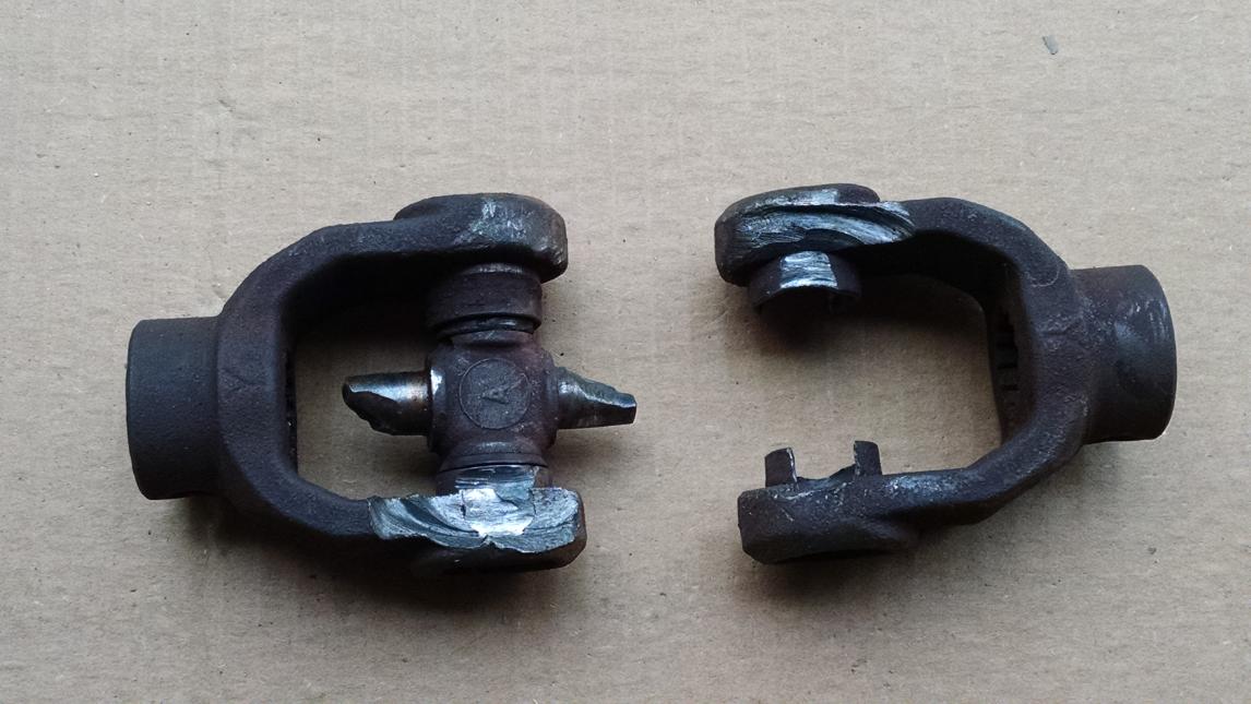

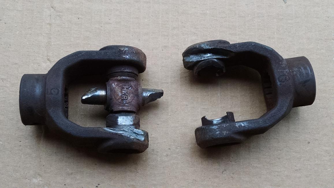

I had the bucket full of gravel and made a sharp turn to where I needed to dump it, and that's when I heard something break, then the tranny started binding up. I used the loader to raise the front wheels of the ground because I thought I must have broken a bevel gear. Thank goodness it was just the universal joint. I didn't know how bad it was till I got it back to my shop and pulled the yokes off. It looks like it been wore out for quite awhile. New yokes and joint are ordered, and should be in by the time I get back home from vacation.

WOW lucky you:eek: It doesn't take long once they start to go south, and at least on my BX theres no grease fittings, and for some reason that bothers me

There wasn't a grease fitting on mine either. I've put a little over 100 hours on her since I bought her, and about half of those was in 4x4. I hope the new joint last as long as the original :)

get some synthetic grease on the new one - pack the 'ell out of it ..........that is one worn out uni !!!! I had to repair one in the driveway on a sunday - needle bearing by needle bearing so that a buddy of mine could make the 200 mile trip back home......
