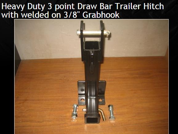

That's not really a complete 3 point implement.
It appears that the two holes at the bottom are designed to bolt to a standard drawbar that fits between your lower links. The cross hole at the top would be for your top link to pin to.
You can pick up the drawbar at a Tractor Supply or similar Ag store.

Thanks for the picture and the help. It makes makes sense after seeing the picture.
