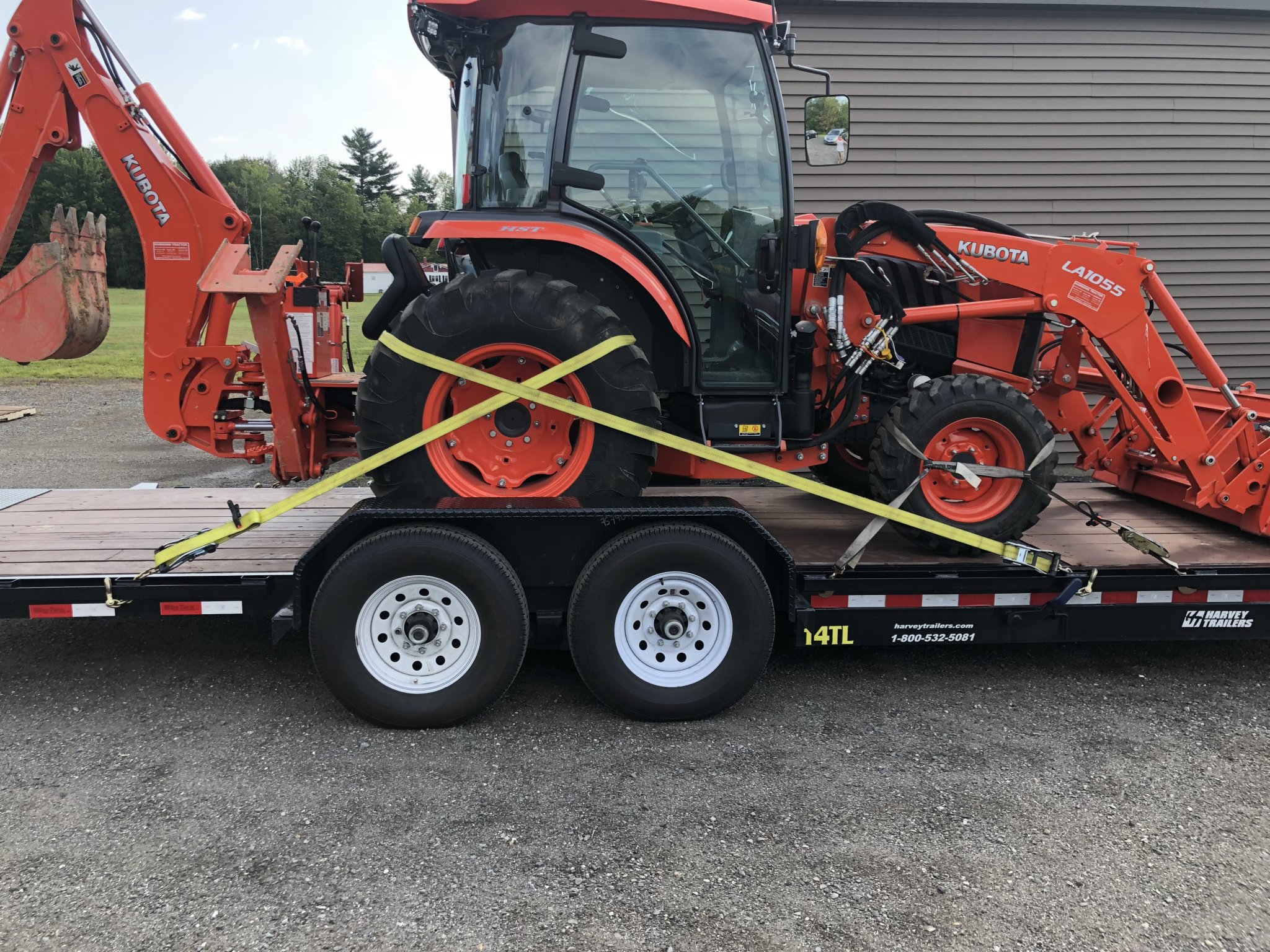

I use straps also. No nicks or chips and all 4 corners are strapped to the trailer. Each strap has a 10000 lb load rating. I also agree that if there is any chance a strap will get on a surface that will chafe or cut, a chain is the way to go.
A 2 inch ratchet strap has a Working Load Limit of 3,333 pounds. When used on one side of the trailer it is 3,333/2 = 1667 pounds. The wheel lasso, 3,333 WLL, should be used to form a "y" over the center of the tire. The extra strap may be the weakest link thus reduce the WLL. The buckets are required to be lowered to the deck with a strap or chain to secure them.
After saying the above you will probably be able to transport the tractor without any problems.
I thought about using the y over the center, but I believe I get a little more front to back stability from hooking in front and in back of the tire. I use a ratchet on both ends of the strap. I tried it with only 1 ratchet, but it left the opposite end of the strap slightly loose. When I ratcheting the tires down (with 2 ratchets) you can see the tire squat into the trailer. I did know that legally all buckets and attachments need to be lowered to the trailer and strapped or chained down.
