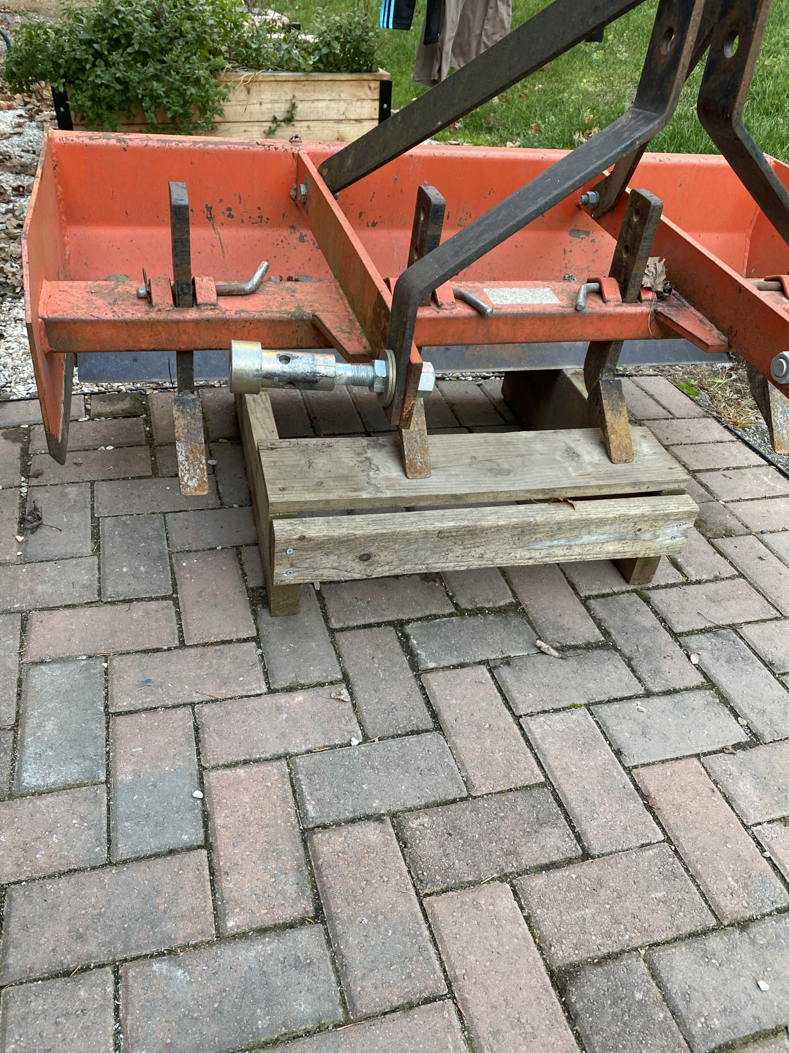

I made a small box with 2x10 sides and a couple 1X cross pieces.
If I think I’ll send a picture later.
10,193
7,089
i lied -2x8. Just some scrap kicking around and smaller than a pallet.

Looks good, may have to make one this week.

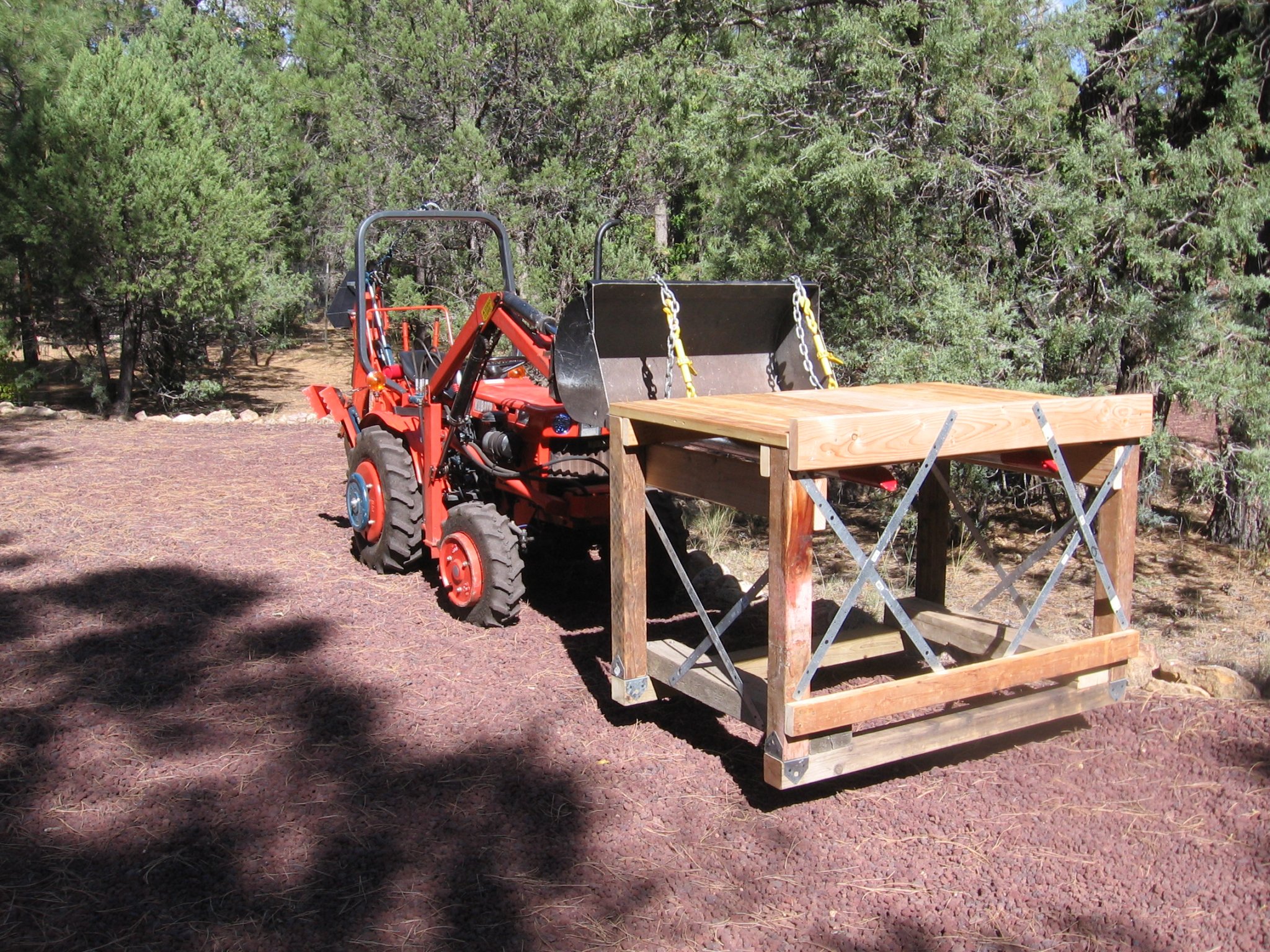

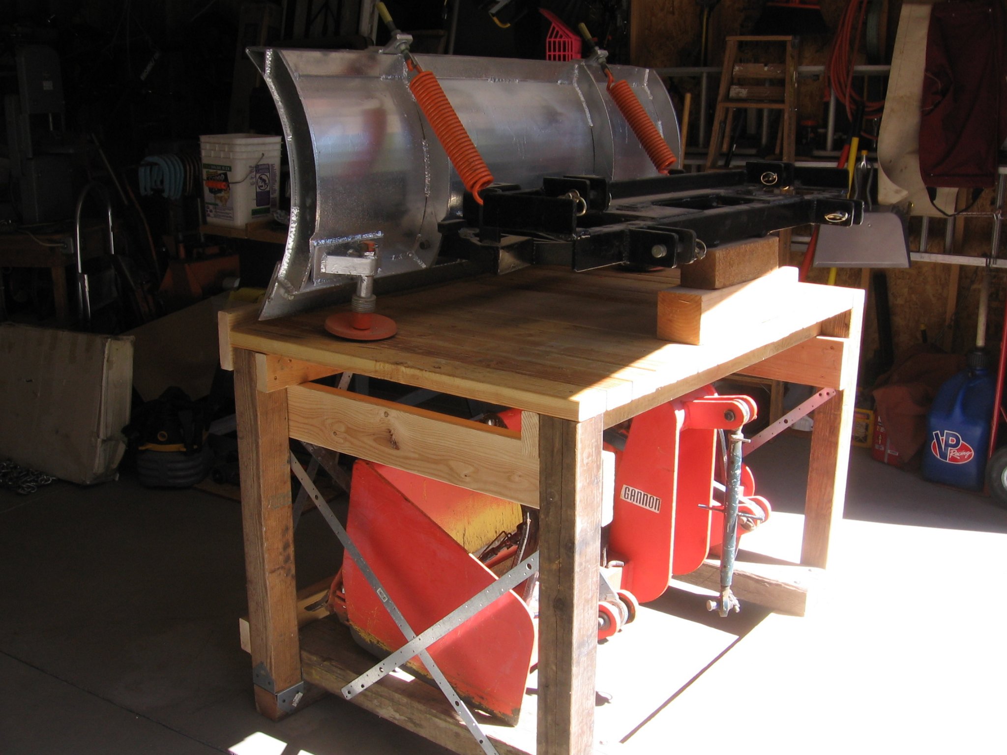

I built this implement stand out of stuff I had laying around, works great for consolidating implement storage in the container. It currently holds my box blade, 5' plow, forks, and some other stuff.

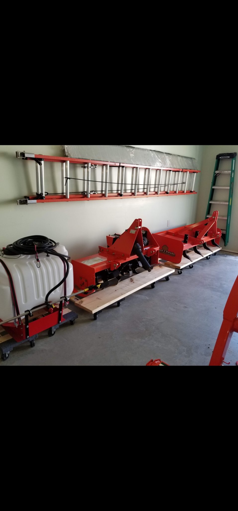

Harbor Freight dollies.
Would love to go the dolly route but things will be stored outside for a while..........if/when I build another auxiliary garage/shed/barn with a floor I will go the rolling dolly route.......baby steps....

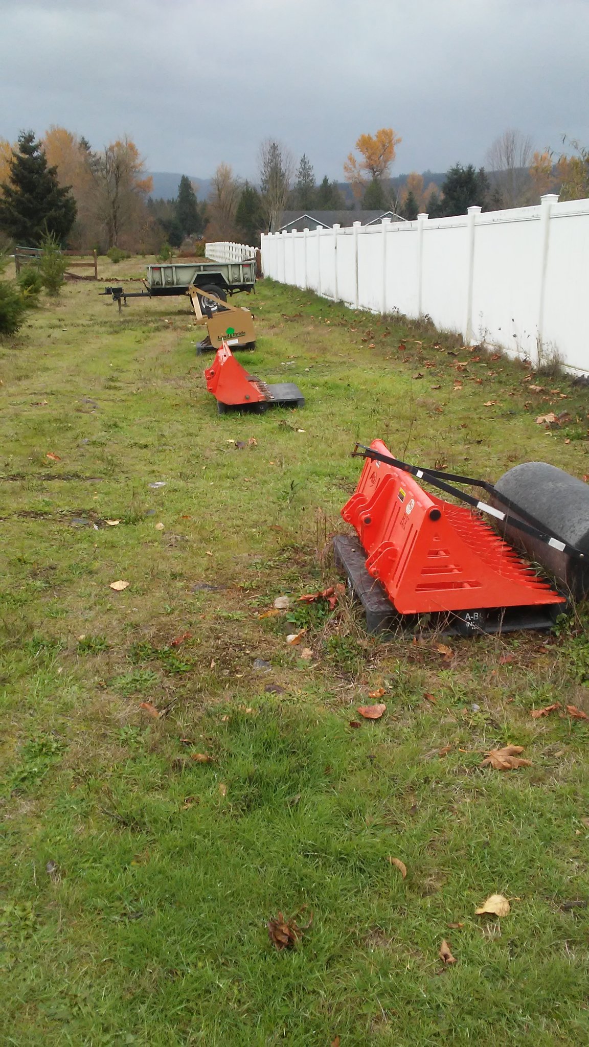

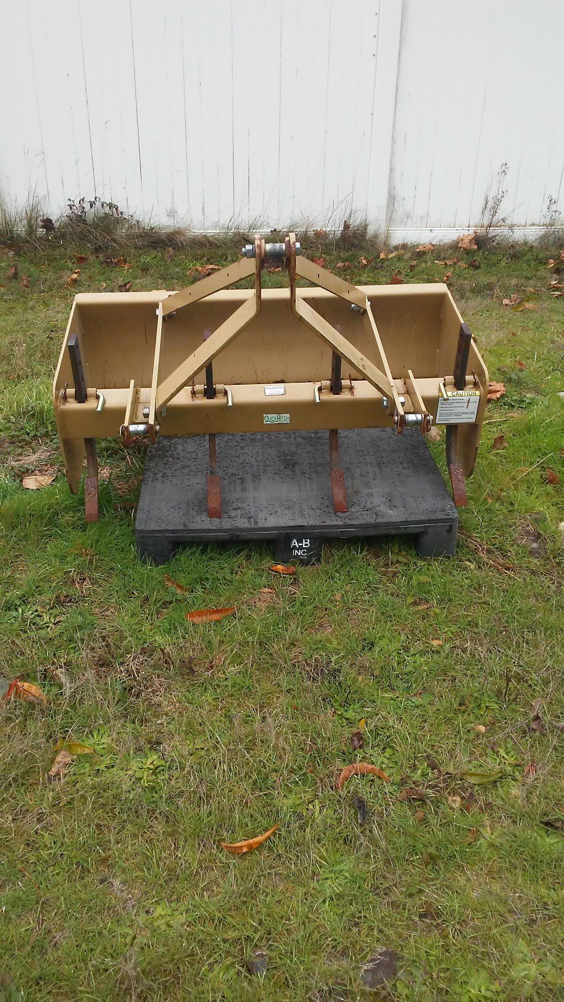

I store mine on a pallet, the same as I do for each of my buckets. The box blade weighs 382 pounds but the pallet handles the weight without problems. The buckets each weigh less than 100 pounds so not a problem there either. I rescued those pallets from a dumpster at work several years ago.

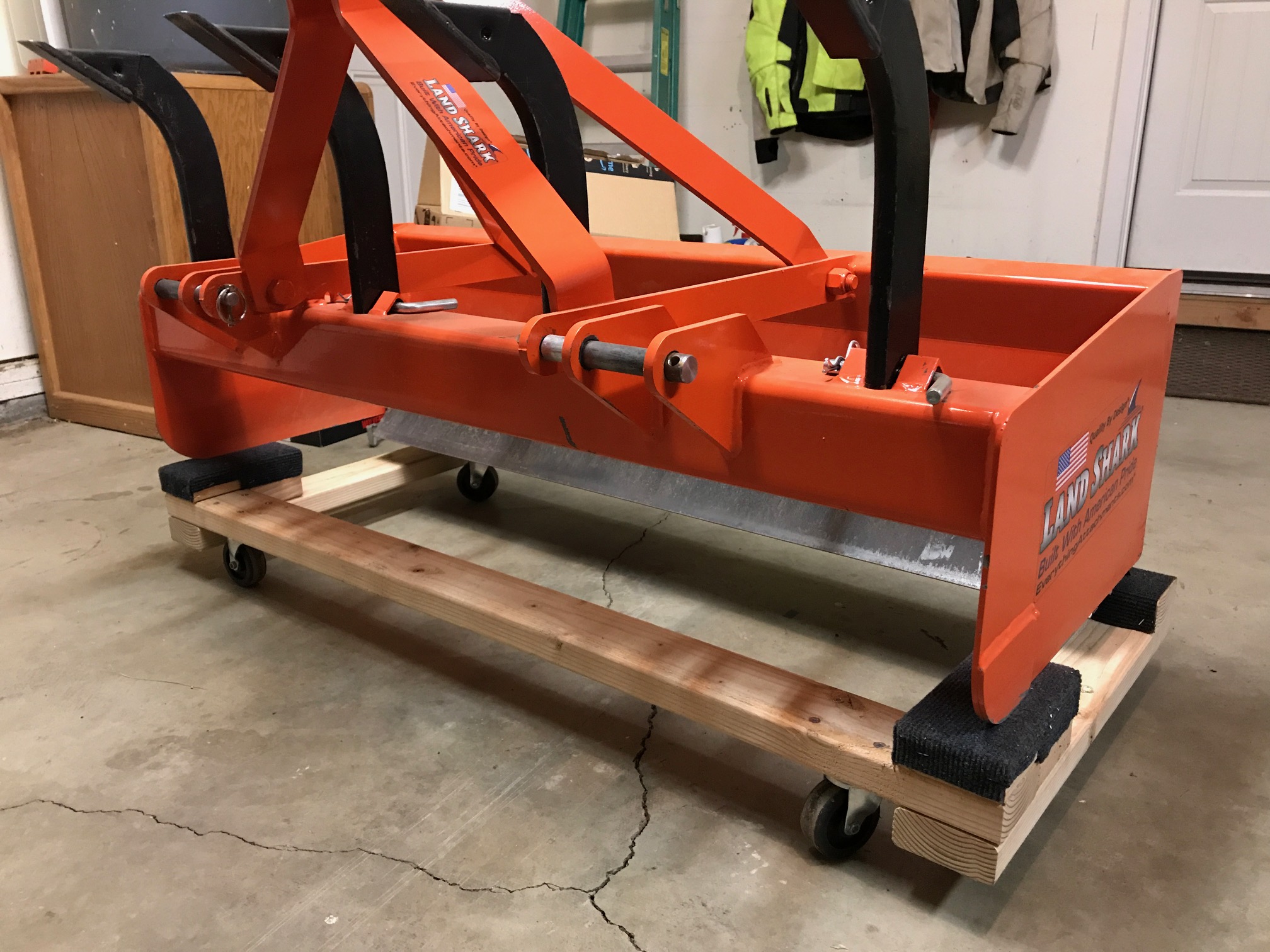

i purchased a couple of 2x4's and the cheapest Harbor Freight furniture dolly and removed the casters (this was cheaper than buying them individually and they have the weight rating) I also used the carpet that came attached and used it so the Box blade will not slide around while it's dolly. Makes it real easy to roll around and maneuver. It cost about $15 and few hours.
